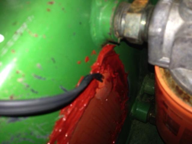

That silicone heater doesn't look like much, but let me tell you its the cats ***. All you need is one of those heaters. It is a 250 watt heater. I was using 2 KAT 400 watt magnetic heaters, with battery charger, with a make shift tent, with a propane forced air heater under the tent just to get it started.
If you buy one, follow directions for installation. Make sure you prep the area you are sticking it on. Use RTV silicone around the edges. you will wish you had it years ago.

The pad is in the inside of the tub. Not sure why you wouldn't want it on there all the time if it going start your machine with out all the hassle in the winter.

We used to install airplane engine heaters very similar to this 25+ years ago. They stayed on all the time. Inside the tub would be safe and sound... and convenient.

I have had to change the coils on my 422, and I know the pad does not take up a lot of room but I needed every bit of room there is in the tub to change the coils. My 422 has pump in front of motor
