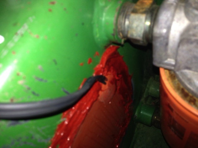

I finally installed the new KAT silicone heater yesterday. I had it plugged in for 4 hours. Started right up at 38 degrees in the barn. Real test will be on tuesday. Temps are supposed to be in the teens.

I was using 2 KAT 300 watt Magnum heaters. You really couldn't feel the warmth on the metal. A half hour of the this KAT silicone heater and can feel the metal all around the heater really warming up. Again the real teat when the temps are in the 20s and below. Very optimistic from what I have seen today.

What wattage heater did you (250 watt or the 500 watt) get? Where did you locate it, any pix?

It is the KAT 24250 silicone heater. I found it on Amazon. I believe it is a 250 watt. Image.jpg

Frank,
Thank you for the picture. Anxious to hear your results in colder weather. Interested in how long you have to keep plugged in to see the positive effects

30 degrees in the barn this morning. Plugged in last night at 11pm. Started with no hesitation whatsoever. The metal all around the tank is warm to the touch. Terry was soooo right with this heater. Can't wait for the weather to get in the teens to try it. I know this is still early, IMO, if you have a PT 422 or 425 and she is cold starting, this is probably your best solution. In 30 degree weather last year, had to make a make shift tent in my barn with a tarp and put a propane heater under it for a hour, along with the two 300 watt KAt magnetic heaters.
