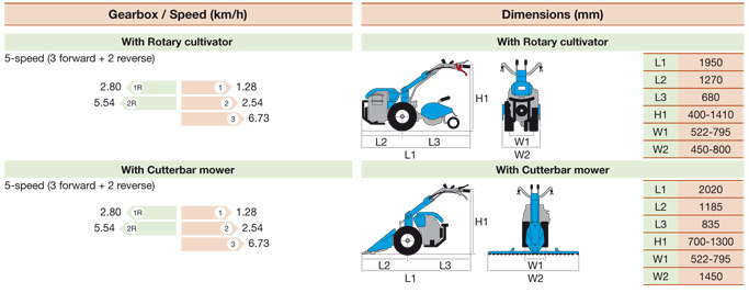

Hi!
I've attached a JPEG file with dimensions for a different 2-Wheeled Tractor (Bertolini 318 Shuttle). I need to know these dimensions for BCS 750 (Honda GX390). Thank you.
Best regards,
Alin Miron
