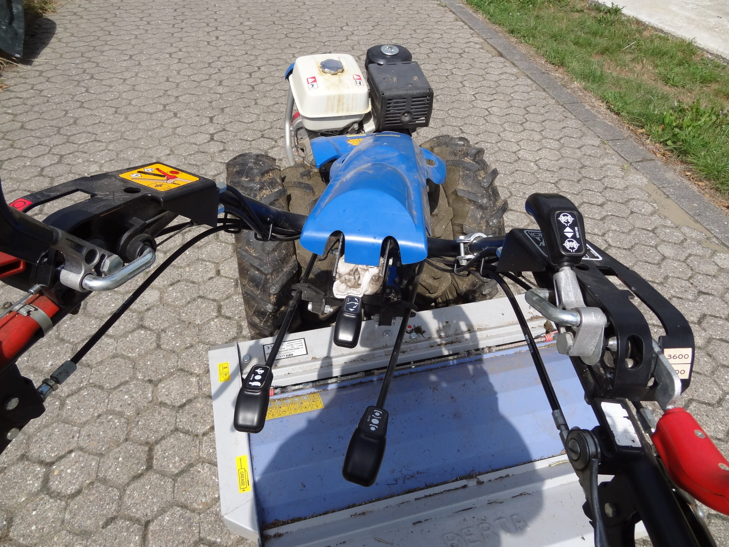

One of the topics that used to be frequently discussed, was the lack of a transport gear in the BCS PowerSafe models. Especially for members with a trailer or a sulky, this was a step in the wrong direction.
As all my 5 implements are used in the front-PTO mode, I have never missed a transport gear although I have one. This is unusual for a PowerSafe model I think, as it seems that it has been removed in all but the very first produced tractors.
My jobs are usually 5-20 km (3-12 miles) from home, so I load my tractor onto a trailer and tow it to the job behind my car. Recently I had a job, where 2 plots were like 10-15 minutes walking distance apart along a forest road. I drove in 3rd gear with like 3/4 throttle, witch fits the walking speed of my old legs (3.9 km/h or 2.4 mph) well. Then I was thinking of my transport gear, and if there was any chance to use it in such a situation, and perhaps run the engine at low idle in 4th gear instead.
For those of our members who are not familiar with the transport gear on a BCS tractor, it is useful to remember, that sadly does this gear not react to the position of the reverse-lever, but will always drive in one direction only! This direction is usually forward when the tractor is in the rear-PTO mode, which makes sense when the tractor is towing a trailer for instance.
I decided to try it out at home first, and the photo below shows my BCS 740 with the Berta flail mower attached, ready for the test. To get a little more space to walk, the handlebars are in the left-of-center position in the rear-PTO mode.
With the 23’’ wheels and the engine at low idle (1400 rpm), the tractor took off much faster than my old legs could follow (6 km/h or 3.7 mph)! It was an interesting test though - and quite fun to see the tractor run this fast, but I will stick to 3rd gear as my personal „transport gear“ in the future, as I have done for 11 years now.
For some of our younger members with faster legs, this might be an option if you have jobs within walking distance, and you have a tractor with a fast transport gear in the rear-PTO mode, but you use an implement in the front-PTO mode.
