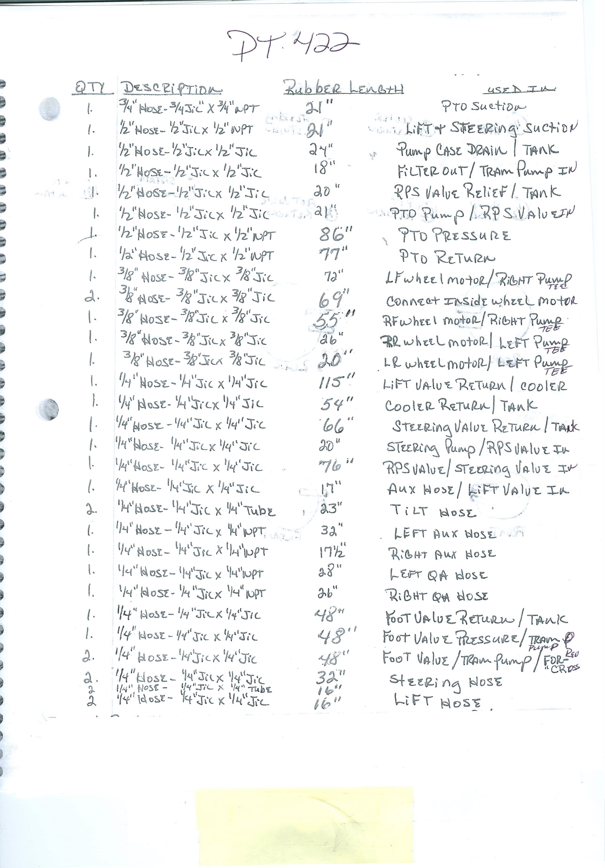

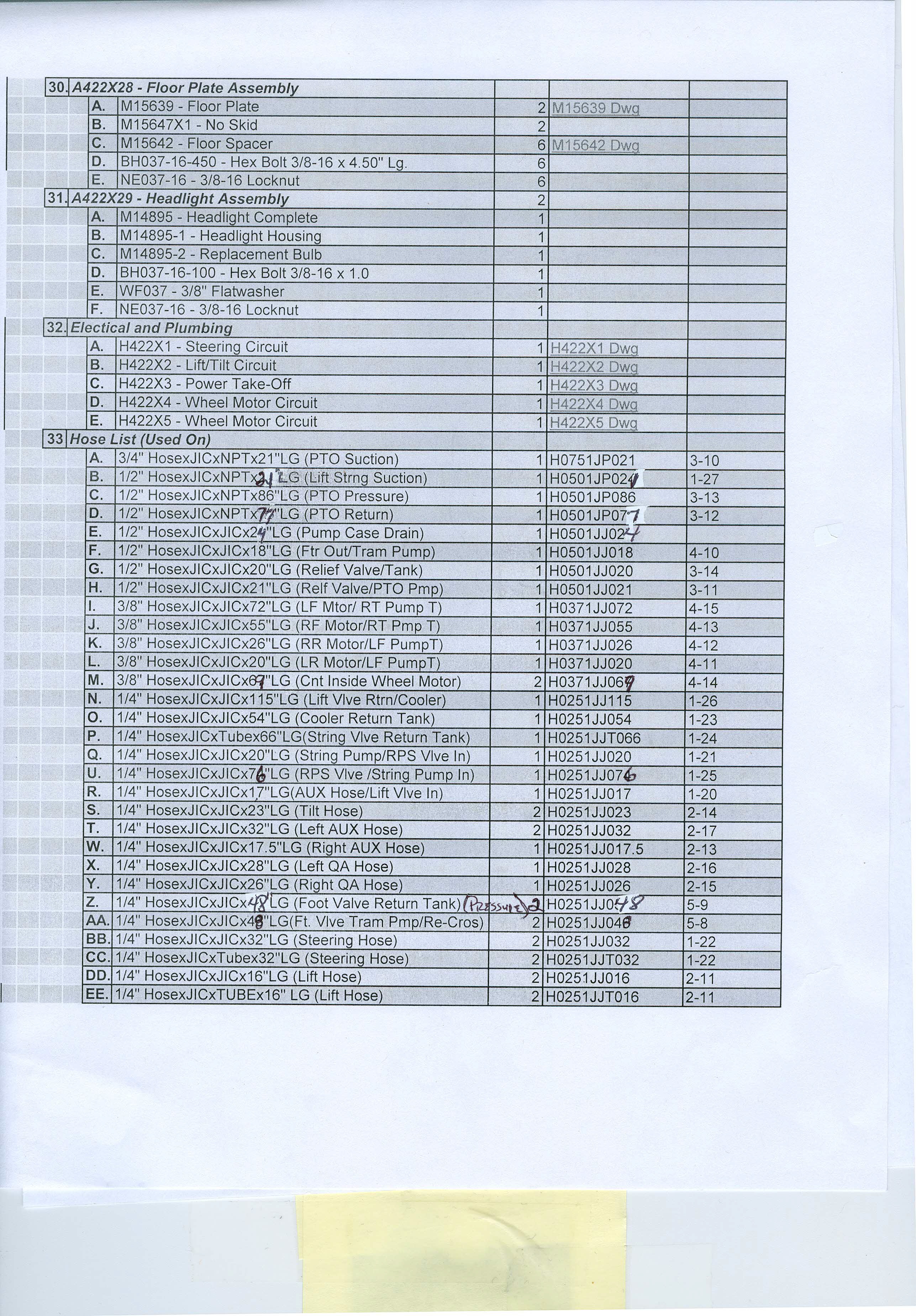

2004 PT422
Hydraulic hose list. Includes length where used and end types. curtesy of Terry from Power Trac

WOW! The holy grail of hose lists! :thumbsup:

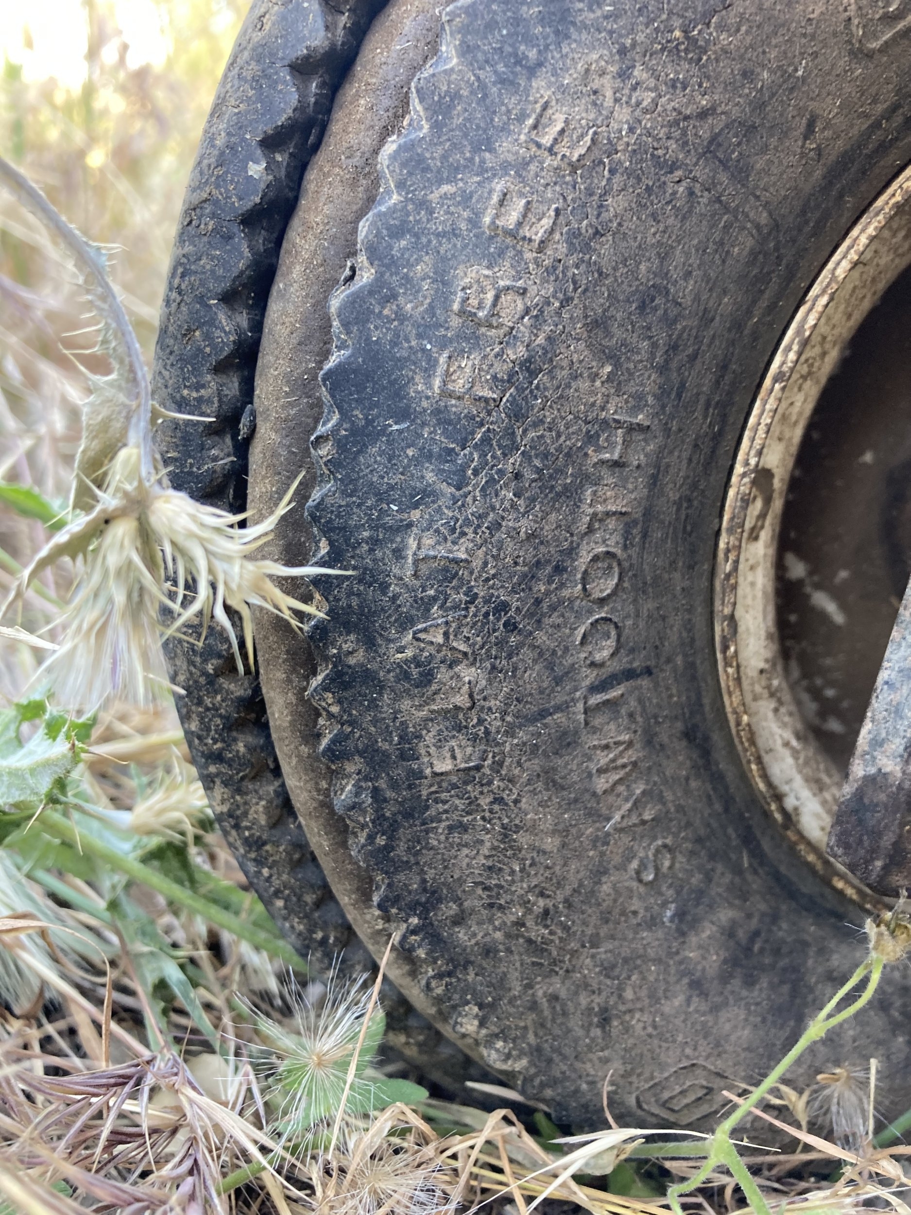

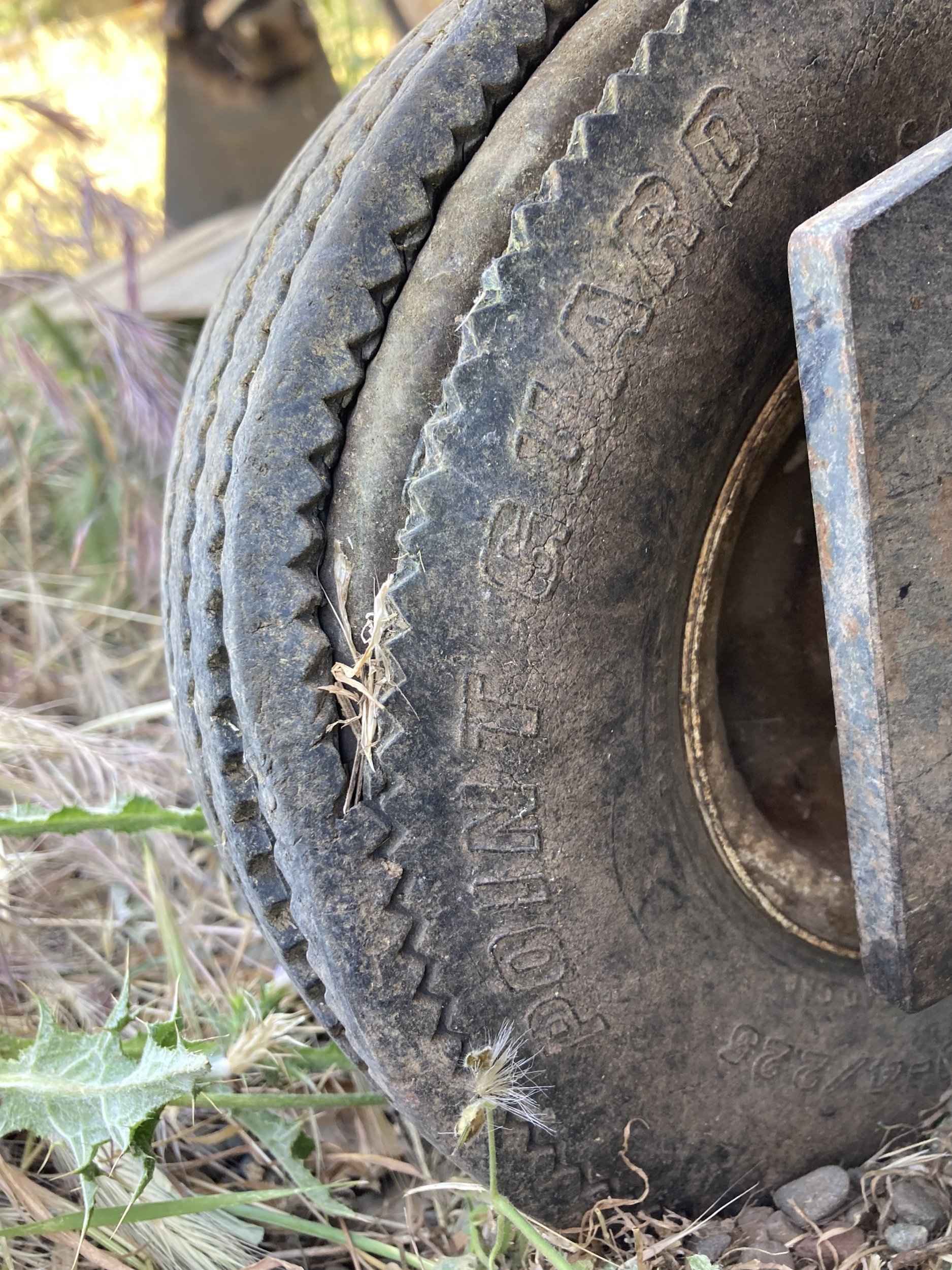

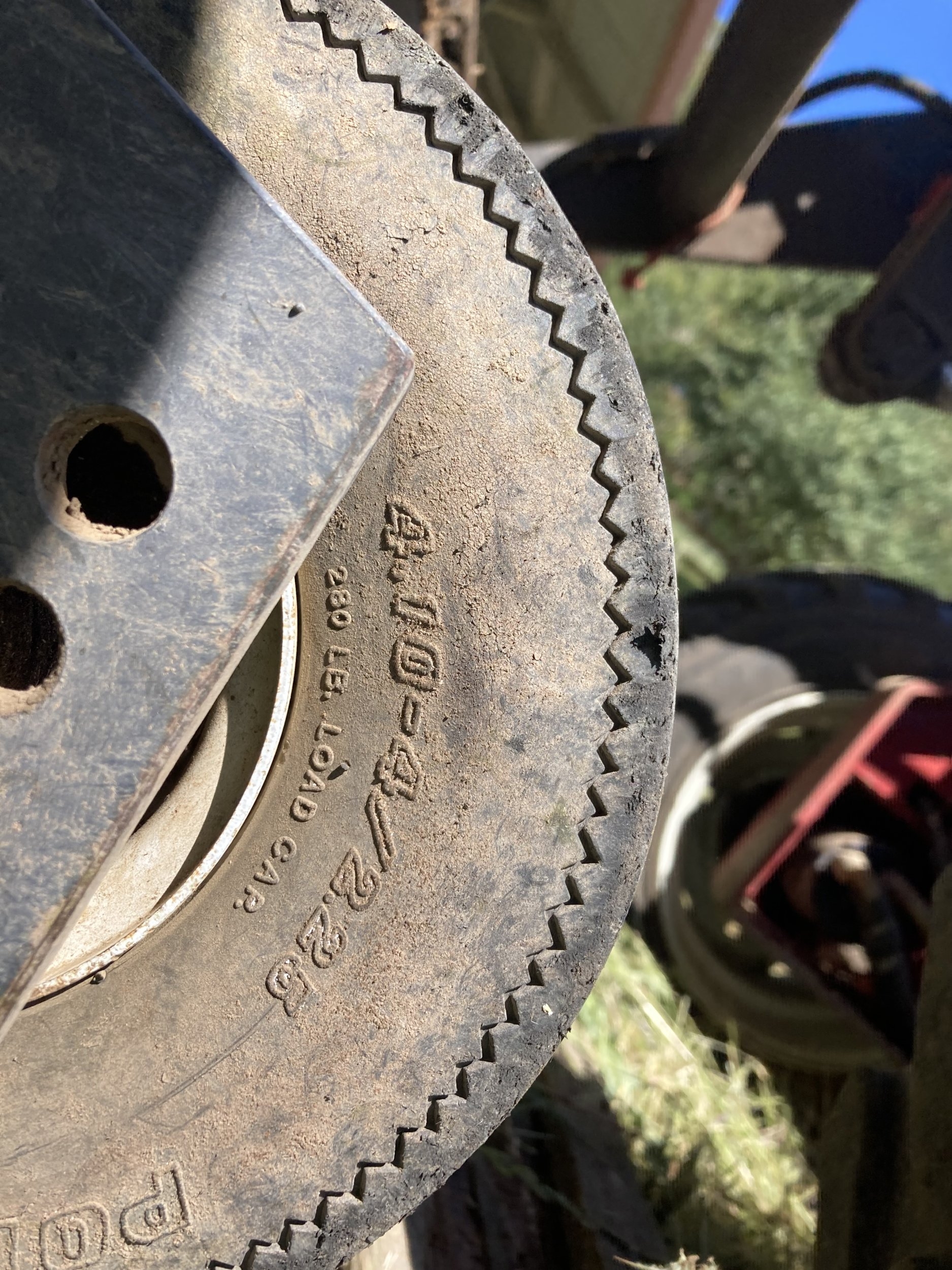

The 4.10-4 2.25 5/8 axle 4 inch hub run flat wheels on my brush mower delaminated after 17 years. Anyone have a source? I can't seem to find the Carlisle/Carstar version, and the Marathon versions have terrible online reviews.
I would be happy to try the laminated tire versions, but I don't know a good source.
Thanks!

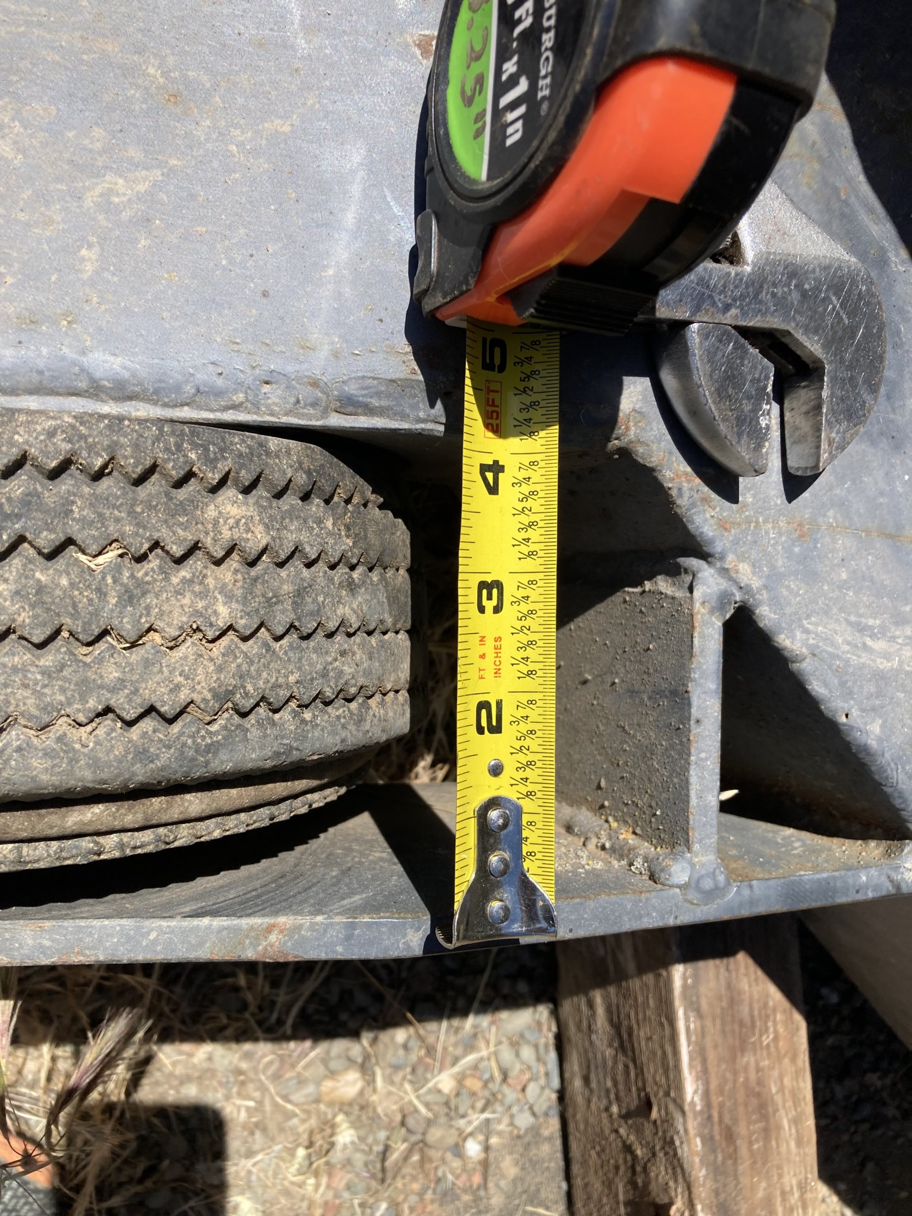

The sizes aren't stamped on my OEM rear brush cutter wheels, but I believe they are bigger than 4.10-4 which makes me wonder if PT has changed the cutter design since you bought yours? I'd be interested in comparing pictures. Already removed the OEM wheels to make measurements for fabricating a mount for larger wheels in this picture, but does your cutting deck look like mine at the rear?

Here you go!
4.10 run flats. They have been great for 17 years, but the writing is on the wall...
