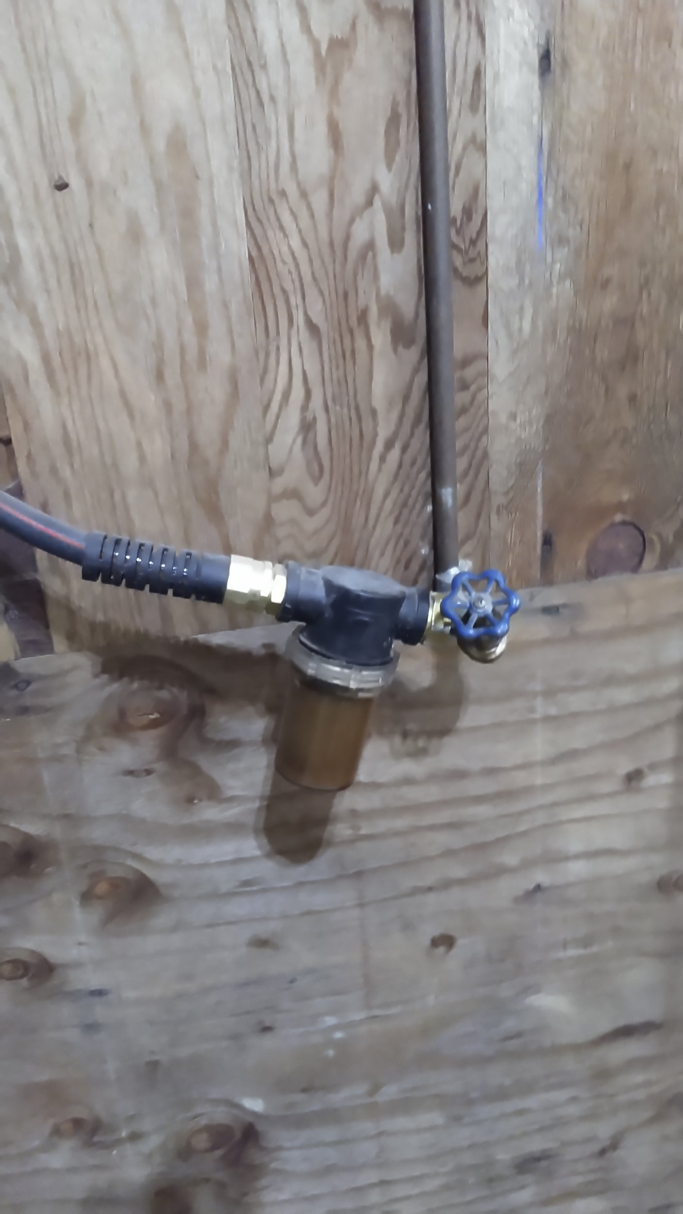

My final 2cents on pressure washers is using these filters in spigots where you hook it up, they arent pricey and seem to work good filtering sand and debris from well water in shop better than the screen on inlet of pressure washer. I also saved the initial bottle of pressure washer winterizer, and re fill it/use RV/marine antifreeze every fall it costs pennies vs buying a new bottle of (pressure washer antifreeze) every year.
