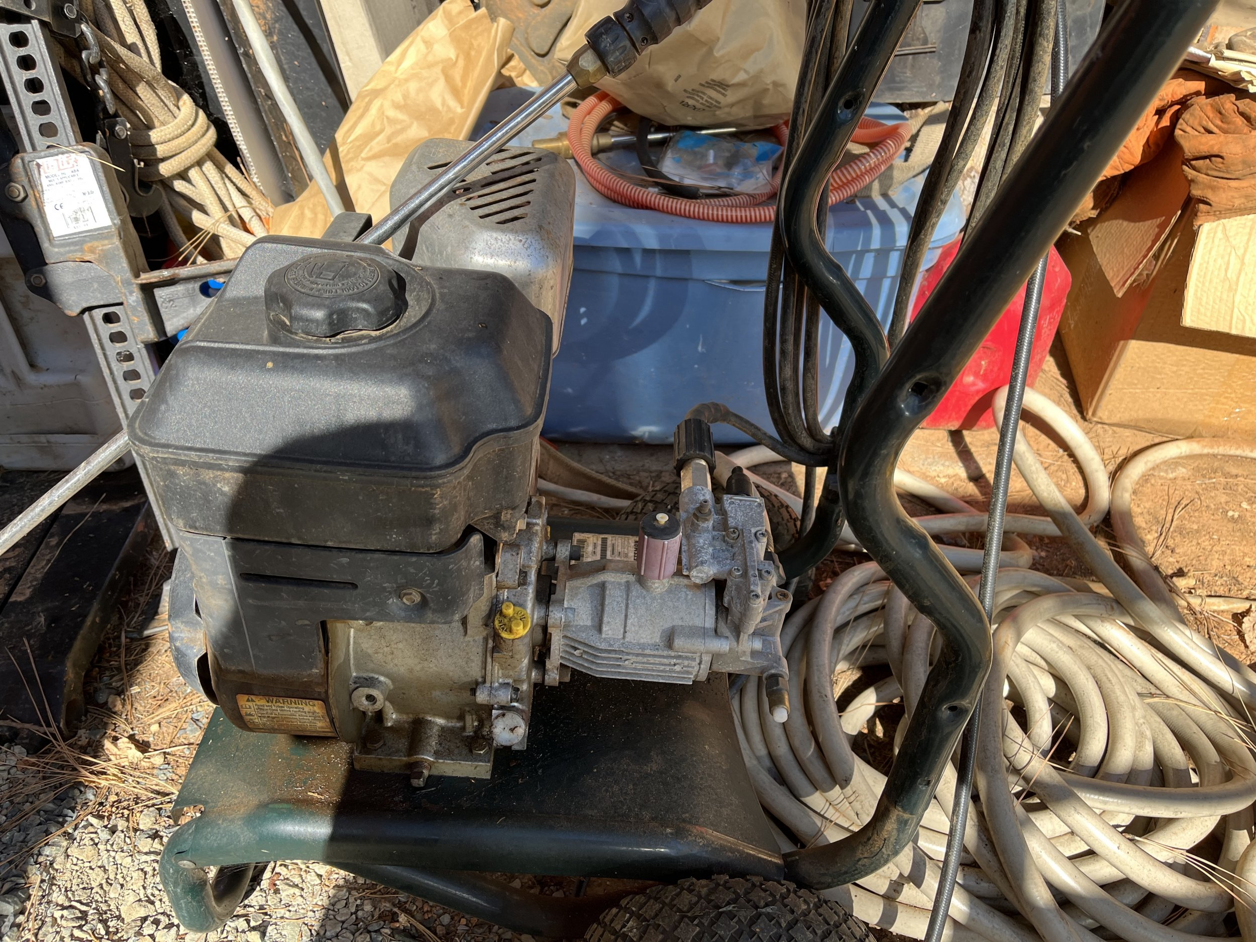

I know that you are looking for a new unit, but I just wanted to say that this old Sears Craftsman pressure washer with a Briggs and Stratton, given to me 10 years ago and at least 10 years old then. Needed the pump head rebuilt when I got it, but parts were easy to find. That alone made it a good thing.

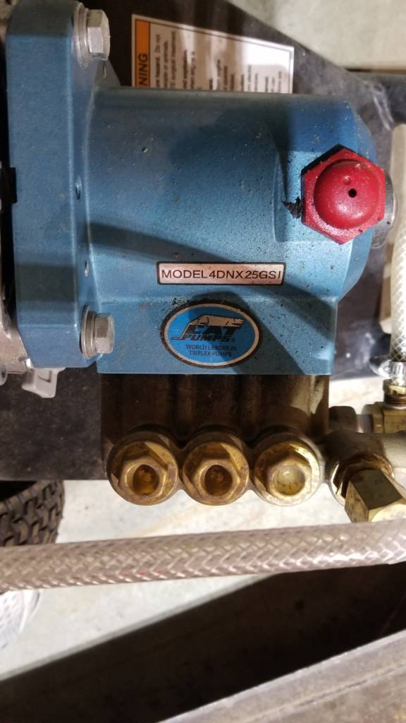

Bought a washer from Northern Tool, an M15781120F. 3. The salesman upsold me by $75 to a model that had a continuous duty cycle instead of 50%. Same Honda motor on both, but a better pump. 4 years and it starts on one pull. Picture of the pump attached. Probably close to $1000 since it was about $800 then.
