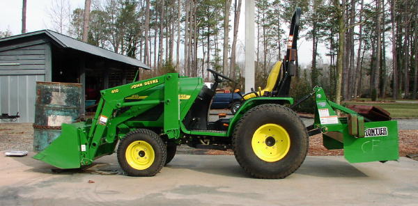

Hello all,
I have been following this for a while now, and just had to go out and do some trials on my 4110.
I have a 4110 with 410 loader, stock turfs, and a ballast box filled with 1-2 inch stone. (I don't know the weight)
1- Set front tire pressure to 22psi (per 4110 manual), filled the bucket with the biggest load of wet snow I could. (don't know the weight) resulst as follows...
Ballast box on-- steering is difficult when not moving, easy when moving.
Ballast box off-- Steering is very hard when not moving, easy when moving.
2. Increased front tire pressure to 26psi (per 410 loader manual) results as follows...
Ballast box on-- steering is easy all of the time.
Ballast box off-- Steering is moderate when not moving(by moderate I mean I cant steer with 1 finger, but effort is still pretty light, and while moving steering is easy.
I am not trying to present any conclusions, but rather I am presenting my experience with my 4110 with approx 60 hours on it. I am also running the low viscosity HY-Gard oil.
I dont think it will matter, but the tests were done in approx. 35 deg. weather.
