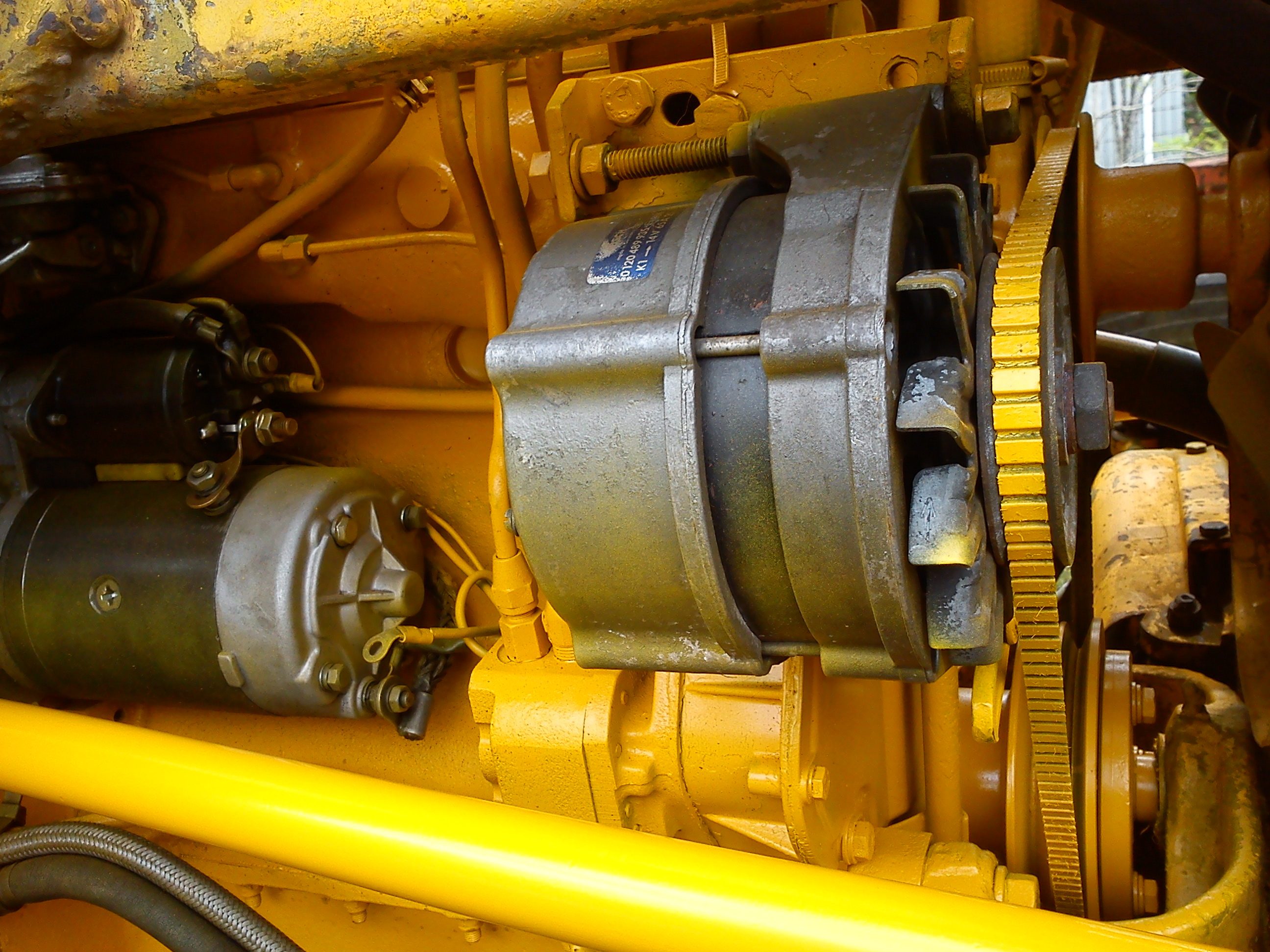

Here's a pic of the RH side of my loader's engine, straight after I reconditioned it and reassembled the tractor about three years ago - the other reason I want to ensure not too much P/S oil mixes with the engine oil. Does your PwrStrg pump look similar and the reservoir is forward of the radiator, or does it have it's reservoir built onto it? It looks quite dis-proportionate because of the camera angle, but you can see it clearly below the alternator.
I must add ..... that engine - indeed the whole machine - has done considerable work since that pic was taken, with zero reliability issues, and now doesn't look quite as pretty. :laughing: I can only say though, this is how tough and reliable they used to build MFs, :thumbsup: and that's how all tractors should be built. :drink:
