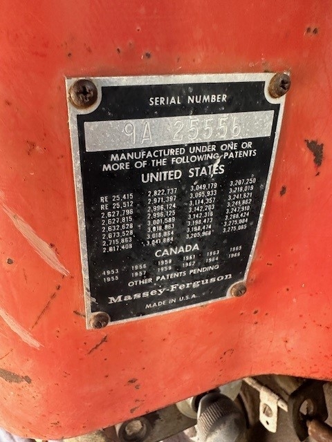

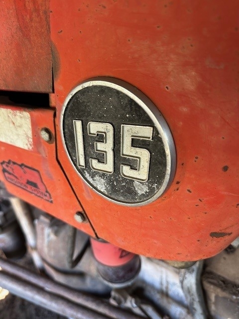

I have a MF 135. see pics for name plate on the tractor. I was told it has "assisted power steering?" Any way, a mechanic told me this. I think it needs some more hydraulic fluid for the assist. I have an owner's manual, but I can not find the location of the fill port. I looked at the front of the tractor for a fluid reservoir, but i don't see a pump at the front of the tractor. does anyone know where you fill the reservoir? thanks, Carr

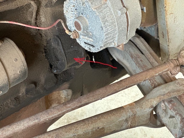

If it's a three cylinder Perkins engine the 135 steering pump is on the right side of the engine down low. It looks like this. The fill/level plug is on the can. If it's not there, then you "assisted power steering' is your two strong arms.

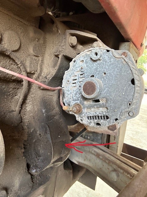

here is the right side of engine picture. I don't know what the purpose is of the piece that the arrow is pointing to. thanks, Carr

That's a cover. That hole being covered is where the factory power steering pump would mount. (if it had one)

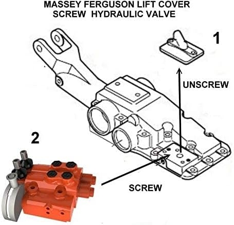

If it has an aftermarket power steering kit installed, it gets hyd fluid/power from a replacement plate at right front corner of the top of the transmission.
/ MF 135 POWER STEERING #7
Where did that information come from? Who supplies that kit?
/ MF 135 POWER STEERING #9
Just exactly what is that? You're claiming this is part of some power steering kit?
