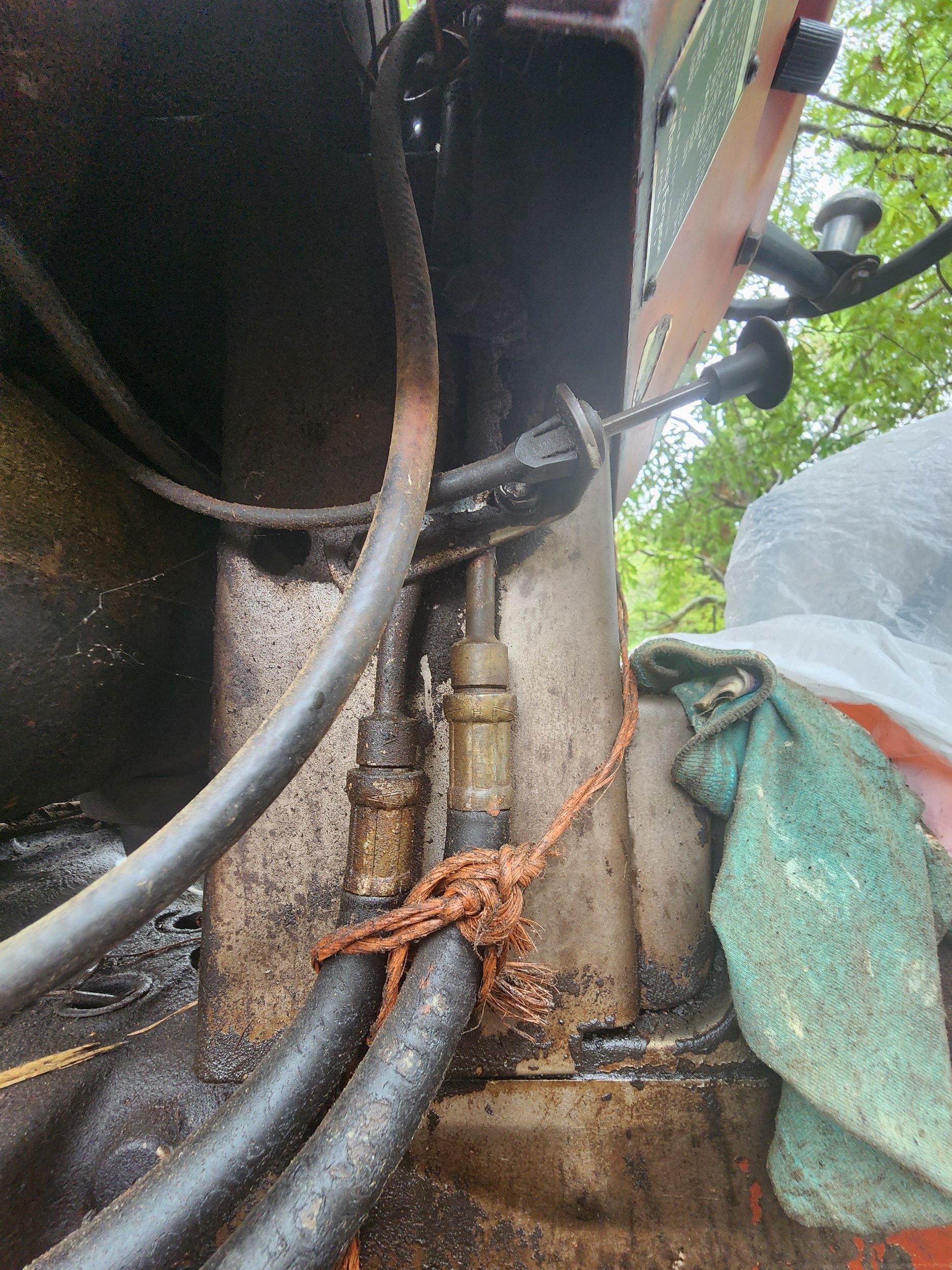

My power steering hose at the cylinder split yesterday. I'm unable to locate a replacement. When I search I only find hose for 231,240. Can someone help me locate replacement hydraulic hoses for a MF230?
I see that under the battery area I looks like the lines convert to metal going up into the steering wheel. Is this all part of the rubber line or does it split where the hard line starts?

Just pull it off and have a hose made
They can use a compression fitting on tube side
