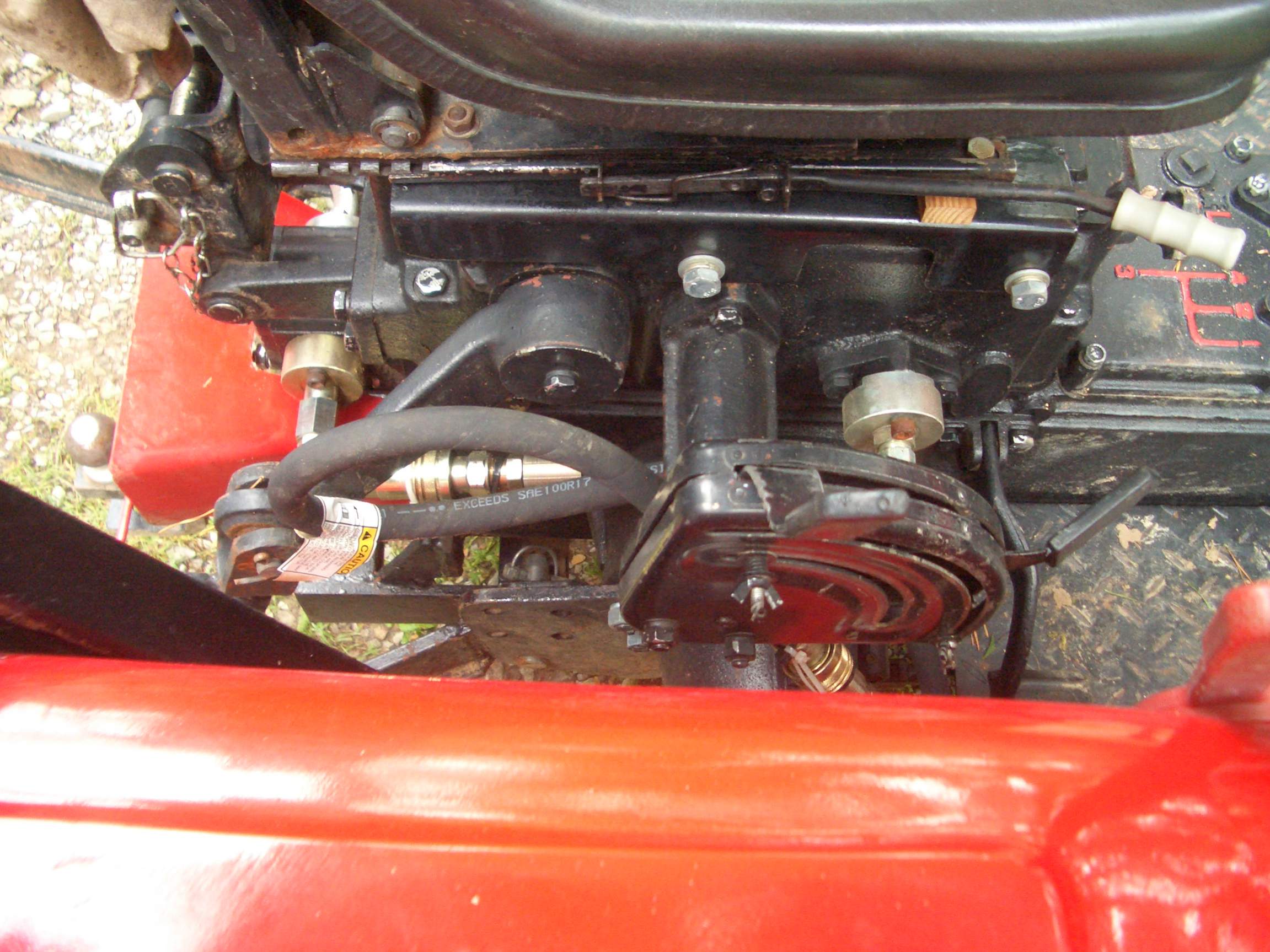

Does anyone know what kind of fitting is on the end of the power steering outlet hose on a Jinma 354? This is the hose I'm talking about:
Outlet pipe II
One end has a 90-degree male threaded pipe that goes into a banjo fitting on the priority valve. It's the other end I'm interested in. It's a female threaded fitting, I don't know how to ID it.
Alternately, does anyone know the diameter of that hose?
The background: I want to add remote hydraulics to my tractor. I need a hydraulic return line for that. My hydraulic tank only has one opening, which is the return pipe from the power steering. That's a hard pipe and I don't feel like cutting it. At the tank there's no possibility of teeing in because the connection is right behind the 3-point hitch control. The other end is at the priority valve and there is no room to tee because the FEL bracket is right up against it. The return from the power steering is a hose running from the steering box to the priority valve. It seems my best bets are either to put a tee between the steering box and the hose, or to cut the hose and put in a barbed tee.
To put a tee on the end of the hose I need to know what kind of fitting it is. To cut the hose i need to know the hose diameter.
Any advice is appreciated.
Thanks.

Thanks Tommy.
I did some quick googling on ORFS metric fittings and what I learned was enough to scare me away. So now I'm thinking I have three options: cut and tee into the hose between the steering box the priority valve, cut and tee into the pipe between the priority valve and the hydraulic tank, or drill and tap into the hydraulic tank.
None of the three seem particularly easy. Anybody have any thoughts?

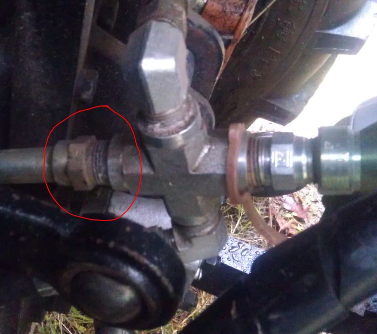

I added rear and front remotes to my Jinma 284. Attached is a photo of the drain. I put an NPT cross on the existing return line. It was already NPT so I just added more off the shelf connections.

Mine must have been made while they were switching from right side to left side... there just isn't a drain plug.
In fairness, the parts manual shows a plug on the right rear bottom, like EE_Bota describes. However, that hole is now taken by a banjo bolt with the return from the power steering.
So I'm back to either cutting the steering return hose, cutting the steering return pipe, somehow branching one of the end fittings, or drilling and tapping the tank. The problem with cutting the hose or the pipe is I'm not sure where to get appropriate fittings. The pipe has an OD of 14mm. The hose is labeled 1-10-16, which I gather implies that it is a single-ply 10mm hose rated to 16mPa (2200 PSI).
Any thoughts? I might ask in the hydraulics forum.
