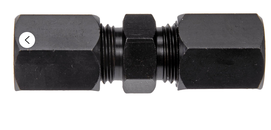

My TC30 sprung a power steering fluid leak from one of the metal pipes circled in the pic. (It got crimped by one of the arms holding the body cover).
Can I cut out the broken section and replace it with a piece of hose? Or do I need to replace the whole pipe? How should I go about this?

The 2 lines at the front (in your circle) are lines from the steering valve to the steering cylinder. The line slightly behind heading down at a 45 degree angle is the line from the pump to the steering valve. These 3 lines are all high pressure lines so any hose repair would need to be capable of handling the system pressure. I would first look for a used line from one of the used part sources. I suspect the tubing is metric, but you might try a hydraulic shop to see if repair fittings are available.
The only 1 of those 4 steering lines that does not see system pressure is the one not in your circle that turns and goes up to return to the reservoir.

Okay, thanks. So I guess a high pressure line can't be fixed and has to be replaced?
/ Tc30 power steering fluid leak #5
There was a thread here on fixing steel hydraulic lines via brazing etc.
I think it might be fixable but you’re going to have to make that call.
A hydraulic shop might be able make a replacement.

Thanks! Does anybody happen to know just what the psi is of the fluid going through the pipes?
/ Tc30 power steering fluid leak #8
The steering relief valve setting spec is 1420-1500psi on a T1520. I would expect a TC30 to be same or similar
The spec for my 1520 is 1420-1520 psi. These specs are from the New Holland service manuals.
