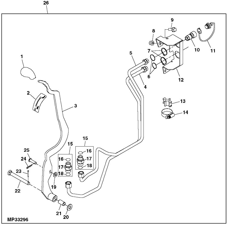

Deere 4310 eHydro
I have power beyond ports. Can I use these ports to plug into a bank (2) hydraulic valves? I would like to use one for my top link and one possibly for a grapple. Can someone give me a link of the valve I need? I assume I need a valve that if neither valve is selected it flows back to the tractor.

/ Power Beyond #5
CMH,
You know that you can add a factory remote to your machine right? Actually, you already have the valve(it's mated with the loader valve) but no way to control it. The JD kit sells for about $250 and includes everything you need...it's a nice clean setup.

How difficult is it to install?
/ Power Beyond #11
Will take about 4 hours or so, mostly it's just getting to everything due to the limited space is the problem. Removal of the right rear wheel is necessary, as well as cutting the slot in the right fender.
Below is a picture of what you get in the kit...LVB25569 is the part number for the newer unit's (need serial number to verify which kit you will need)
