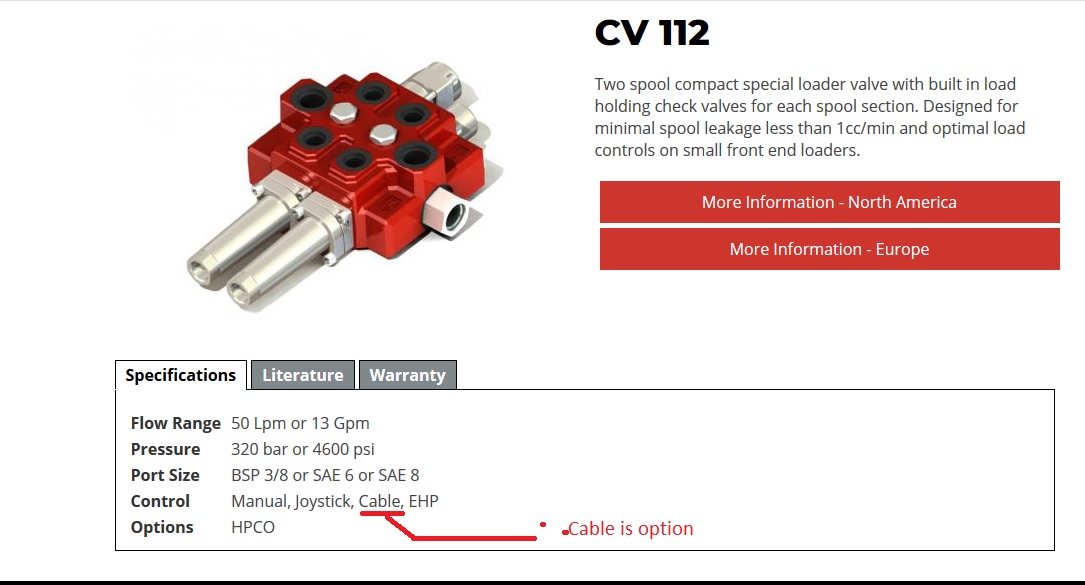

Look at this page from Nimco's site which shows the CV 112 is available as a cable control option.
Are you dealing with and getting advice from the Nimco head office tech people or just someone who sells their products?
Here is a page showing the cable control available for a number of Nimco CV valves including the CV 112.
The Nimco order forum which is also attached is the critical aspect of ending up with the valve you want.
Each box on the forum contains critical details which will make your loader operation a joy or drive you nuts.
I suggest you invest in a phone call and ask to speak to someone at Nimco Headquarters who can help you spec the exact valve you need.
Armed with the detailed order form info you can then go to whomever you are ordering the valve from and tell them exactly what you want ordered.
Local vendors do not have the knowledge of one brand's products to get you the best valve for your needs. They sell many different brands to a wide variety of customers and you do not want to rely on their knowledge too heavily.

Thanks again for the help Dave! I found that info and particular page (#15) last night, filled out all that I was sure of (including wire control) and sent it out. I have a confirmation page back from them this morning.
The person I've been e-mailing per this order is the same person whom I originally connected with and provided me the schematic for my original TYM valve #11087-2S. I've said "repeatedly" that I want the same spec's as TYM uses and since this company built the valve initially for TYM they should have access to that info already. The only item I was concerned about was the power beyond valve because I was unsure if my old one would transfer over - which I believe will - then I see it is listed in the last block on page 15! As an HPC-fitting (Power Beyond). I got slightly stumped when he asked 'me" for numbers about the valve. Guess I was using wrong terminology.
On page 15 the only things I didn't know for sure how to answer was the spool type - so I asked for what I have now Raise/Lower = DA + float so in Section 1 I put code 3X. For curl/dump in section 2 they only had DA + regen w/metering [I assume this is the quick dump function?] they listed 8R and 8S but both say the same thing so I have 8R in my copy of the sheet but in my e-mail I said whatever TYM used is what I wanted. I put in all that I knew of and feel okay with what I ordered, specifically since I asked several time to have whatever spec's TYM uses. It should be pretty much a plug and play event once the valve actually gets here.
What did through me off for a while was the Series CV112 valve reference - my current valve is listed as 11087-2S and that's what is in the bottom right hand side of the schematic I was sent when I asked if they could replace my valve. All these different #'s and specific hydraulic speech kinda make me dizzy getting through this! But I will chug my way through and get a new valve eventually. I'm getting closer each time. Greg
