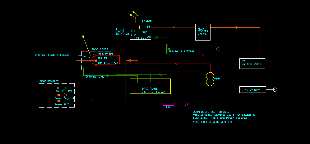

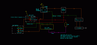

This is a corrected diagram of one I posted on another thread. For the Hydraulics experts.... does this look right?? This will go on an old John Deere 650 1982 vintage.

HERE IS A POWER BEYOND DRAWING ... YOURS GOING TO REAR REMOTES ..??
/ Power Beyond added Remotes JD650
I think that is the way I have it. Went out and traced existing, used John Deere install manuals I had for the loader and power steering install and kind of put it all together. My big surprise was needing 3 hose connections at the back. But I have learned a lot on this board. :) Thank You!!
