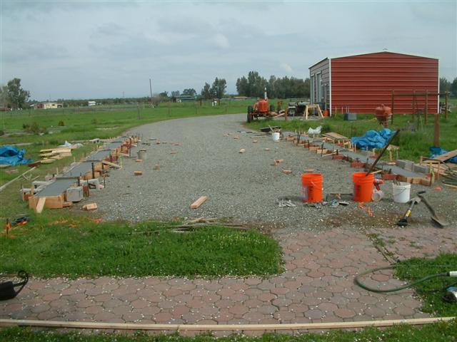

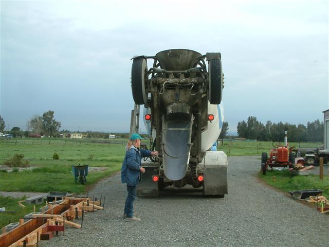

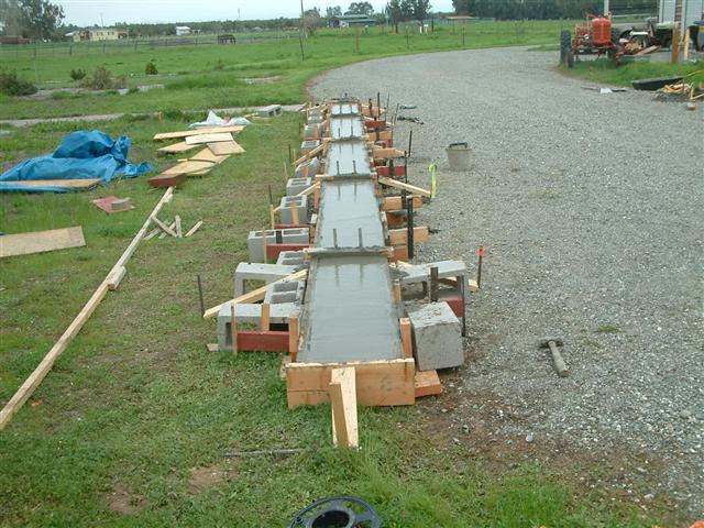

Shouldn't be a problem since its a footing mostly below ground and (I assume) there is still some rebar to pour around. Keep the surface of the concrete wet until you can get another load.
I ordered about 6.5 yards when I poured footings for my carport (72 ft x 12" wide x 18" deep (average). Had about 1/2 yard left over (made concrete weights from the excess).

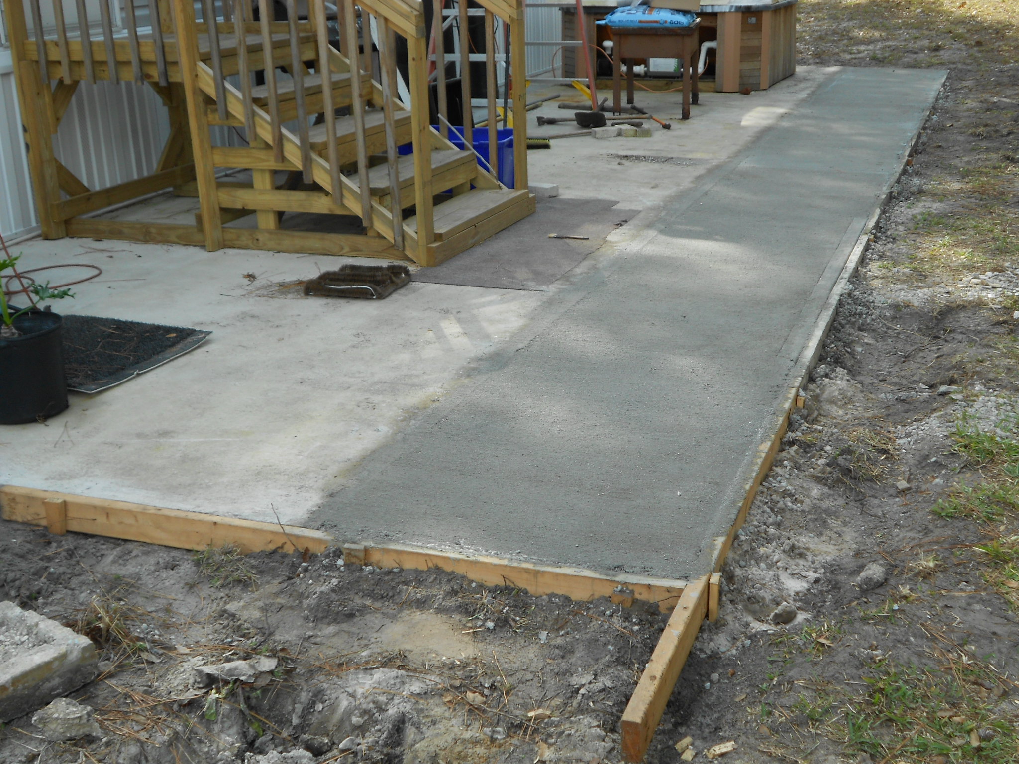

I've poured a lot of concrete and even drove the truck in the past. It is very easy to be off on depth measurements. I did a 40' X 65' slab and leveled it with a laser and it was off by 2 yards.
I poured a 3' X 36' extention on my patio last week, first pic.
In the second pic you can see a 4' X 8' slab next to the pour. I picked up that slab with my forklift and moved it out of the way and back to it's current location where I leveled and washed it back in. I poured that 4' X 8' slab 5 years ago with bag mix and a mixer. I didn't have enough and poured half one day and the other half the next. It is 2 x 4 depth and has no rebar or other reinforcement. I have driven one R-4 tire of my 3510 Branson over that slab numerous times and it still hasn't cracked! I think you will be OK.

View attachment 247042View attachment 247043View attachment 247044
Did you dig and dump in a trailer or truck. There is no evidence you even dug down for 18" depth. Nice clean pour.
