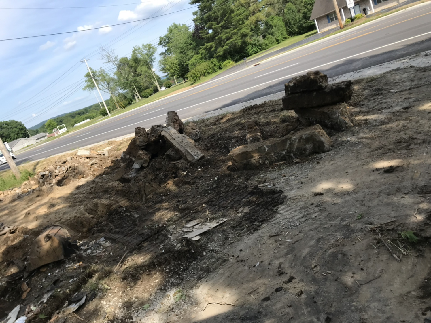

I pulled this one out of the ground in like an hour with my Kubota KX-040. Zero sawing, no hammer, zero manual labor. I can’t believe how much work you’re willing to go through to avoid getting the right tool.

I pulled this one out of the ground in like an hour with my Kubota KX-040. Zero sawing, no hammer, zero manual labor. I can’t believe how much work you’re willing to go through to avoid getting the right tool. View attachment 722022
Did you break it up by hitting the top or dig underneath and pull up? If things don't go as planned this weekend, I'll take this route. Do you think a 10k mini-excavator is the right size for a 12" deep x 24" wide footer?

I didn’t have any optimal sized rocks to drop and break it so I just dug under and pulled it out. As long as there’s no rebar they’re not that hard to break. My machine is around 10k. One size bigger would be optimal but it got the job done. I had to demo a sidewalk that had finished concrete on both sides. I paid a guy with another KX040 with a hammer to come chip that up and he made quick work of that as well. But I doubt you need a hammer unless there’s rebar or you want the footer in little easier to dispose of pieces.
