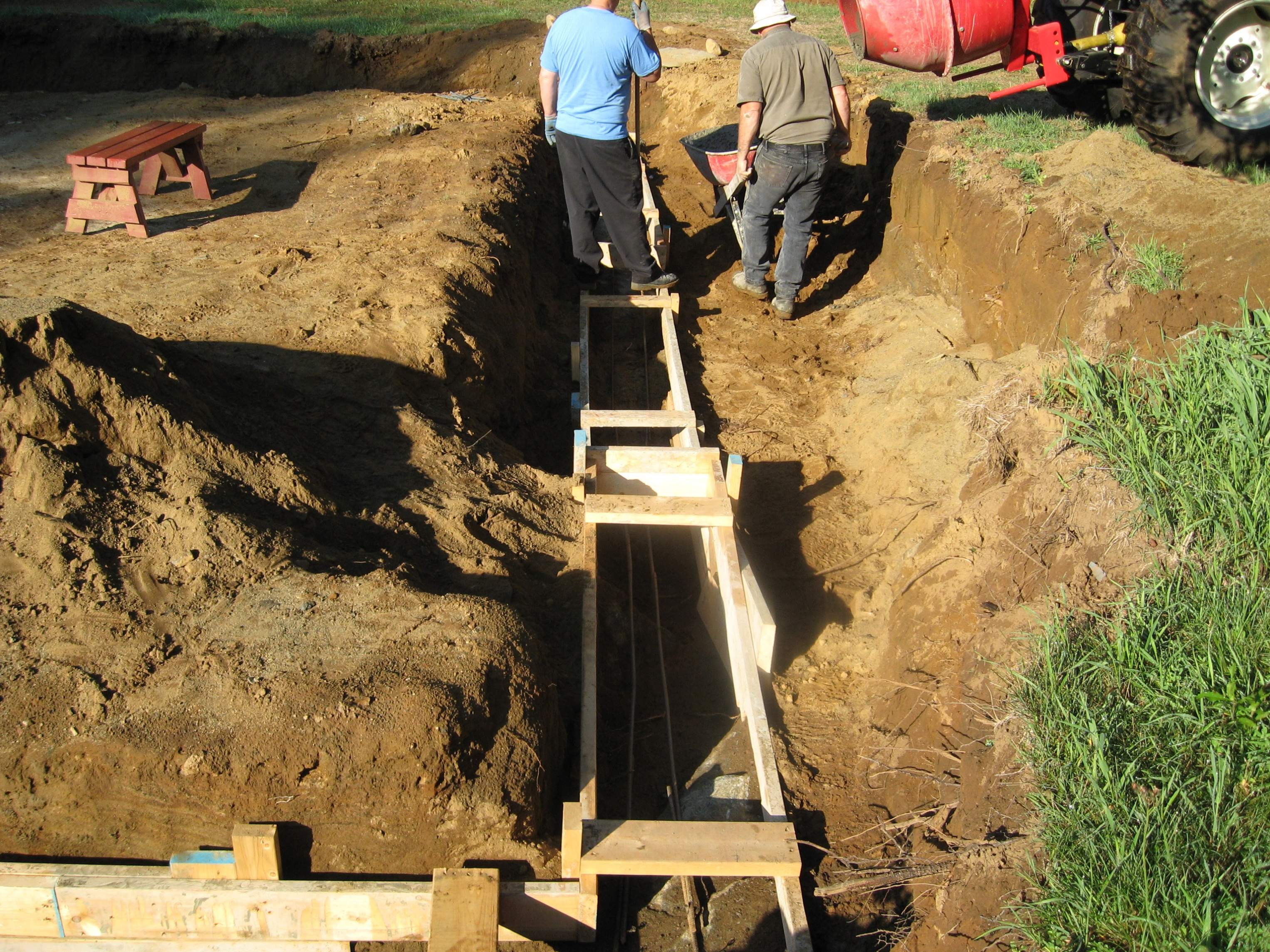

With my footing this past summer I chose to do my footing in sections. I first called in the building inspector to ask his opinions. I was down to rock and it was irregular which required steps and deep spots so to save my back and lumber in framing I did it in three sections. The inspector just said to tie in the spots with rebar. Rebar was cheap so I put it all the way through here are some pictures.

Did you dig and dump in a trailer or truck. There is no evidence you even dug down for 18" depth. Nice clean pour.
Just dug the footing trenches by hand. Filled the FEL bucket on my Mahindra 5525 and moved the load to the dump area on my place (I have 10 acres flat pasture). I always need fill dirt for this and that. I didn't want to hire the trenching done with a TLB since I didn't want the gravel driveway messed up. Took a few days to dig the trenches and set the forms, install rebar, etc.
The depth was 18" at the high point and about 24" at the low point on the footings (the driveway slopes down toward the road) so the average depth was somewhere between the two. IIRC, I used 22" depth to calculate the yards of concrete needed.
