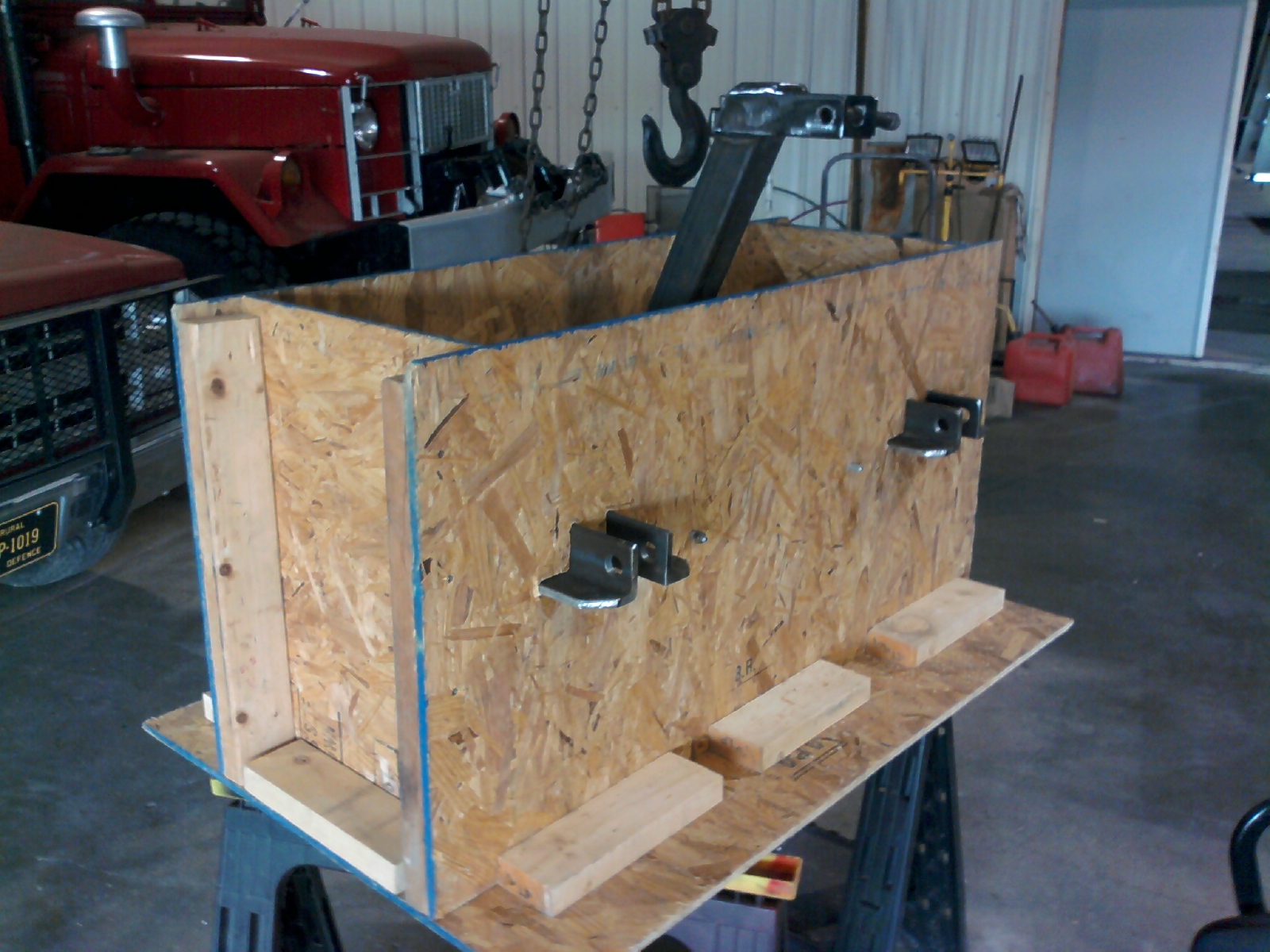

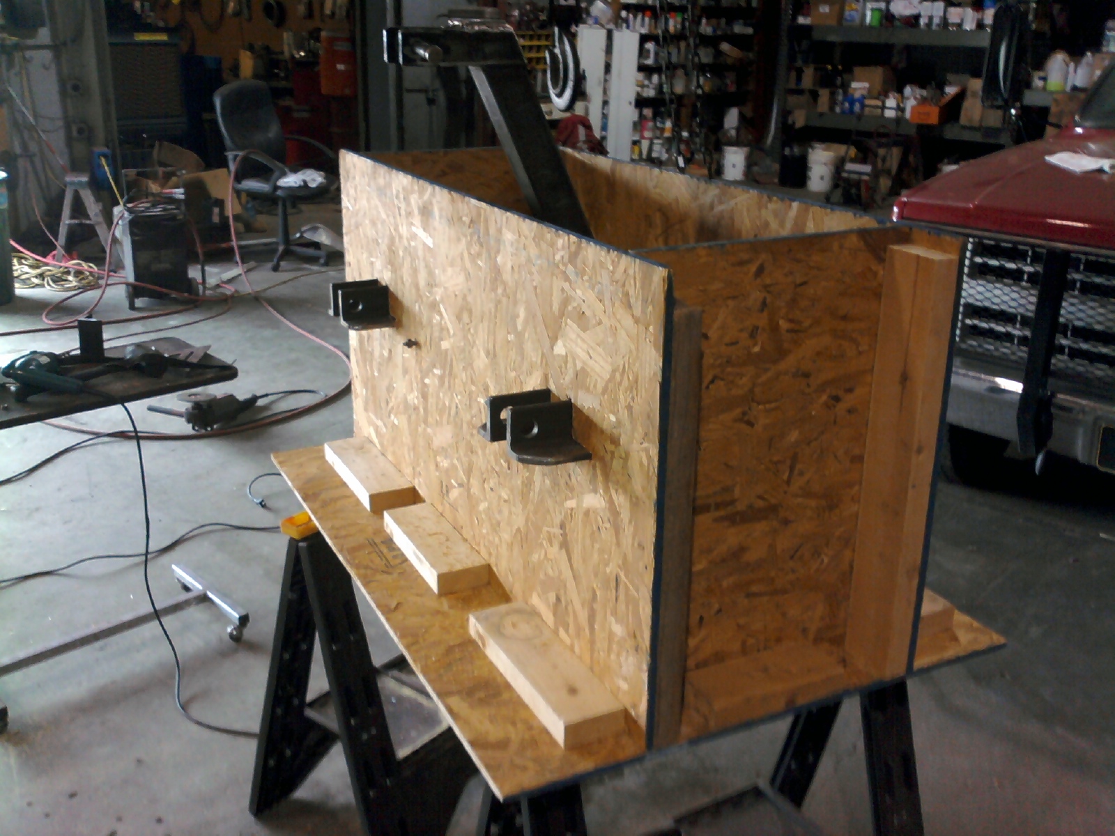

Well With all the talk about Ballast boxes it has gotten me into the mood to build mine finally. Not sure on final weight of the box yet, is the 150 lbs per square foot figure dried weight of concrete or wet?? The box is 40" wide , 24" tall, 16" deep. From my calculations I'm looking at approximately 8.89 cubic feet for a total of around 1330 plus the steel, Does this sound about right? Here are a few pics of what I have done so far. Still Have to add some wire and two pieces of PVC for holding shovels and rake handles.

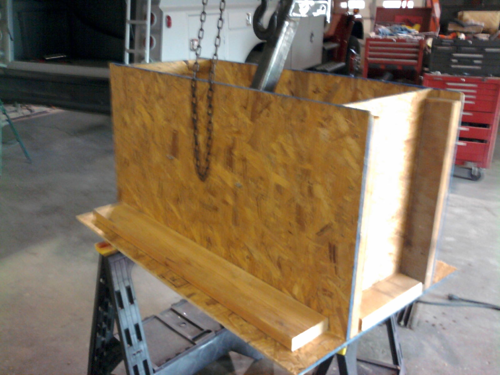

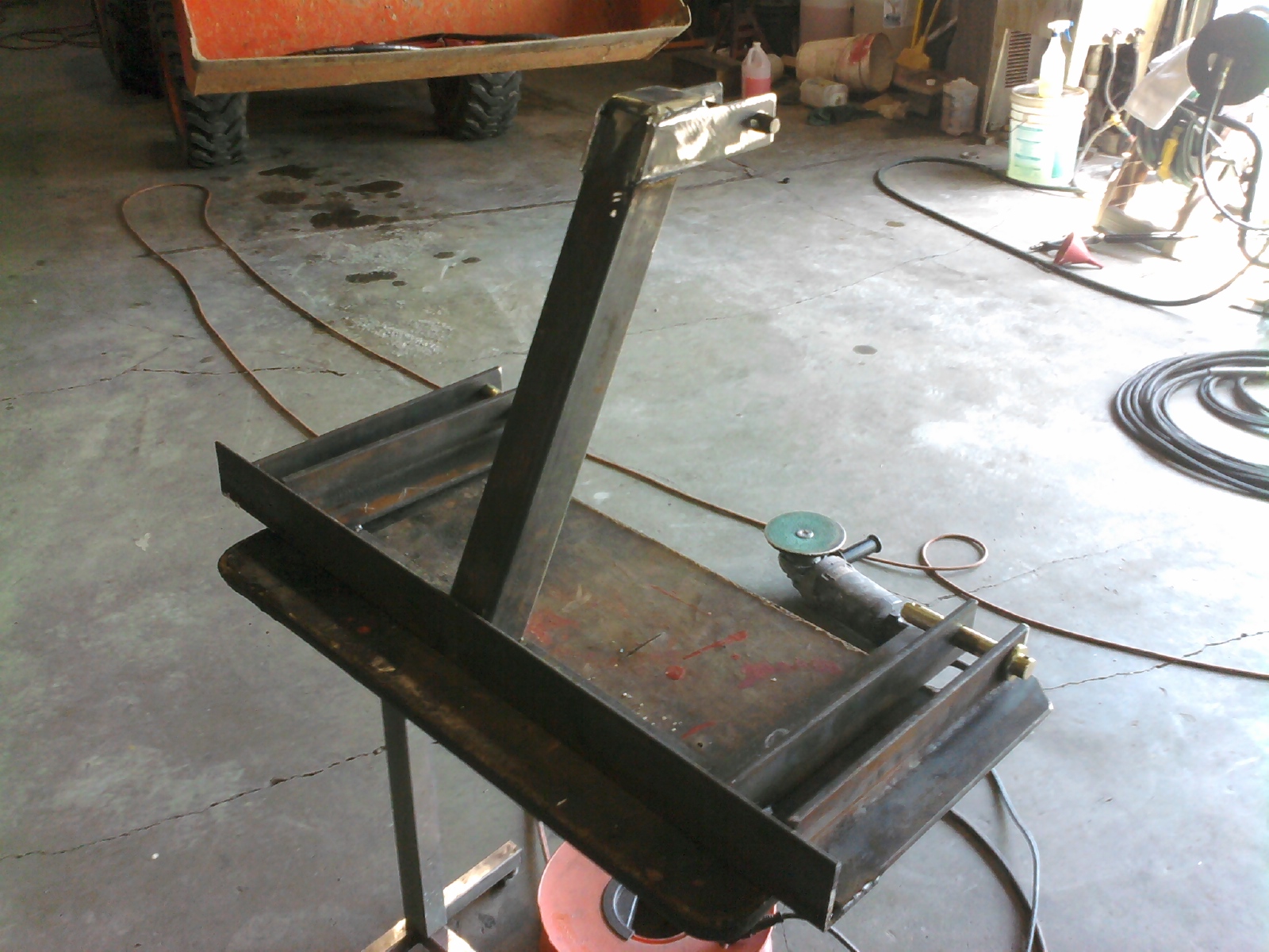

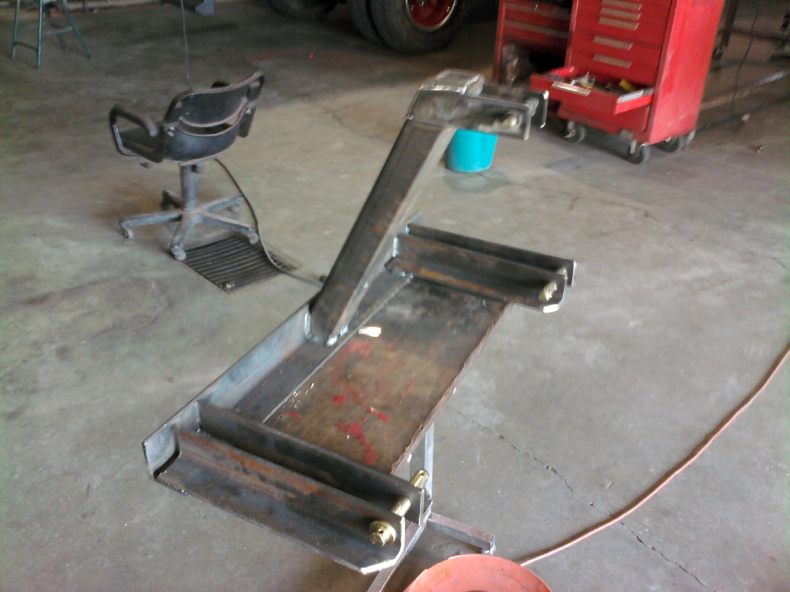

With the frame in the form.

The weight is almost the same for wet and dry, that's the interesting thing about cement based materials, it converts water into a solid form, the weight of the water is still in there.
Cement hydration
That's alot of weight, what size tractor? I used pvc pipe in mine, but I'd suggest steel, plastic can break easily if it's sticking out like mine. Mine are 30 inches long.
I'd weld some cross pcs on the top link tube, so it's not just relying on the weld but holding in the concrete.

Put some kind of a pin type hitch out the back. You just never know when you may need it and don't want to take the box off. Also put a chafer in the corners it will look so much nicer.

Thanks everyone, I'm going to be using it on a Kubota L3410. The hitch Idea has crossed my mind, along with the threaded inserts, I am planning on bending up some round rod and making hooks for holding a chain or rope or even buckets. I may look into placing something in the corners to round them. The hitch is placed 13" from the bottom of the box so I can easily set it on the ground and the QH will release without having to set it on something.

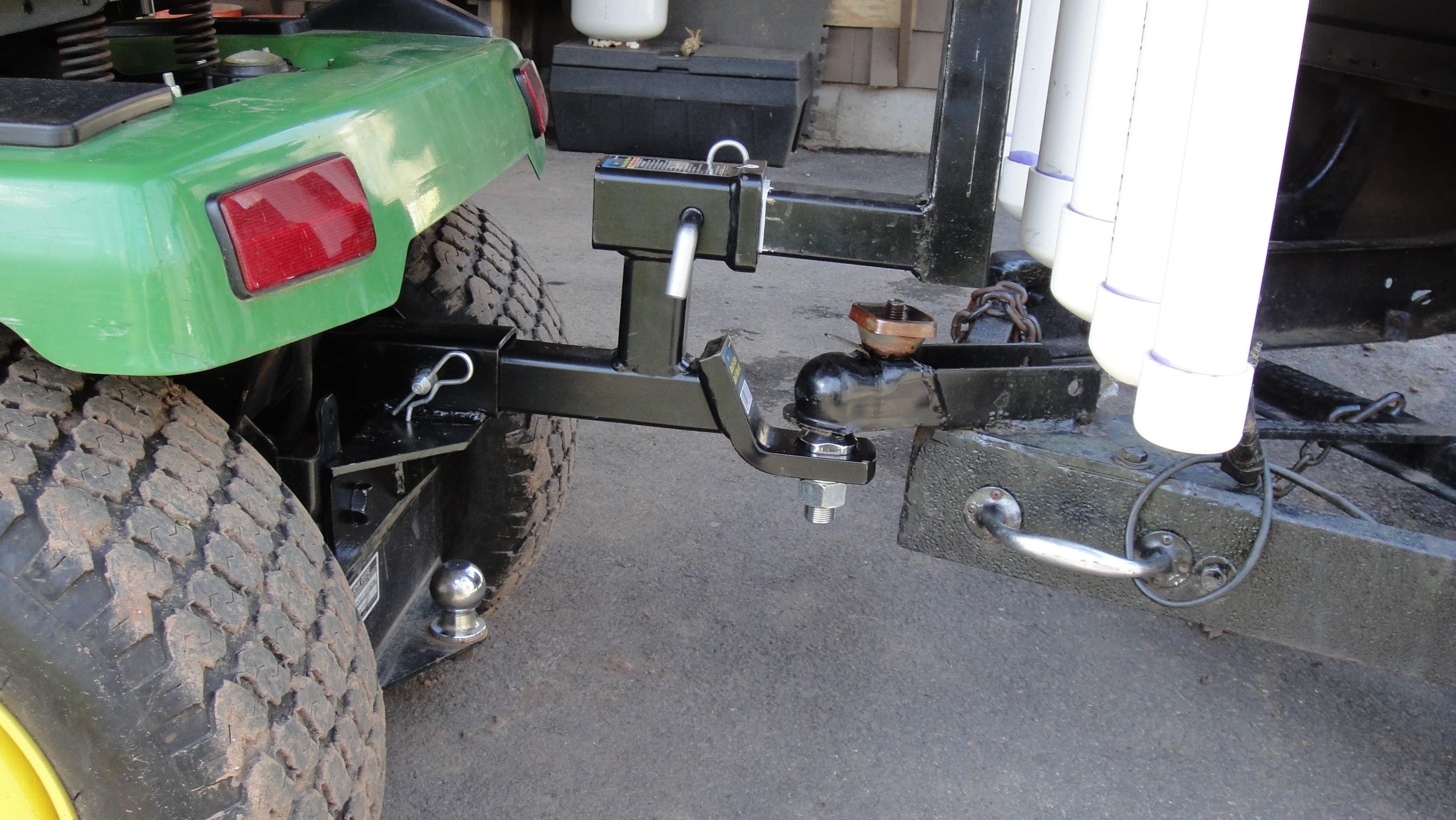

I didn't put a receiver tube on my JD steel box when I filled it with concrete, cause I figured I wouldn't want the heavy box when moving trailers. But now I think I'll weld one on, still probably only use it for occasional trailer moving, but they are so handy for other things like you mentioned.

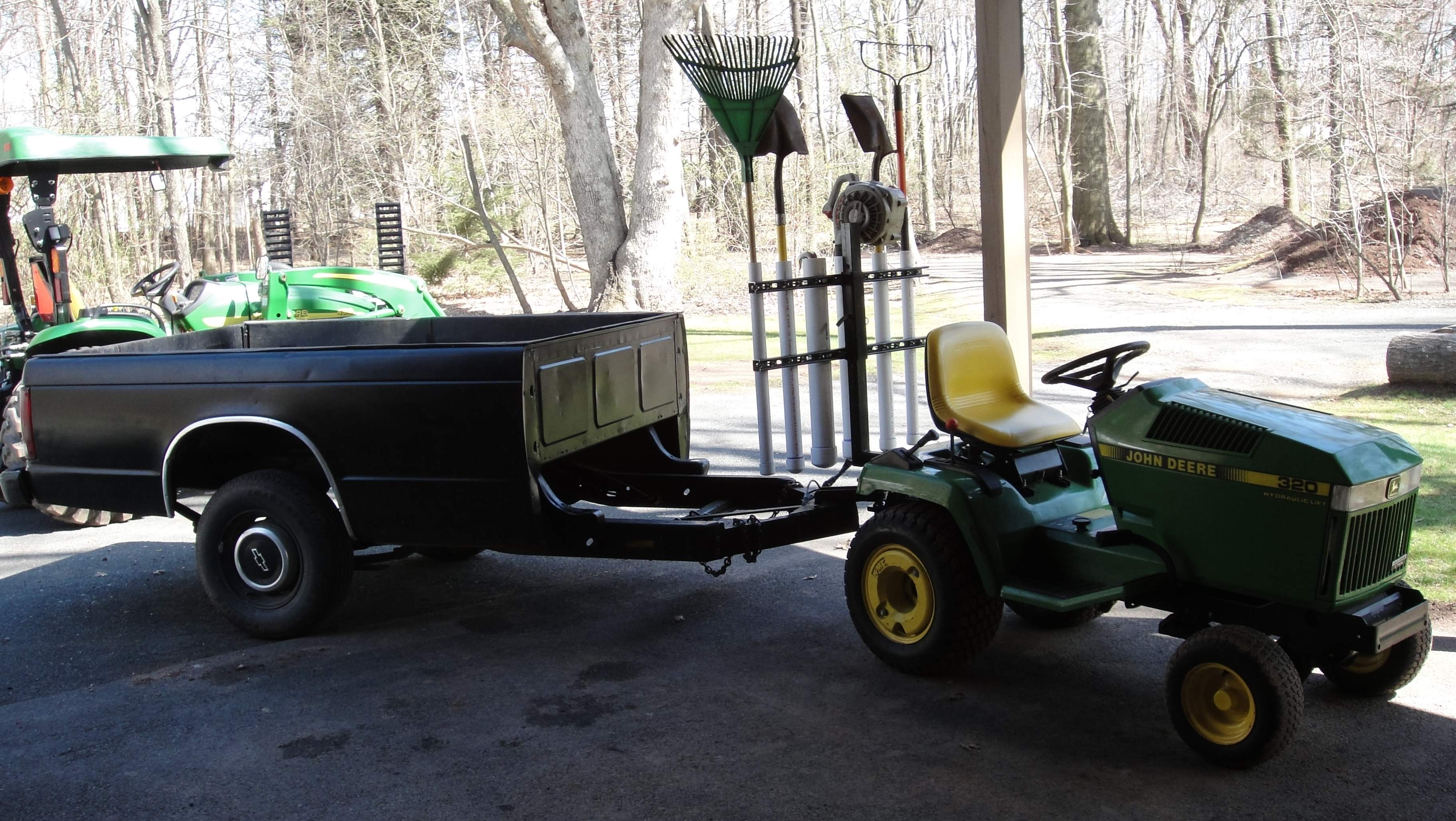

I am a nut for those receiver hitch tubes, I have them on everything, my loader bucket, my two 3pt QH's just mounted one on my lawn tractor for a tool carrier I rigged up.

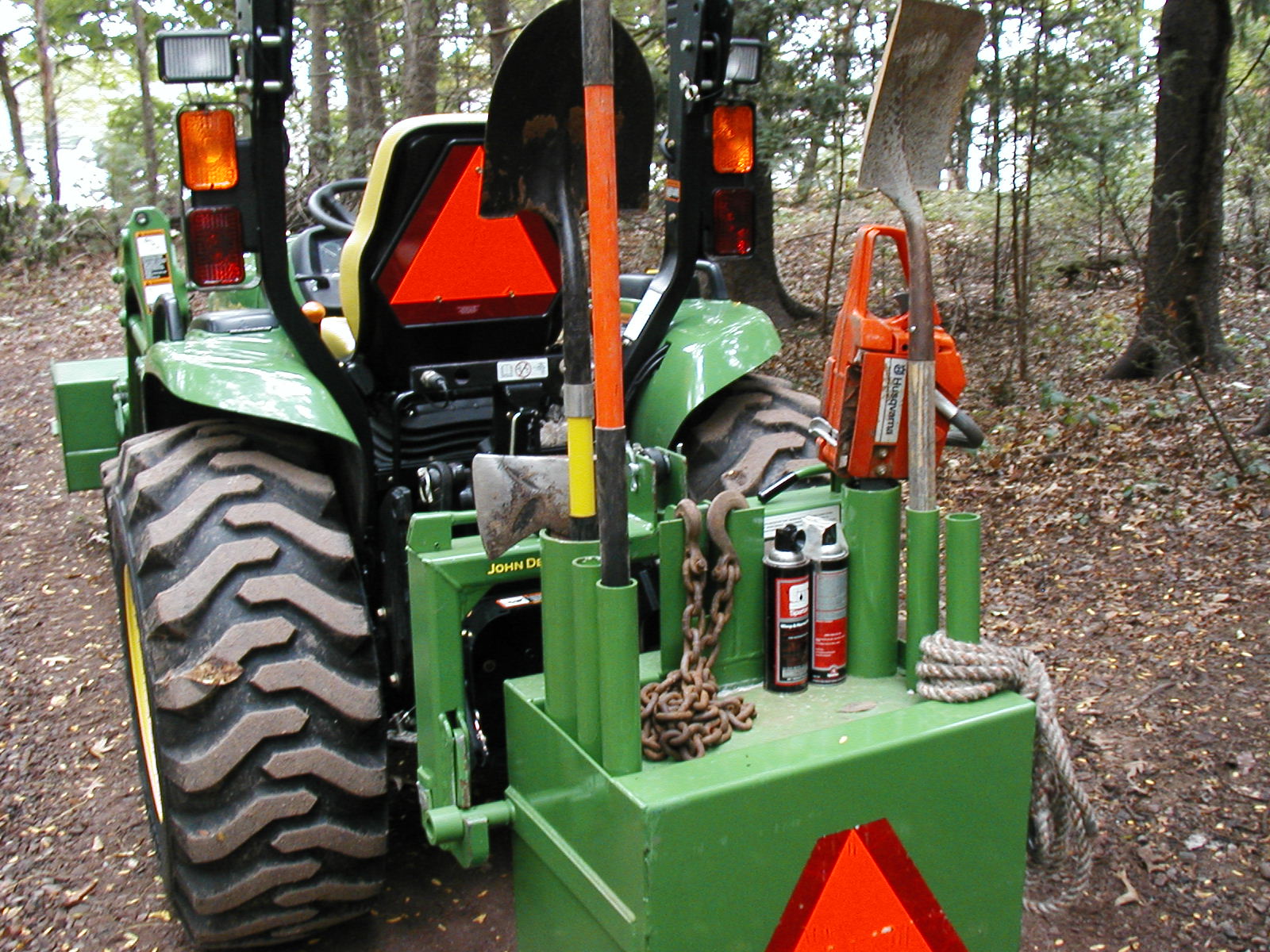

As far as what type of pipe to use for shovels rakes etc, just had another thought. We're worried about plastic breaking and metal rusting, how about a pipe just used as a form, before the concrete sets, twist the pipe around to loosen so it could be removed, then the hole in the concrete could be re-sleeved if the pipe needed to be replaced.
I used 1.5 inch pipe, most tools fit, but some of the new plastic handled tools don't, so I would say stay with 2 inch, even a skinny handled tool wont slop around much, about 30 inches seems to be a good height.

That is a great idea. attached are pix of mine- I later welded the top half of a Mack front spring "u" bolt to the verticle but hooks would be better. Also if I ever build another one, besides the ideas others have had about shovel holders, I think I would cast some heavy pipe in place to create leverage points to stick a pinch bar in to help muscle it on and off the three point hitch.
