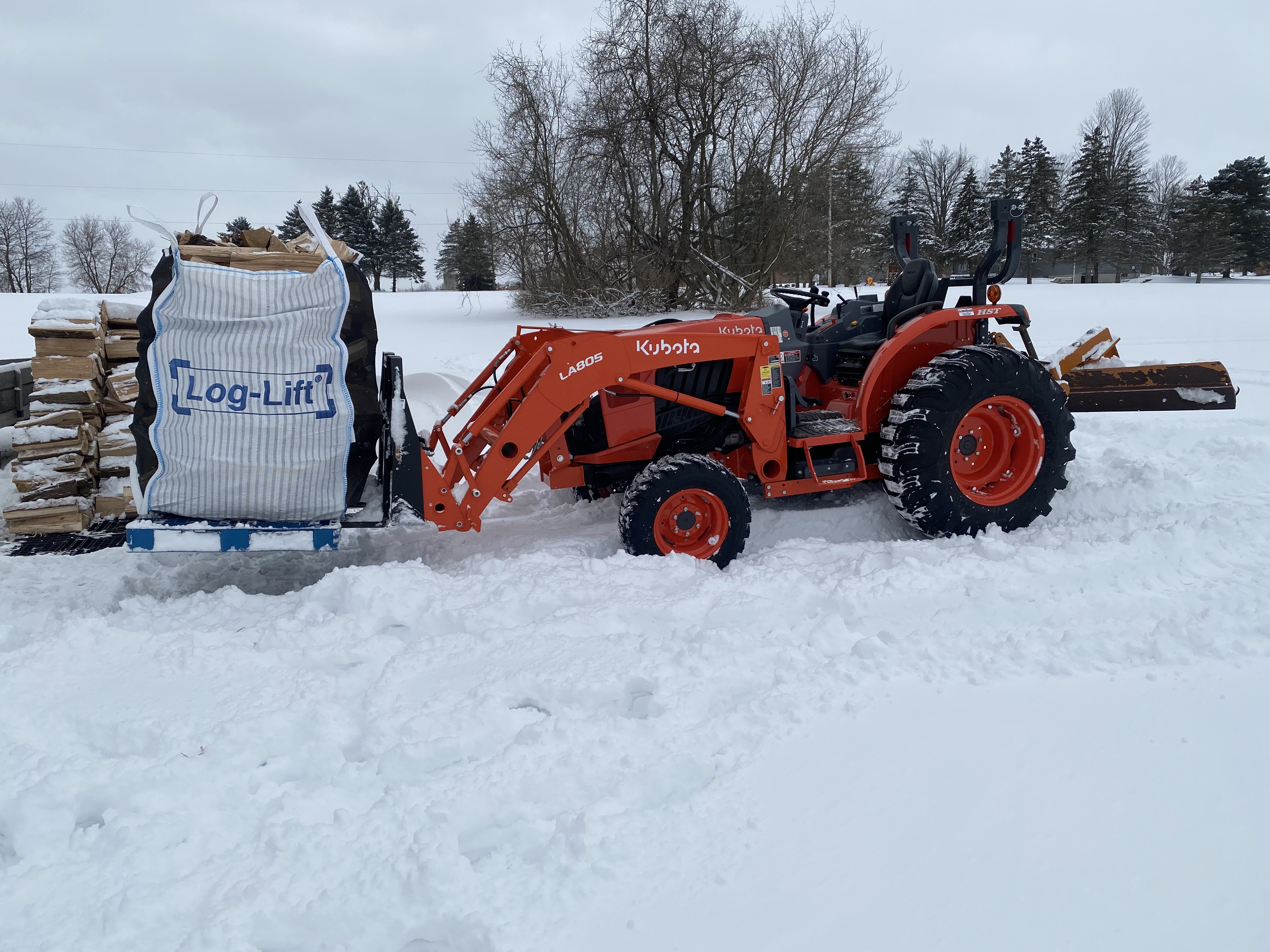

I have a 60" box scraper that I used on my B2650. Its too small for the L4060 and I have been working out plans to build a concrete ballast box for the 4060 as its primary role will be to work in the woodyard.
As I was sitting here working out selling it to fund a larger box blade, I thought "why not use the old box blade, add some rebar and a form for the bottom and the front, and turn it into a ballast?" It already weighs a few hundred pounds, its quick hitch compatible which I need and it will get the weight wide, low and behind the arms which equals less weight needed.
Am I crazy?

Rather than filling it with concrete, why not build a form to pour a block that will fit on it, but can be removed with your loader if necessary?
I am planning to do this.

Sell the box blade for a few hundred and spend a small portion of it for your own custom ballast box.... I have about $50 into a 500 pound one for my SCUT.... You really want your ballast to be as compact as possible, it runs into thing if it covers to much territory...

The box scraper was my primary ballast on the 2650, I'm used to its presence on the back of the tractor and it will have a smaller footprint on the 4060. I also do not operate in confined conditions so there really isn't anything to hit other than a pile of wood.
/ Box Scraper converted to rear ballast....
#14
Well, the 4060 was able to lift these with just a 72” blade on the rear. I think it would have been fine even without the blade.
So I’m just going to build a simple block of concrete.
