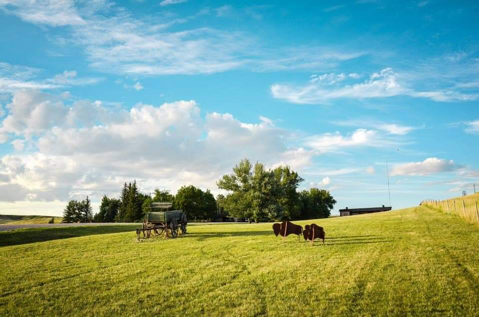

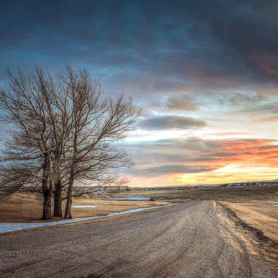

Potholes develop because water can not escape. The road surface should be higher than the surrounding dirt and it needs to be trenched to move the water away.
On my ranch, my grandfather understood what it takes to make a good road. He raised the road bed up about 10 feet from the surrounding land and made good ditches the entire way. I have never seen a pot hole on that road in my life. The water never sits on the road and it's always in the ditch. Good roads have good ditches.

This^^^^
Potholes are the symptom of an underlying problem (poor drainage). Tackling the symptom, without addressing the underlying problem, is a fools errand.

So all I need to do is have the drive 10' higher, and have good drainage?
I'd go 15 feet up, just to be safe. Should only take about a couple hundred dozer hours and 50-60 tri-axle dump loads of fill. Easy weekend job. I mean, you don't want any pot holes, right?
