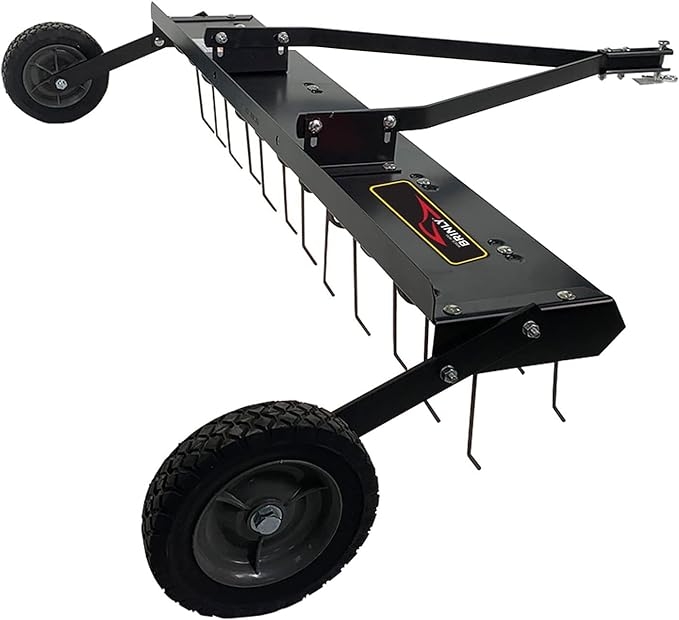

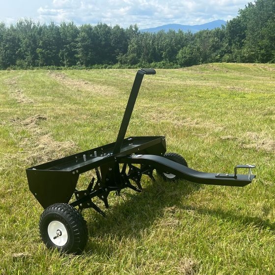

When I over seed our lawn I usually cut it a bit shorter than normal, run a plug aerator over it a few times, run a dethatcher over it a few times to break up the plugs and remove the dead grass and make nice scratch marks in the soil, then spread the seed. At this point, some people would roll the lawn to make good seed contact with the soil. I don't have a roller, so I run the dethatcher rake over it again in the opposite direction a couple times then water it thoroughly. That tends to get the seed into good contact for us.
