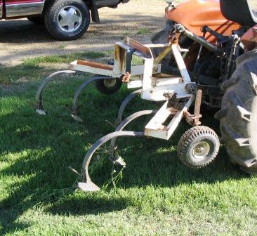

so if i remove the center shank on this single row cult. it should work good??

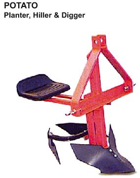

Here's one from the farmfleet catalogue.

Kuby, No. Those feet will only form tiny little ridges. You need something to make ridges at least 2 feet apart, and preferably 2 and a half, and a definite inverted V shape, or maybe just a slightly flattened off point.
I do not like the gadget shown in the post after yours. A single plough like that only makes a furrow, and if used for lifting the crop I would remove the two rear wings which will only re-cover some of the crop so that you have to dig them out with your hands as you pick up. You need at least two ploughs so that they make one drill/hill between them, and preferably more. 3 allows you to have a person planting on each side of the machine. Any more ploughs and you need automatic delivery of the potatoes from a hopper. The potatoes need to be planted IN FRONT of the ploughs so that they are buried in the hill that is made by them. Go back to my post on Harry Ferguson's system if you want to plant more than half an acre. Less than that and you can make the hills then go along afterwards with your seed potatoes and manually plant them into the middle of the hill, but it is a lot of work. Father and I used to plant up to about an acre every year that way, and then dig them all by hand too. So I speak from experience!!! Old McDonald.

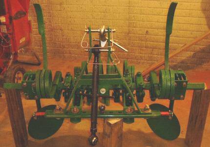

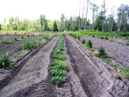

Kuby,
Here's my row hiller that I made with help from a friend. Its just a couple hiller plows (rotary discs) mounted on the diamond bar of a soil ripper off a JD M. My friend gave the soil ripper to me, helped to build the drawbar to attach it to and the clamps to attach the shanks to the diamond bar.
You can buy little chisel plow cultivators from Agri Supply that mount on a square bar. Then buy the disc hillers to go on them. Only catch is you need the the clamps. Don't think Agri Supply has them. Think there's an outfit in Ohio that offers them for square bars. Search for "row hillers" in google to find them. Agri Supply had the best price on the disc hillers.
I did 20 rows in my garden with the row hiller. I put in 4 rows of potatoes. Still have the last row to dig up yet. (I just dig a few at a time with a digging fork, enough for me and the wife and some left over to take to church for folks to take.)
Ralph

/ Potato hiller ideas #29
Here's a shot from the rear.
I've since painted it, bought 2 12" discs, and mounted some of the soil ripper stuff in between.
I made the rows with 2 16" discs. I plan to use the smaller discs to just keep the rows but to rip them and toss stuff from between the rows on top with the 12" discs.
Ralph

/ Potato hiller ideas #30
Here's my "row maintenance rig" shot from the front with it sitting on stilts in the garage of my carriage house where I park the JD 4010. I haven't used it on the tractor yet.
Ralph

Kuby, as you have seen, there are several ideas on this potato hilling thing. Some are for building the hill first and then planting , the other is to plant your potatoes first, then hill as they grow later. The later is my technique, using the
combination of middle buster and one row cultivator.
The cultivator we have, is not as heavy as the one in your picture. I saw one in the Northern hydraulics catalog made by kingkutter and it is labled as a "C tine cultivator". That is like the one I use. It is not as heavy duty as the one you show, and the shovels do not have wings but are fairly straight. The catalog I had priced it at around $180. KingKutter also makes the middle buster plow which I think you can get for around $100. With these 2 you have everything you need.
The cultivator you show I would think would work...however the shovels are a little more agressive. You should be able to adjust the center tines as needed to fit over the row. The faster you drive and deeper you go, the more agressive the hilling. You have to be careful to have adequate space between the first 2 tines, or risk digging out your vines. The proper use of this tool will really loosen up your soil and promote good growth. You can also use the cultivator after you have dug and picked up your potatoes , to throw dirt back into the furrows...this may also uncover some potatoes you missed in the initial digging.
The plow that Luremaker shows, is essentially the middle buster with the addition of some back wings (hilling?) and a seat. If I am imagining right, a guy would sit on the seat and drop a potato behind the furrow plow, and in front of the hiller wings which look to be there to cover the furrow back over? I do know that the seat would come in handy when you are digging potatoes with just the middle buster (hiller wings removed). Put a guy back there and he would add weight to your plow to get it down, and also he could direct the driver if he was getting off the row.
