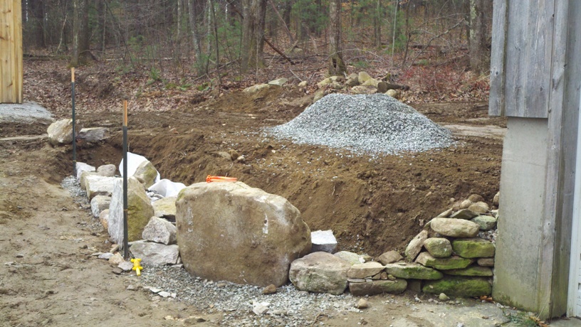

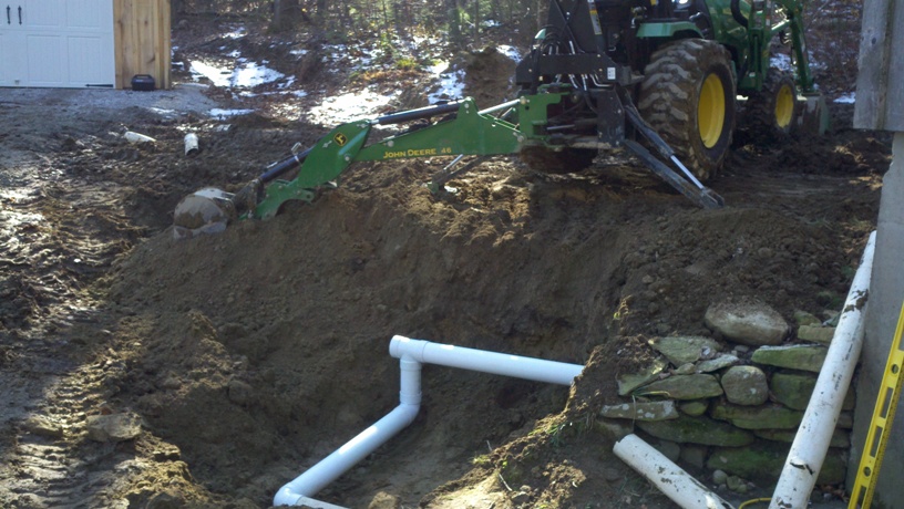

Here's a little stone wall started yesterday. The first thing I had to do was excavate down to some old drain pipe work, rearrange the configuration, and avoid the underground power. Not a day to have a beer in the cup holder.
The 2520 was indispensable. I used the landscaping fork tines to harvest the large stones. The big center stone couldn't quite be lifted (almost though) so it was dozed and rolled through the mud. Rolling large stones is easy with the little forks - just be sure to keep everyone out of the way in case it gets away and starts to roll. They're also handy for dropping them onto another rock to split them, if you can catch the grain just right.
I can't wait for this wall to be finished. It will be a big help catching heavy rains and eliminating erosion and a bad ice problem in the winter, and will also work as a loading dock hidden in full sight (shhh, that's a secret!).

Chris,
If you haven't backfilled it yet, you might condsider cutting that Tee out a rotating it 90 degrees and extending a pipe to grade and installing a clean out. Just a thought.

Mechanos,
Thanks, but if that pipe gets clogged up in that spot, there will be much bigger problems. The drain drops about 6 feet underground after that last turn. It was installed 30 years ago before I got it.
To keep the intake clean, the perforated sections are surrounded by landscaping material. Another section I installed 3 years ago this way is working great. It's kind of a frankenstein system, but it's the best I could come up with with all of the factors at hand.

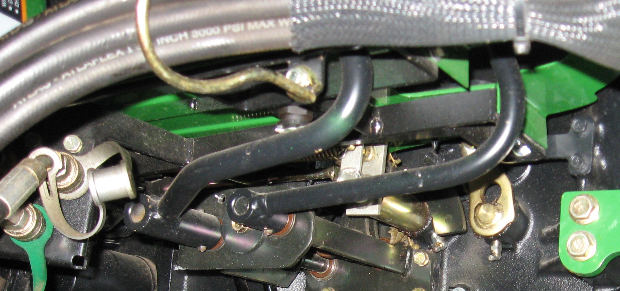

Smalltown,
I hate to be a party pooper, but I think your hose hanger may be installed incorrectly. But hey, if you like it that way then there's nothing wrong with that. Plus, the mounting location that the installer found looks to be intuitive, if I were the sort of person to assemble things without reading first.
Here is a scan of the Deere installation instructions for installing this hose hanger. These particular instructions are for the Front Quick Hitch, but the hose hanger installation is the same regardless and this is how the hanger is configured on my 2520. I'll try to get a picture, but it's probably going to slip my mind a few dozen times first.
For the record, Smalltown's hose bracket is installed correctly for an old-style rig. Mine is a 2007 and is installed exactly the same way, i.e., bolted through a tab under the floorboard. I think this was a better way to do it and can't figure out why they changed it on the newer 2520's. Perhaps the newer models don't have the dedicated mounting tab?Our 2520 002 b.jpg
   / Post your land projects! New 2520 owner here #31
That makes sense. Funny, I've never noticed any others like this before. Still, I would rather have the hoses routed under the floorboard for the occasional right side mount, which is already a bit of a game of Twister as it is.
   / Post your land projects! New 2520 owner here #32
Just to circle back, here is the photo of how the hose hanger should be installed (currently). I took it mine a step further and tucked the vertical turn-down into the corner so it couldn't rotate. Hopefully this is clear and obvious in the photo.
Runner, the tab that was used to mount your hanger is still present on the tractor.
