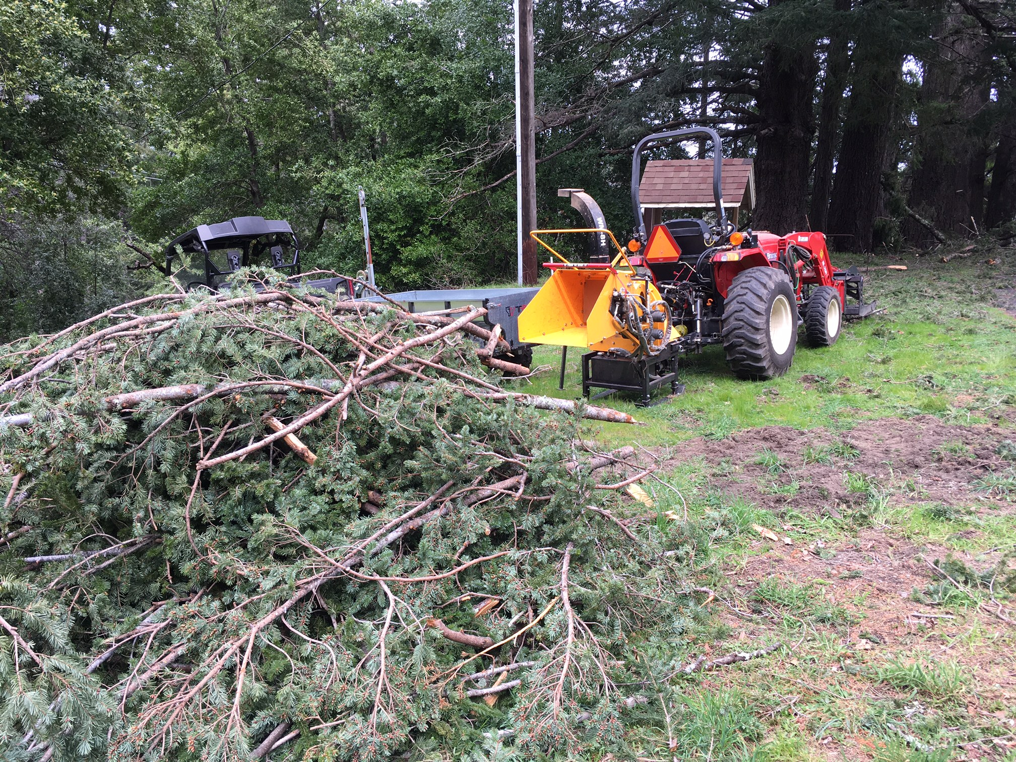

This is from a couple days ago but I'll be doing more today and for weeks to come: chipping up huge amount of branches that were broken out of our trees by an unusual snow storm a few weeks ago. I'm still working around the house and driveway. There's a lot of firs and they really took a beating.
That's a UTV and 4x8 dump trailer for the chips just to the left of the chipper.

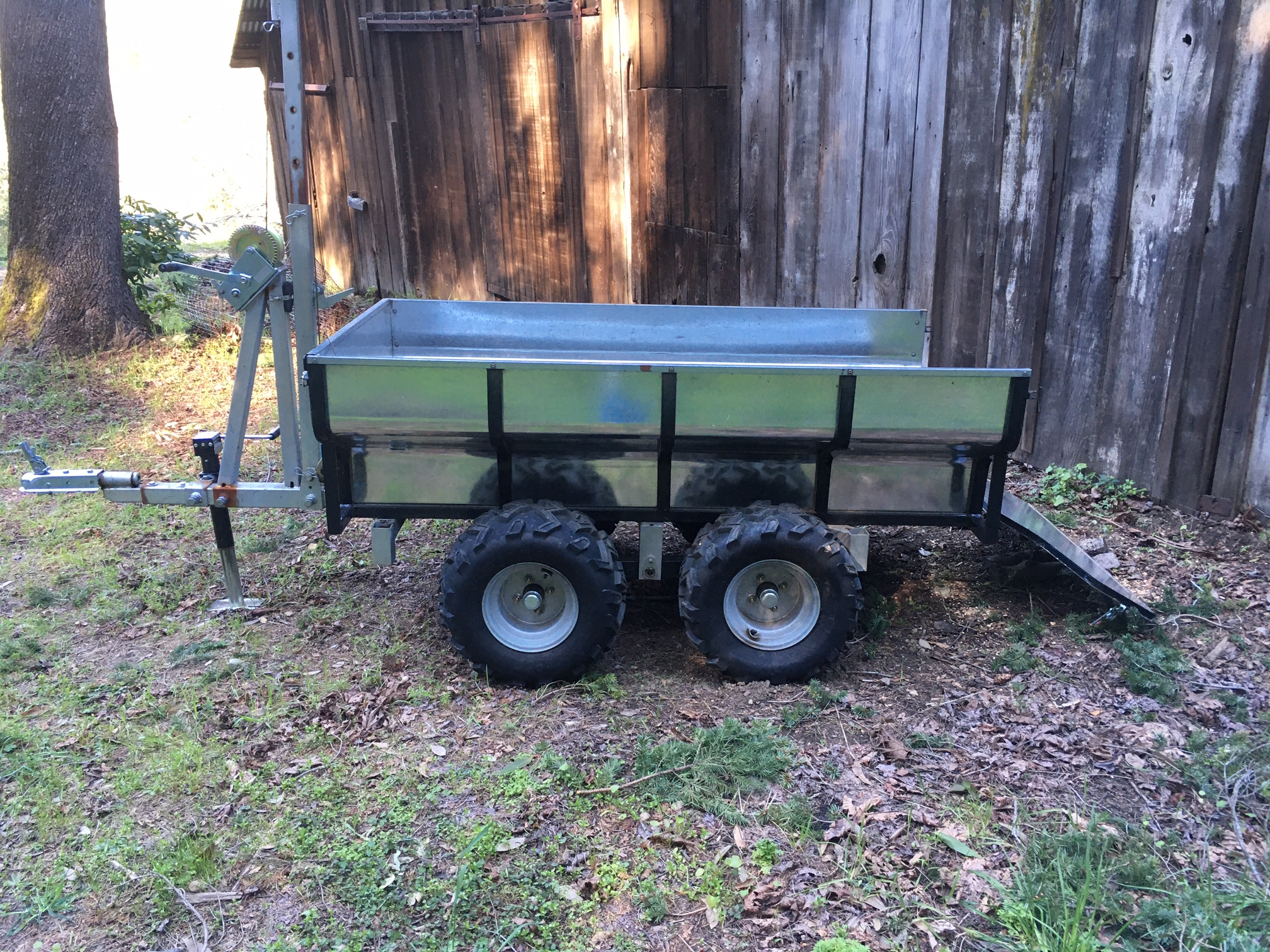

UTV trailer:
It was sold by Woodland Mills. They have a redesigned model now, which looks like it has some improvements. Like a top hinged tailgate. I have to remove the tailgate to dump. Mine's "galvanized" but it's the worst galvanizing I've ever seen. I need to derust the parts that are rusting and paint them.
It's super useful and carries about 4x what I can get in the bed of the UTV. I have not used the log trailer feature since I have a grapple for the tractor, but it would be good for carrying logs longer distances than I need to on my 20 acres.

UTV trailer:
I like it. Looks like the current offering is painted.
Would it be possible to attach panels (like plywood) to extend the height of the box for very light materials (like wood chips)?

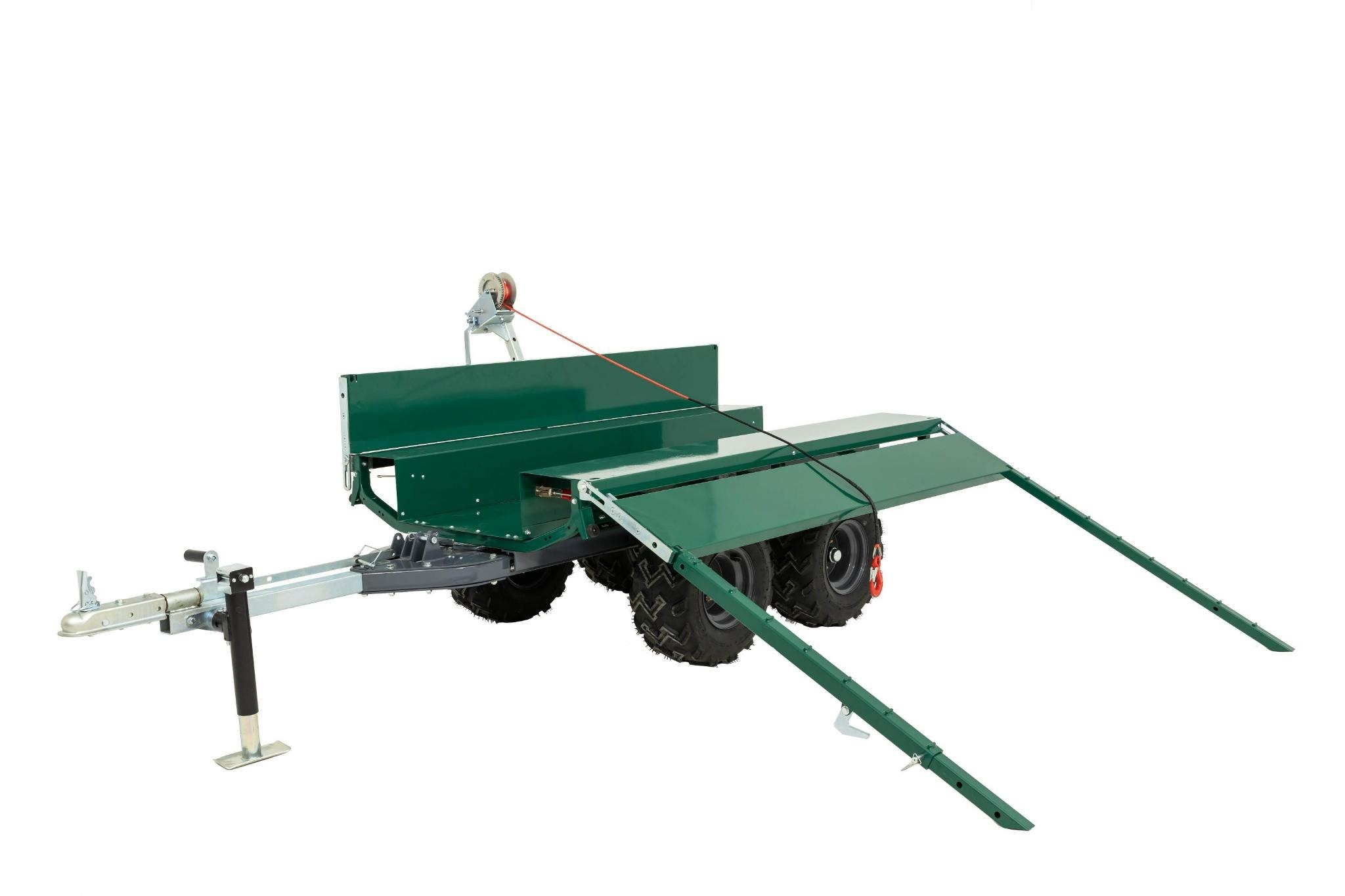

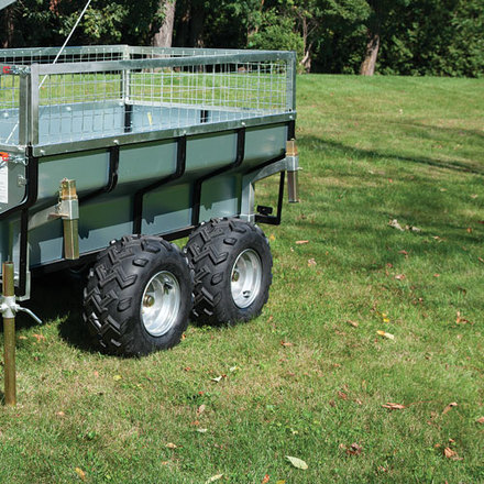

Apparently they sell extensions. I'd probably jury-rig something with plywood instead of the grid.
edit: just realized this is for the DR versa-trailer which looks like yours and less like the WM one
It would be tempting to set up a cylinder for dumping, hook it up to a remote and remove the crane for the most part

I've been tempted to put an electric winch on mine, but the hand crank works ok and does not require adding a second battery to the UTV. Much of the time I'm shovelling chips out anyhow.
Mine is similar to the DR but had a few features I liked better and I thought it would be made better (DR has a pretty poor reputation).
Piled high with chips it's got about as much weight as I should be pulling with the UTV. I did once load it with wood down at the bottom of my property and drive up to where I process firewood and the UTV was really unhappy about pulling it up the slope.
