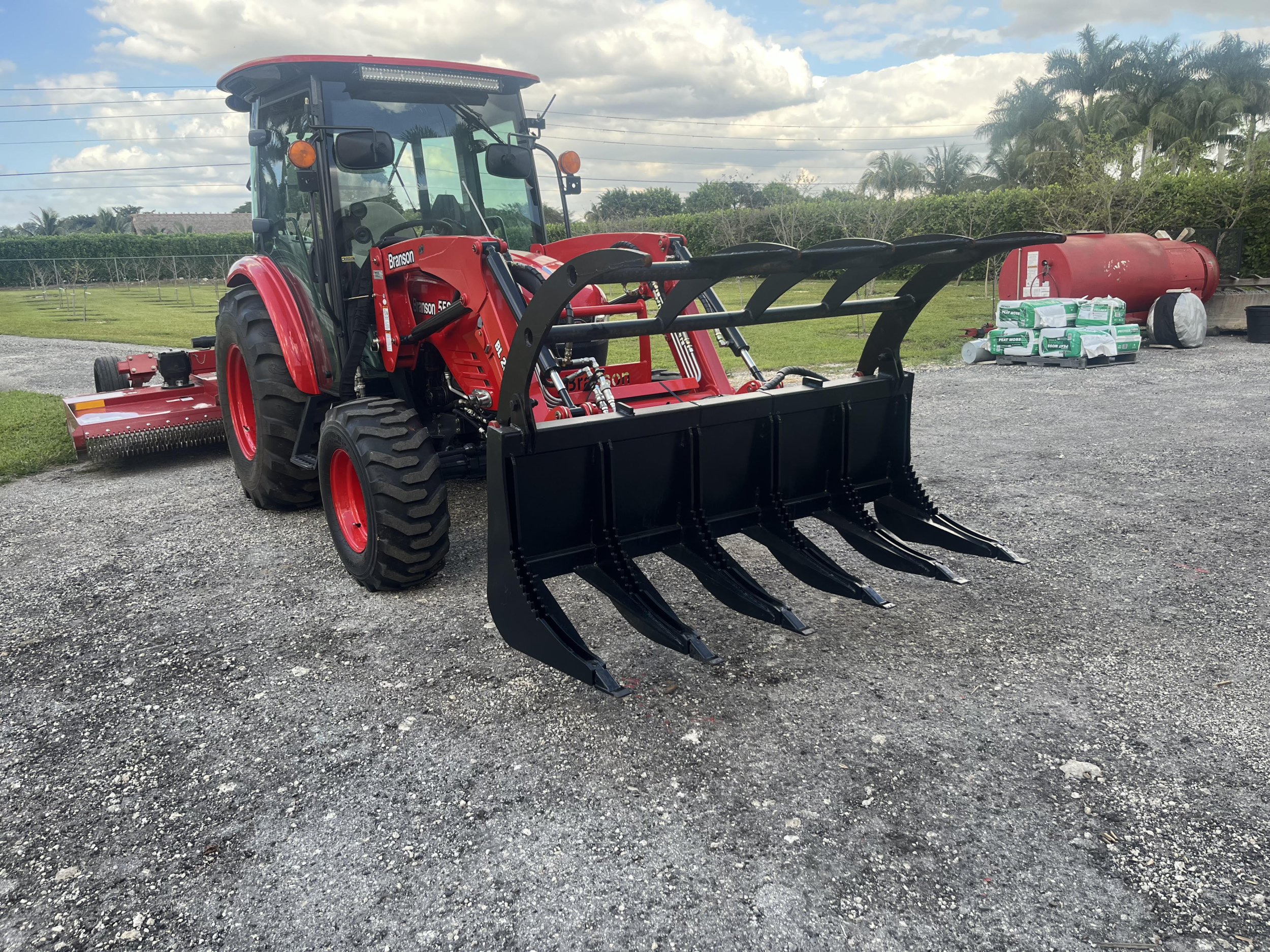

I bought a new grapple just mounted it on today
Then I got carried away and mounted it on the Toyota!!🤣🤣🤣

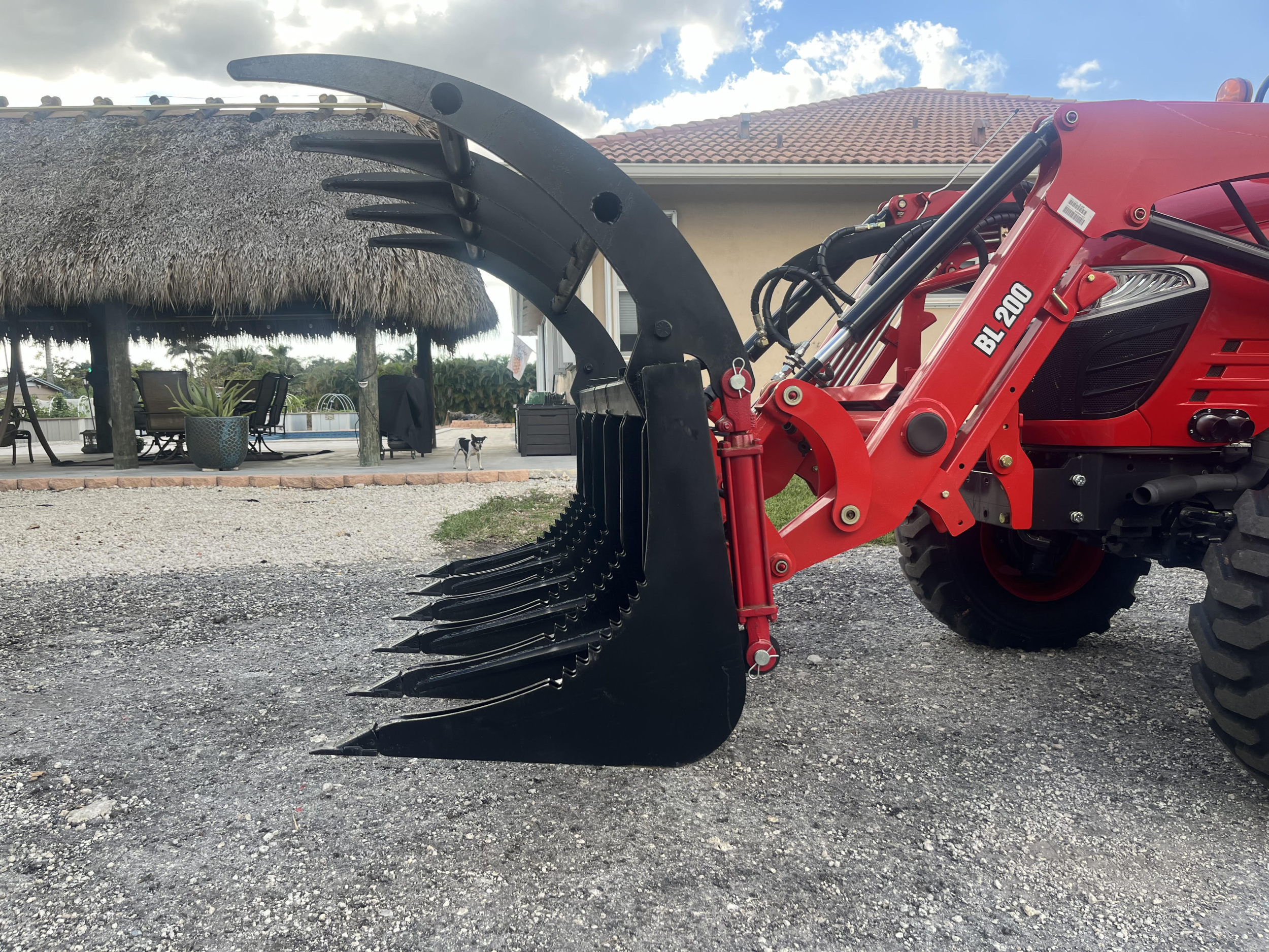

Bought it from Stephens Equipment in PA.
Name brand ???? the tags fell off ....

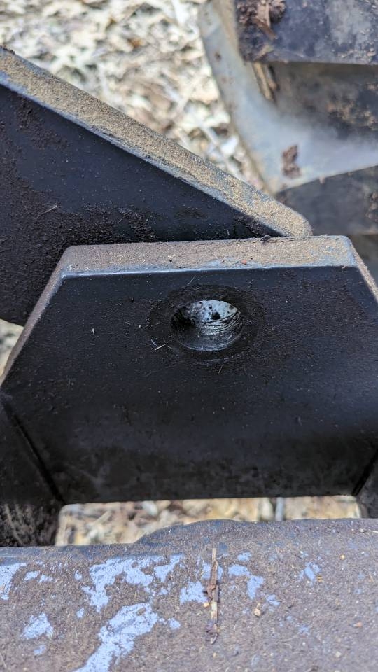

I was digging in an area that will someday be a small pond / water feature near the uphill garden when I heard a very loud squeak and I realized I hadn't checked my right front tire which is somewhat prone to air loss in a while, and sure enough the squeak was the tire dumping what air was left in it as it pushed by a large rock with a full bucket.
While it was filling, I looked around the tractor and noticed I'm missing a bolt on the backhoe - another spot I knew from the past that it should be checked occasionally as I saw the bolt there loose once... bleah

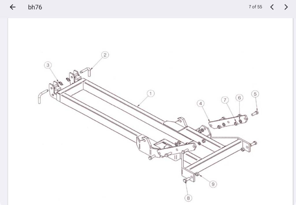

I found a file I had downloaded before, called "ANSUNG PART BOOK (ALL MODELS).pdf"
Looks like I need 5, 6, & 7.

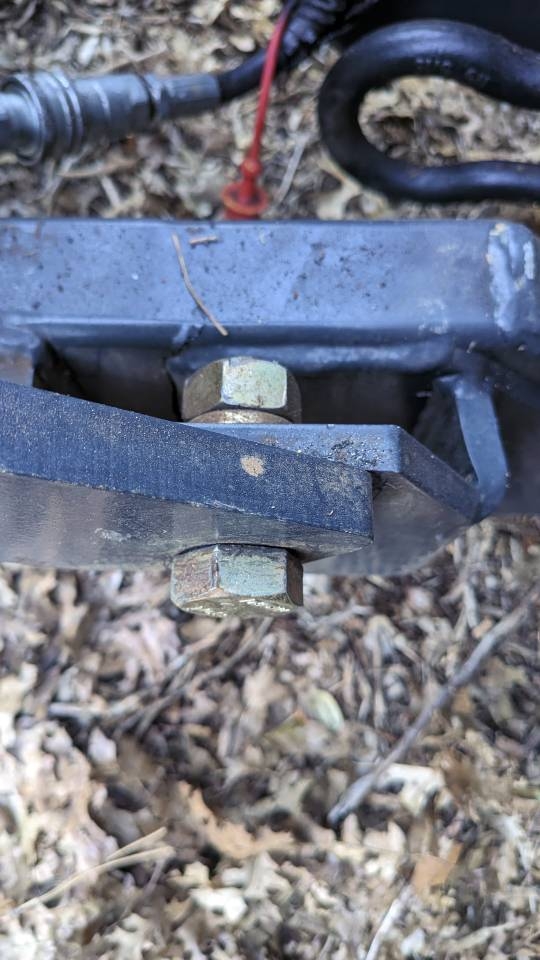

I picked up a grade 8, ¾"x2½" bolt/split washer/nut at my local hardware store.
Do you think the ~5% size difference between M20 (~20mm) and ¾" (~19.05mm) is ok or should I replace with a proper M20?
   / Post your Branson at work. Picture thread #227
I would use 3/4 if I could not find a M20 and not worry about it.
