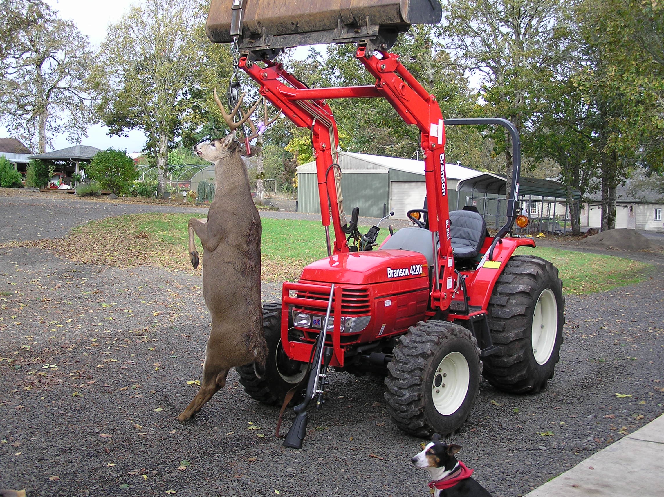

Nothing beats those back yard deer hunters....
212 lbs

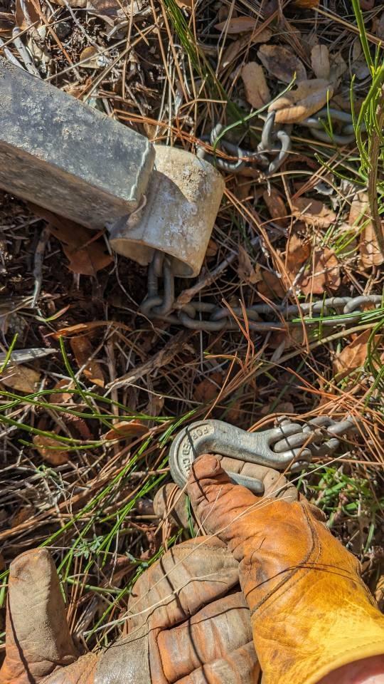

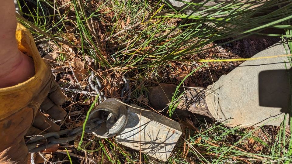

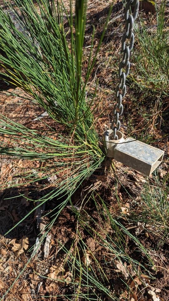

Sunday my wife and I attacked a very thick patch of scotch broom on our land.
Just the other day I saw a post that mentioned an article showing using a section of pipe to make a chain cinch without a slip hook, and that article mentioned that the pipe helps grasp shrubs to pull.
So I went to my scrap pile and found this funky aluminum thing that just fits a 5/16 chain hook and figured I'd give it a try. I tried to cut the rectangular tube piece off but apparently I don't have any proper cutoff wheels and figured for a proof of concept it didn't matter.

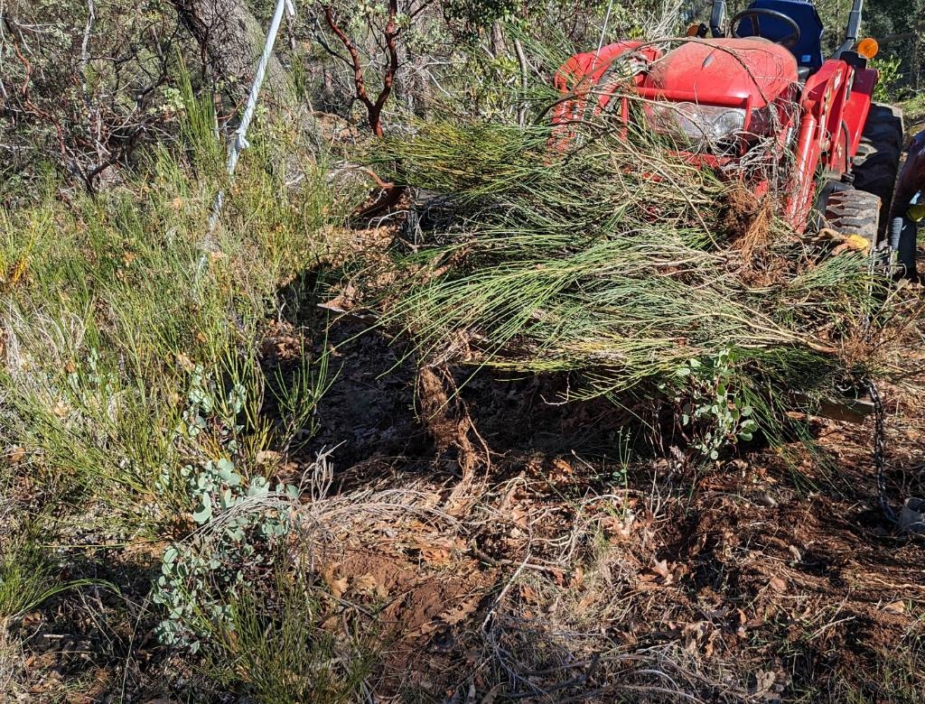

The verdict: it's a game changer for pulling smaller brush!
Usually I wrap a chain 2-3 times around a trunk and then close off with the slip hook, and that works fine - as long as the trunk is an inch or greater. Smaller and the chain doesn't close well on the shrub and it just pulls right off.
With the pipe section, you put the chain with the hook through the pipe, chain goes around the trunk, then back through the pipe and then hook onto the pipe. Snug it manually then pull up with the FEL. Almost every shrub came right out; the occasional one broke off.
I was manually pulling any that would come easily enough as the soil conditions are perfect for it and manually pulling is still faster than the pipe, but there were still tons that needed the tractor - it was really dense.
As it turns out that rectangular block on the pipe section was very useful - both as a visual "oh there it is!" and also to make it easier to hold on to with gloves on. I won't be cutting it off in the future.

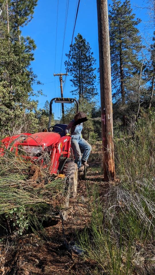

I got my wife in on the game too - her first time operating the tractor, finally; she mostly made the FEL go up/down to pull the shrubs (with a few accidental bucket curls interspersed lol) while I worked at pulling and setting the chain, and she also moved the tractor here and there as we completed what was reachable by the chain without moving.
We pulled three overflowing buckets worth of broom; I burned it all yesterday - it's ridiculous how flammable that stuff is even green!

That looks like a good trick for pulling brush. Better than the spring loaded jaws thing I bought that slips off the brush half the time.
That looks like spanish broom. I think it's the worst of the three brooms for flammability but at least it grows slower than the other two. Also isn't that the power like ROW? And isn't the power company supposed to keep it clear? I guess they and their contractors are as bad on your side of the state as on mine.

We have a variety of brooms here; when I look for images for "scotch broom" it's a very good match and everyone (including the local conservation group) calls it that, but if you can tell the difference I won't argue ;) I don't know about slow growth, it definitely invades all over the place here. I think one of my neighbors kind of likes the stuff in his meadow - I mowed a spot for him where a guy puts bees out and I offered to pull some of the worst of the broom in the meadow and he just shrugged his shoulders...
I also looked that the jaw thing and had doubts. Also saw their spiky chain thing and it looked decent but I just knew I'd use it on the the wrong thing and break the chain at some point. I'm definitely impressed with this thing. If you have a bit of pipe, give it a shot. I think like me you'll end up appreciating having a bit more to hold onto it as well though it doesn't need to be as big and clunky as my rectangular tubing. I've used a root jack / weed wrench and those definitely work well but the effort of carrying the thing around makes it mostly useful in dense areas IMO.
I've seen people recommend only pulling broom up to 1/2" thick because the soil disturbance increases spawn rates but I find that if you just cut it off, it'll be back the next year on the same root but be impossible to pull at that point even if you wanted to. I can see the point of cutting if you're in a remote area where you're trying to be one-and-done but I'm clearing my land and I regularly walk around and yank the little stuff by hand, so if there's ten that spawn the next couple years because of a pull, it's easy enough to deal with.
Yes that's the ROW. I'm surprised they don't seem to care about that pole, the one that's right by my gate they blast with a trimmer down to bare dirt pretty regularly. I literally cut a couple small trees down in the ROW to get there... they have gotten good at taking out trees that have at least a 0.3% chance of falling on the lines at least though I've called them out on some ridiculous choices like one tree literally growing away from the lines, enough is enough (I'm totally on board with them taking out real dangers mind you; they have the right to keep the ROW clear, but if there's a tree not in the ROW, I'm pretty sure they actually have to have your permission to cut it - I got a few thousand dollars' worth of tree work done for free when they took out a dying oak that theoretically kinda sorta maybe would've thrown a branch into the wires in some hypothetical never-happens-here cyclone so I can't really argue).
