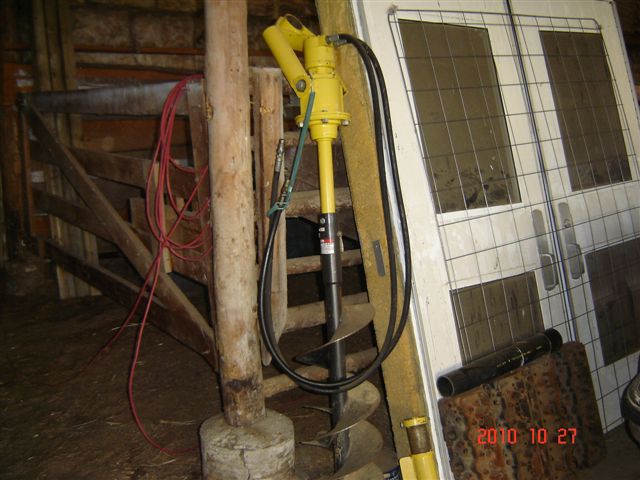

/ Post hole digger for FEL #7
I build this one from scratch about 6 years ago, the 12" auger part is the only thing i bought.
I dug at least a hundred 4-5' deep holes with it without an isue
I can mount it on any of the 3 front end loaders i have.
The yellow thingy on the bottom of the pic is an adapter to mount the auger on my CTL

I build this one from scratch about 6 years ago, the 12" is the only thing i bought.
I was in Peace River a few years back to a Jr B playoff game between Peace River and Whitecourt. Was a fun trip but that 3 1/2 hr bus ride to and from Whitecourt was a killer. Thanks for the picture, have any more of the way it mounts to the FEL?
Steve

I have a 2 prong bale fork,the auger has a piece of 2 3/8" pipe welded to the top, i just slide the pipe over one of the prongs and secure it with short chain to the forks frame.

In the pic above of the yellow one where can that hrive be sourced?

I build that drive myself out of a 4x4 front hub off a dodge truck, a piece of 2" shaft, 8 " of 6" dia pipe and various other pieces from my scrap pile. There is a HD love-joy coupler (also build from scratch)that connects the shaft to the orbit motor. I found the roller orbit motor at my local scrapyard(got it for free), its runs at about 60 RPM, it has proven to have plenty torque to twist that 12" auger.
There was quite a bit machining involved but i have a lathe. Without your own lathe it might get to expensive to build your own auger drive.
