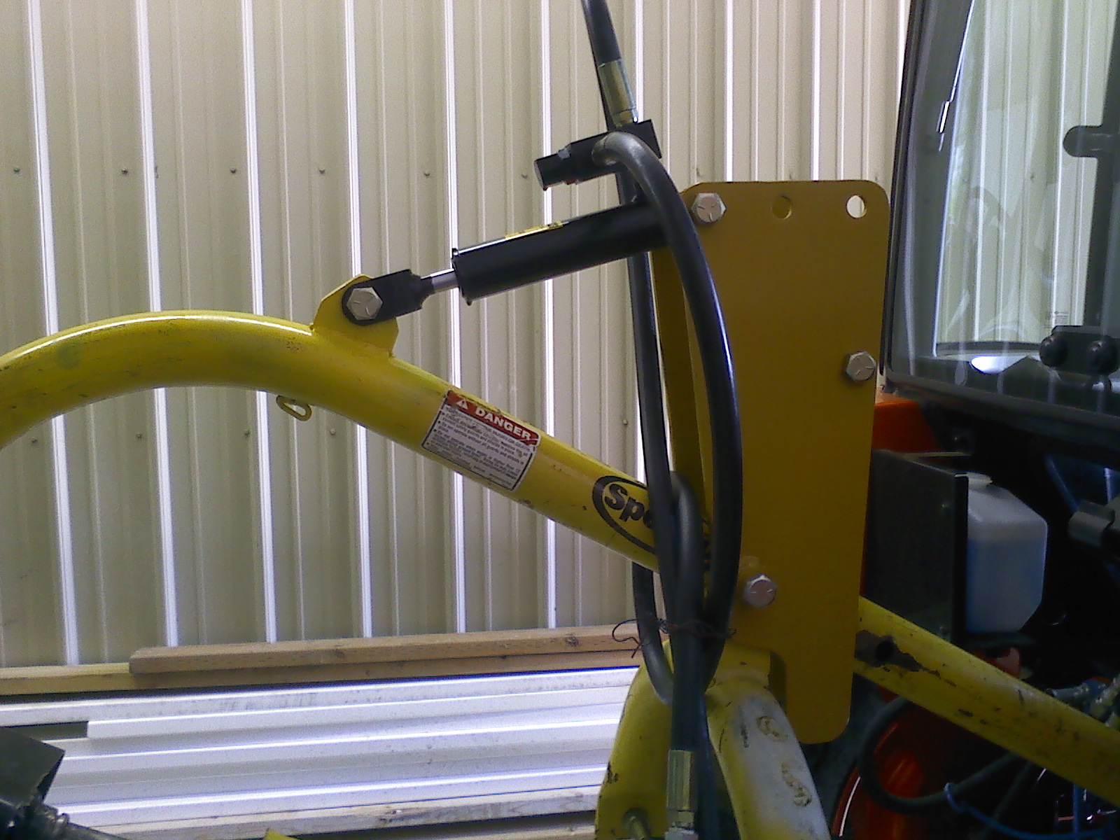

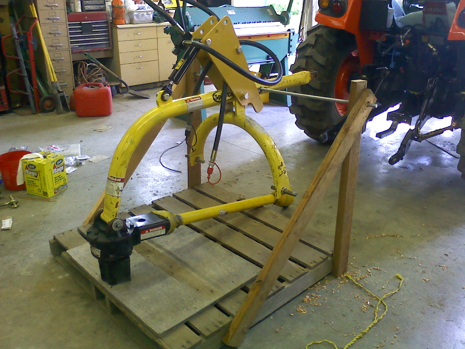

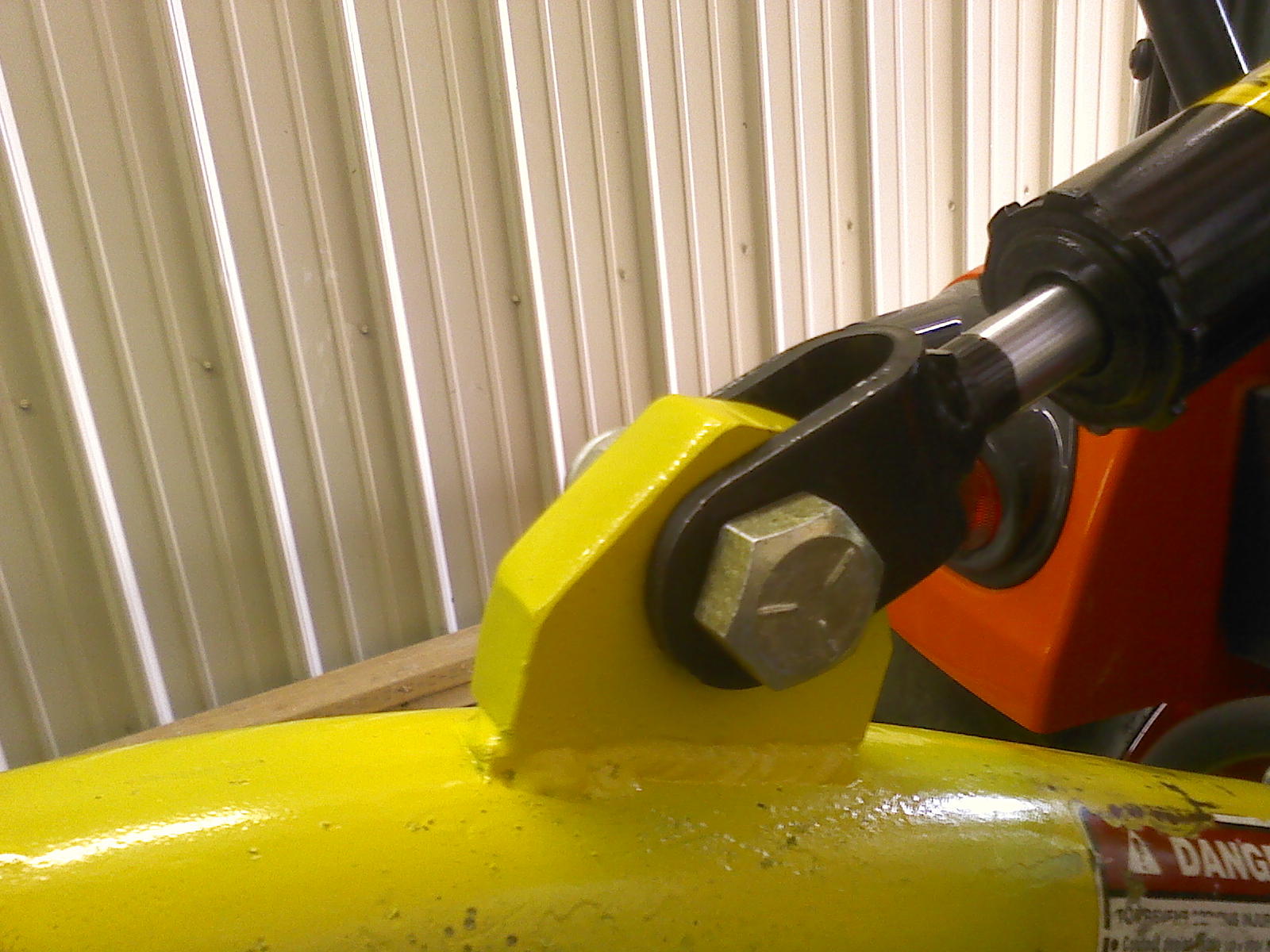

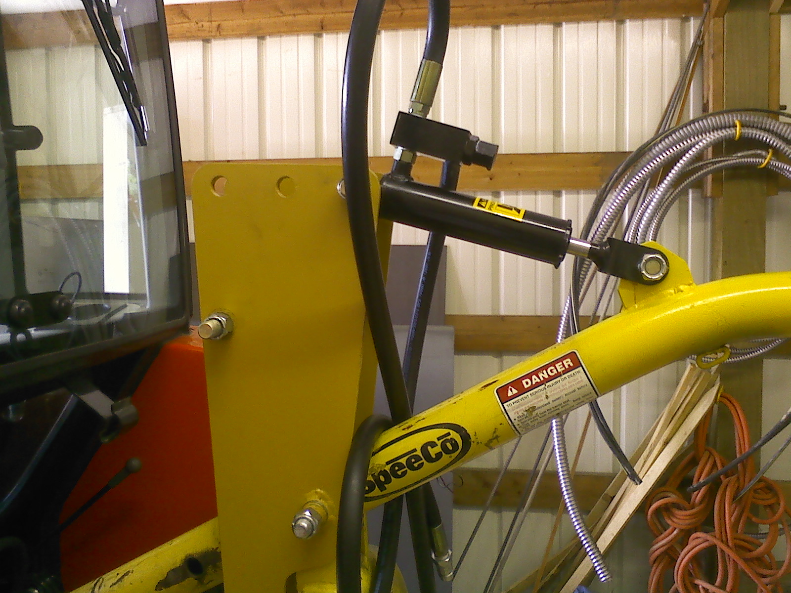

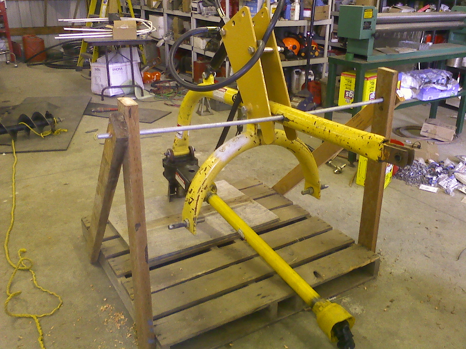

I added a hydraulic assist down pressure unit..ordered from Speeco... for about $300.00 complete. Makes drilling hols 1000x's less work.
I am able to use a loader mounted unit, but i already had a 3 point unit, and a hydraulic loader unit was real spendy. This unit adds pressure in the down force only, and freely releases down pressure as soon as i lift the 3 point. I dont have to do anything to release pressure except lift the 3 point.
Some day i hope to swap to a loader mount unit...after i win that darn lottery... 0520111640a.jpg0520111640.jpg0520111639a.jpg0601111506.jpg0601111506a.jpg
