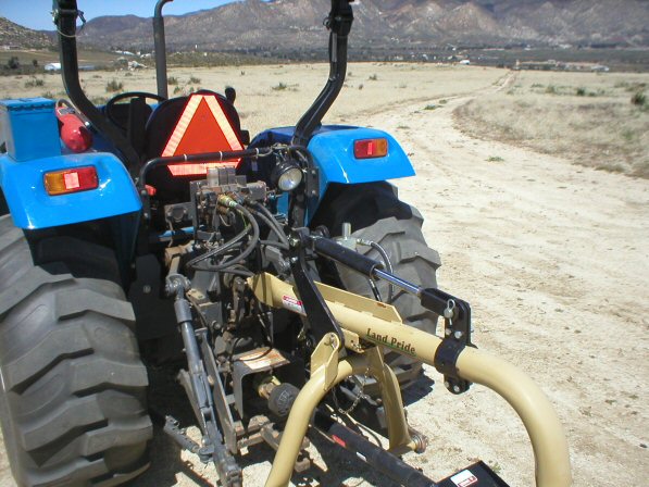

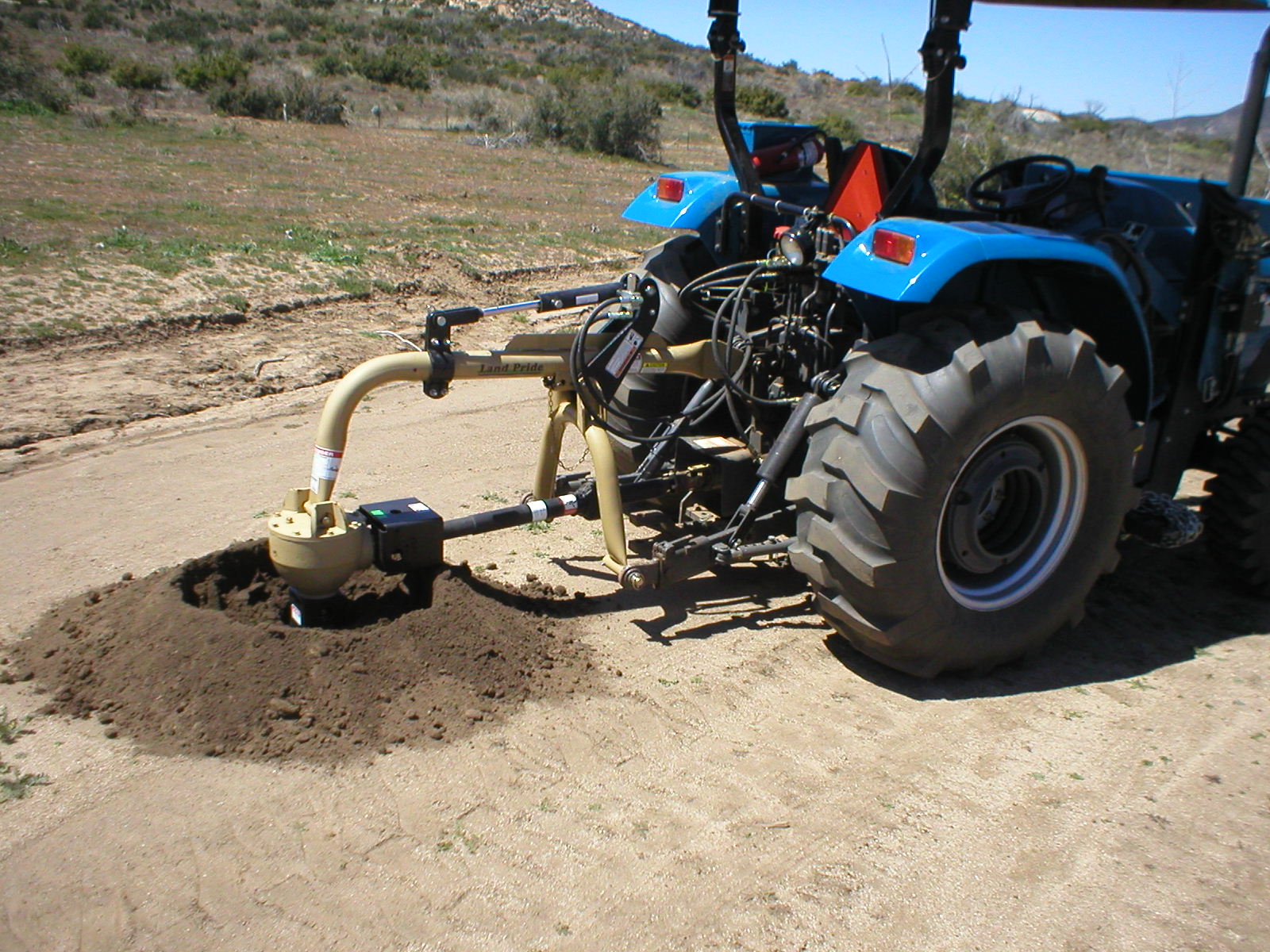

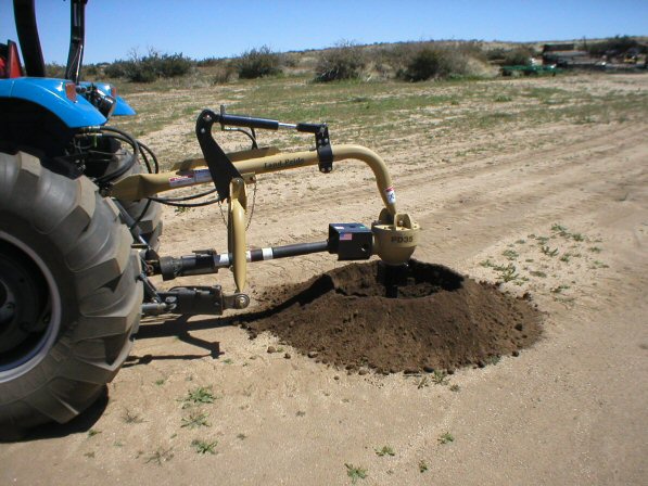

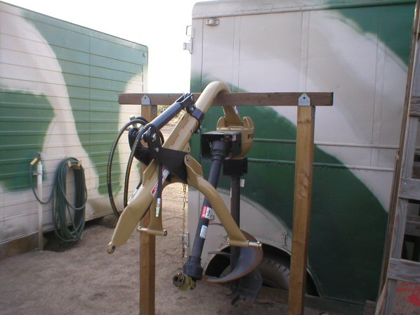

I believe that a 3pt PTO unit would be less money to purchase. If you are worried about down pressure, you can always get a down pressure unit for the 3pt PHD.
Hope this is not too far off subject, but what is a down pressure unit? Obviously the name is...obvious, how does it work?
I have a 3 pt auger with two different bits...this was my experience with it:
We Are Flying Solo: How To Dig A Hole
Down pressure -- WANT!
/ Post hole auger #18
I went from drilling an 18" hole 4' deep with water soaking and waiting literally for days to having down pressure and drill that same hole dry in less than 2 minutes. Trust me, it makes you a believer real quick. :cool2:
You need a rear remote and a drain to tank inlet. Don't bother with building a kit yourself, just purchase one and be done with it.

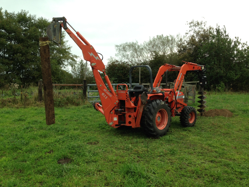

I have a hydraulic auger on the FEL and use the backhoe to set the post. I drop posts off ahead of time where I am working with the FEL. The reason I set up this tractor with the auger on the FEL is so that when setting a corner, I can use the backhoe to set all three posts without moving the tractor. This happens to be just an end cap of 2 posts. After taking this picture, I dug the second hole, then dropped both RR ties in with one setting of the tractor. It is 6 of one, half a dozen of the other, you can do the same with the auger and dig 3 holes with the backhoe. I do like the hydraulic auger compared to the 3 pt, very handy when I need to reverse the auger after getting under a root.

I can auger three corner holes without moving the tractor with the backhoe. Two holes in a straight line without moving the tractor. I sit posts too big to handle myself with a chain on the loader bucket's side.
andrehoude123,
I guess to answer your original question is to install flow meters on your FEL curl circuit and on your backhoe's curl and dump circuit to see which has the best flow. My BH has better flow than my loader's curl circuit.
