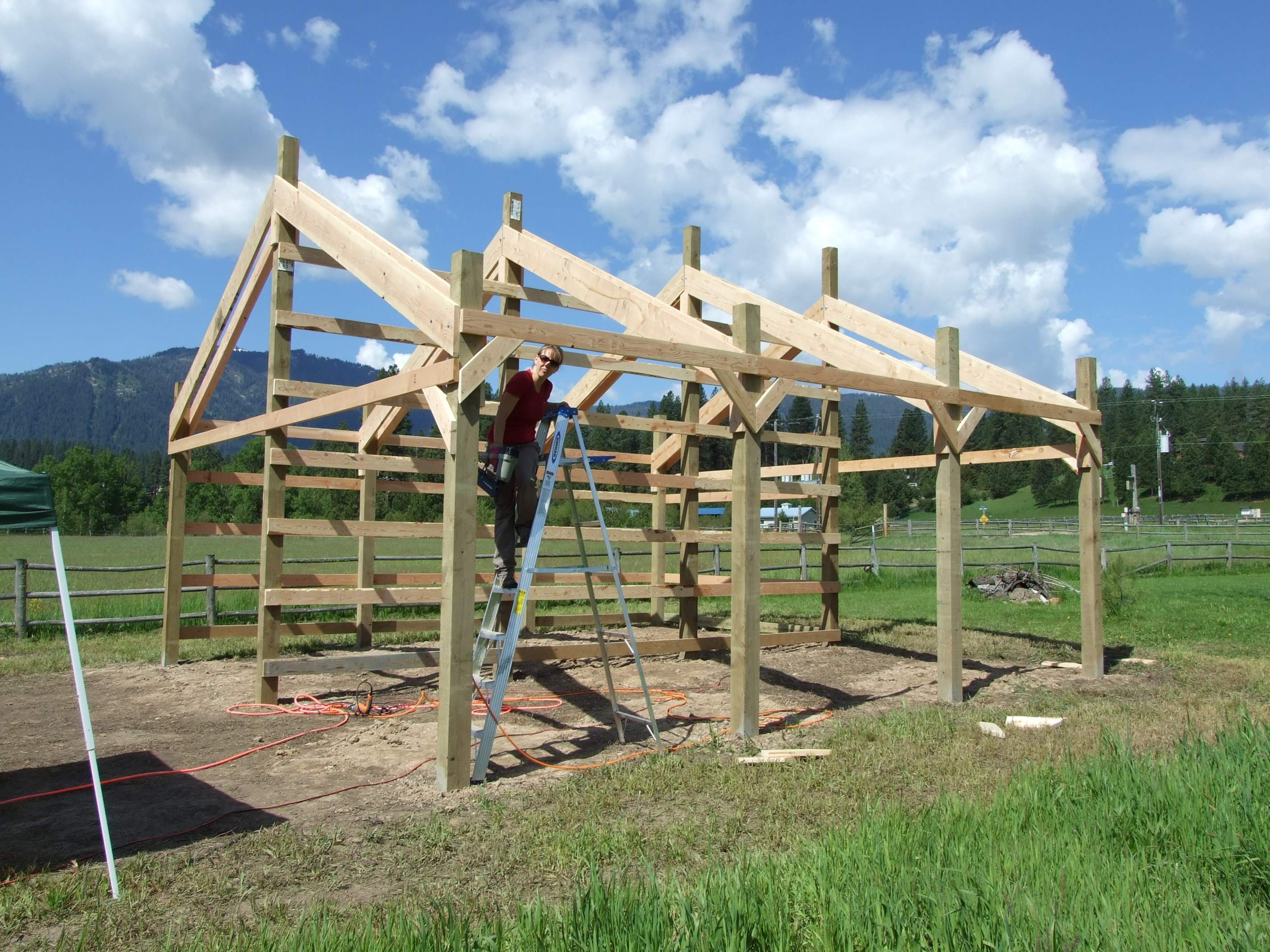

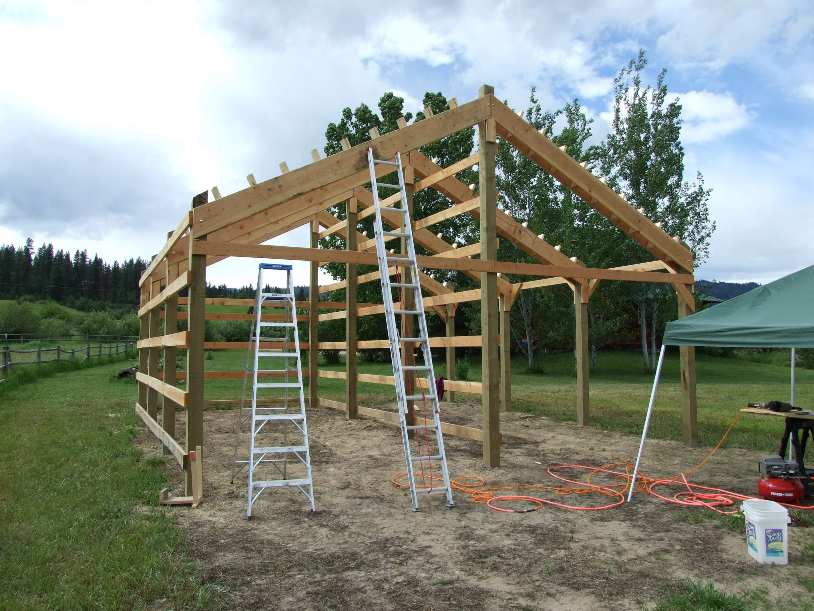

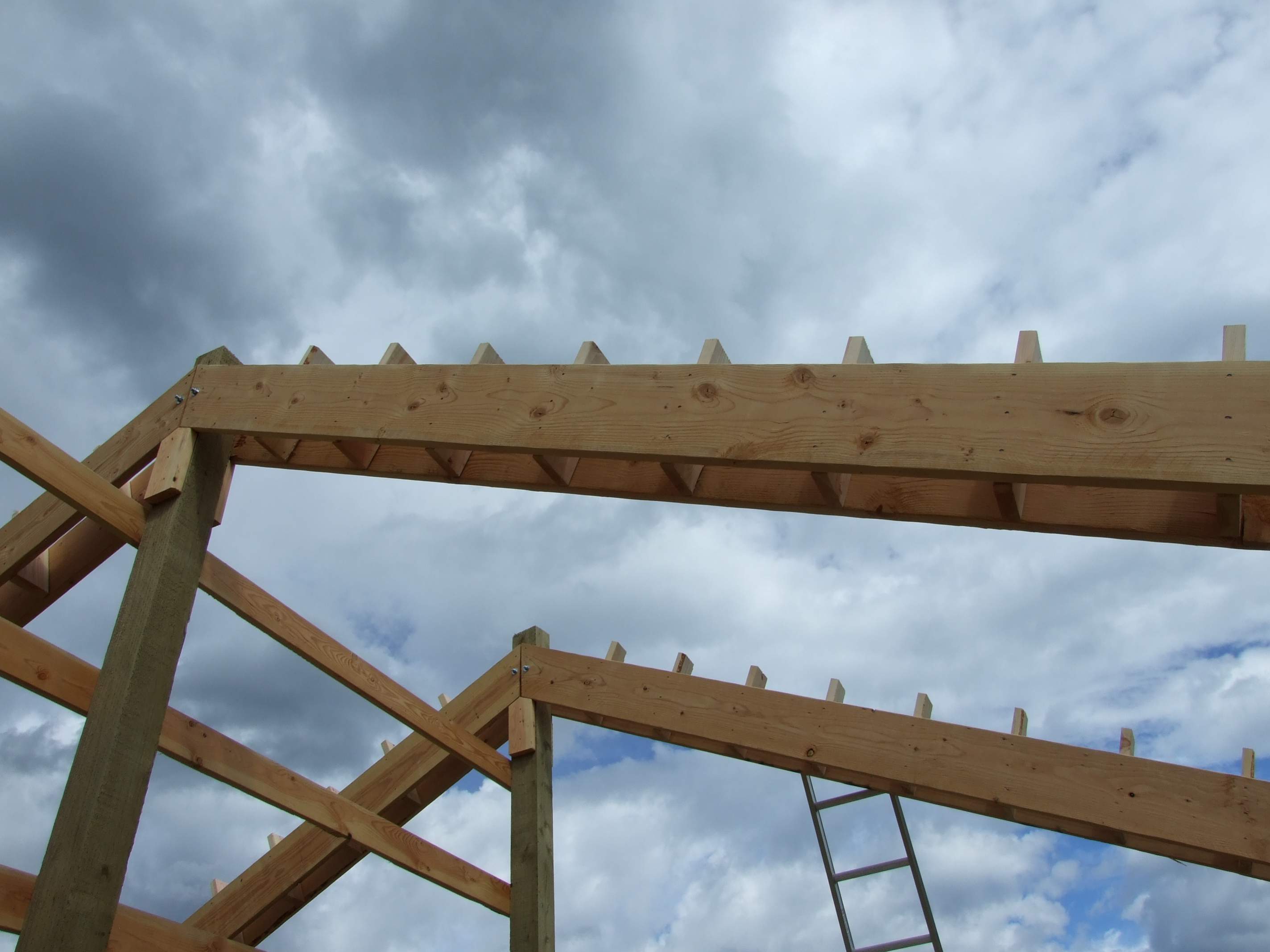

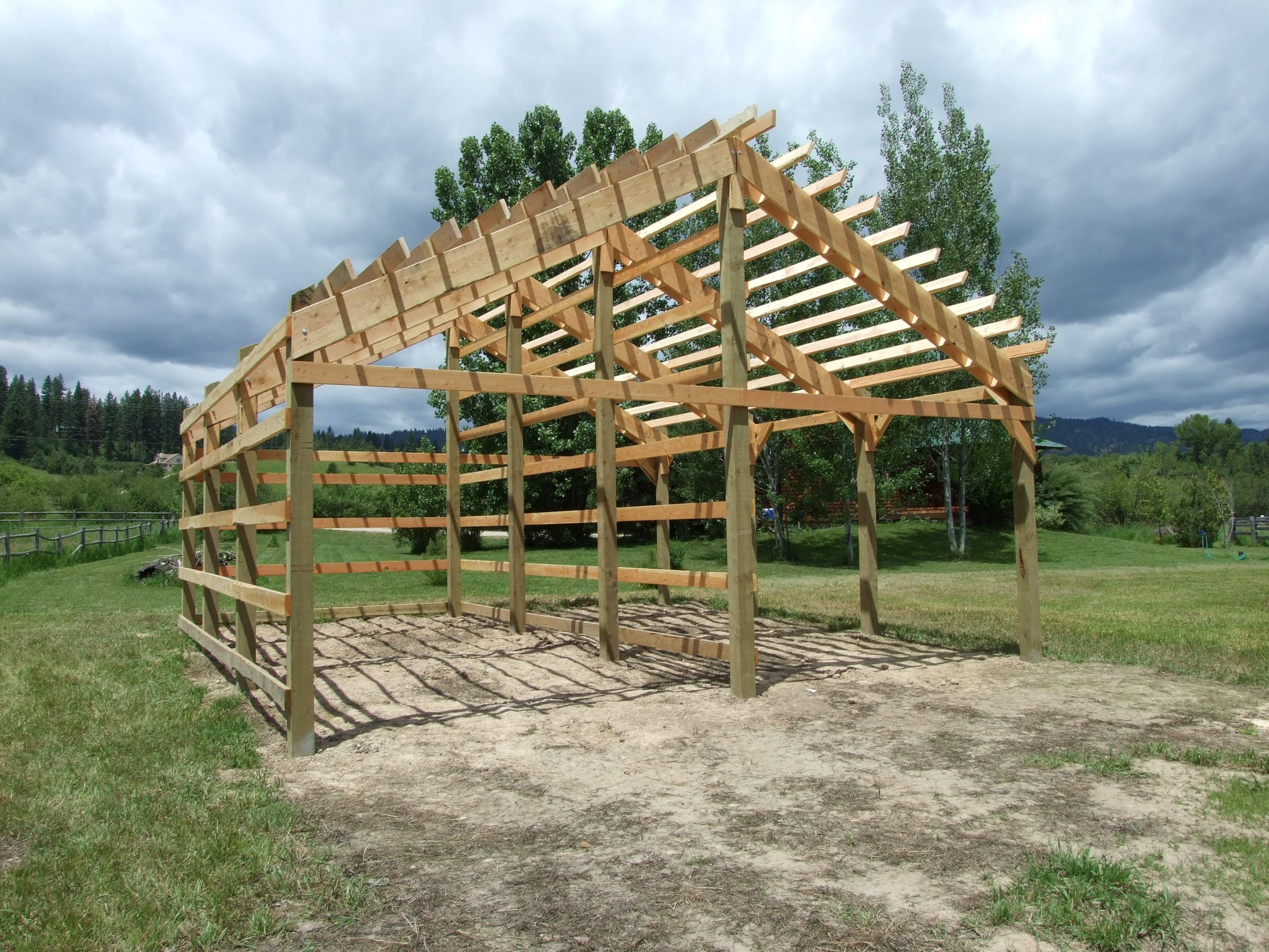

Outriggers, Facia, etc.:
So, after several weeks without a chance to work on the shed, we headed up for a long weekend prior to and including the 4th of July. The first task was to finish the roof framing.
The outriggers came first. Since I had ordered the roof panels cut to length and didn't want to cut any off, we had to measure the exact distance from the center post peak to the outer post, then add the proper overhang to get each outrigger's length. This worked okay, but in hindsight I think we should have just done it for the front and back posts, then stretched a string in between so the facia would end up straighter. Oh, well, it wasn't too bad. The outriggers got nailed to the post tops and then blocks added in between so there was more to nail the facia boards to.
The facia boards went on pretty easily on the eaves, but the gable facias were a little tougher to install at the top of the ladder. We got them done pretty quickly, though.
Lastly, we added blocking in between all of the purlins and several other strategic spots on the enclosed side to close-up any gaps between the framing and roof.
After a day's work, here's what we had:

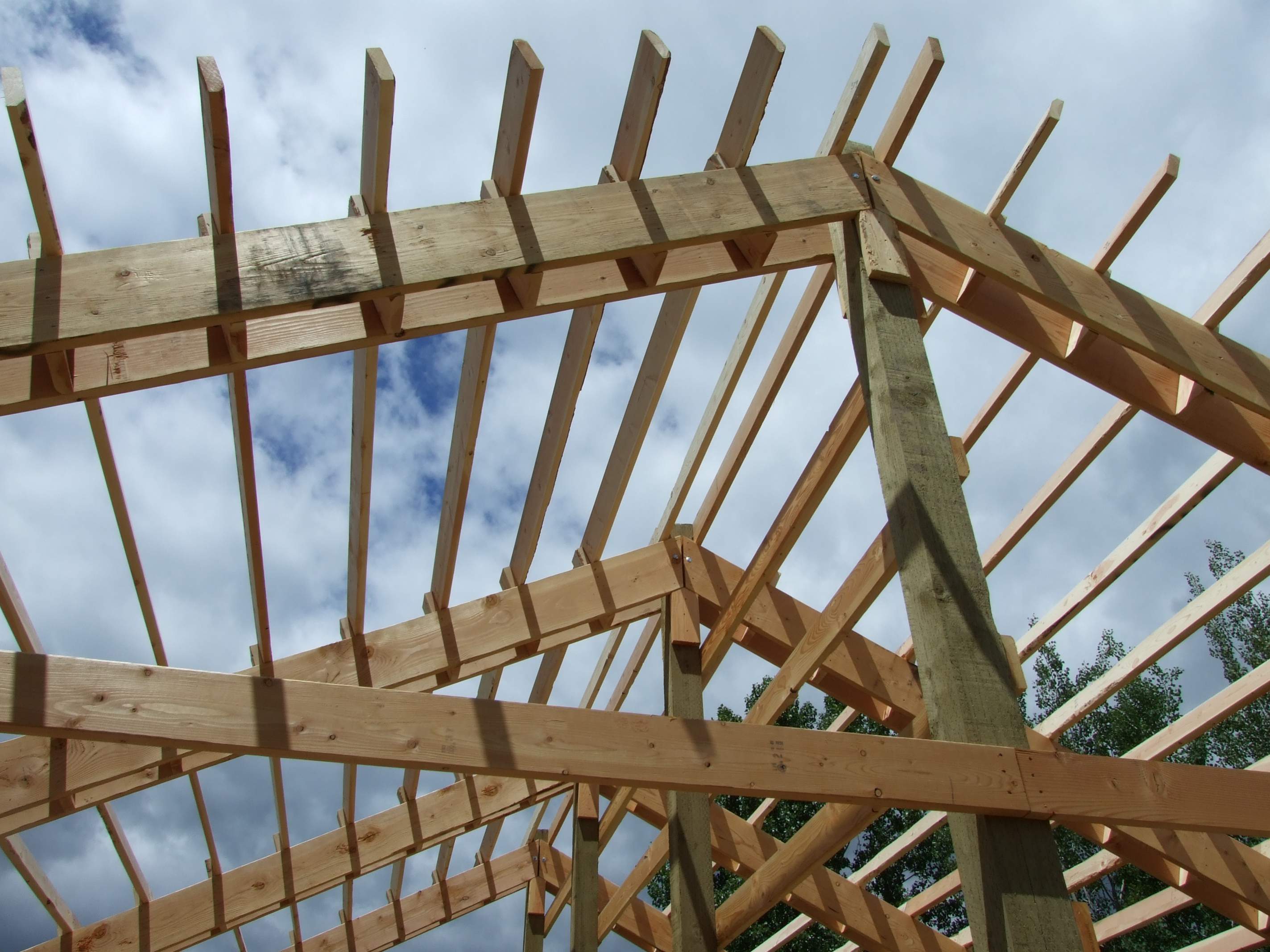

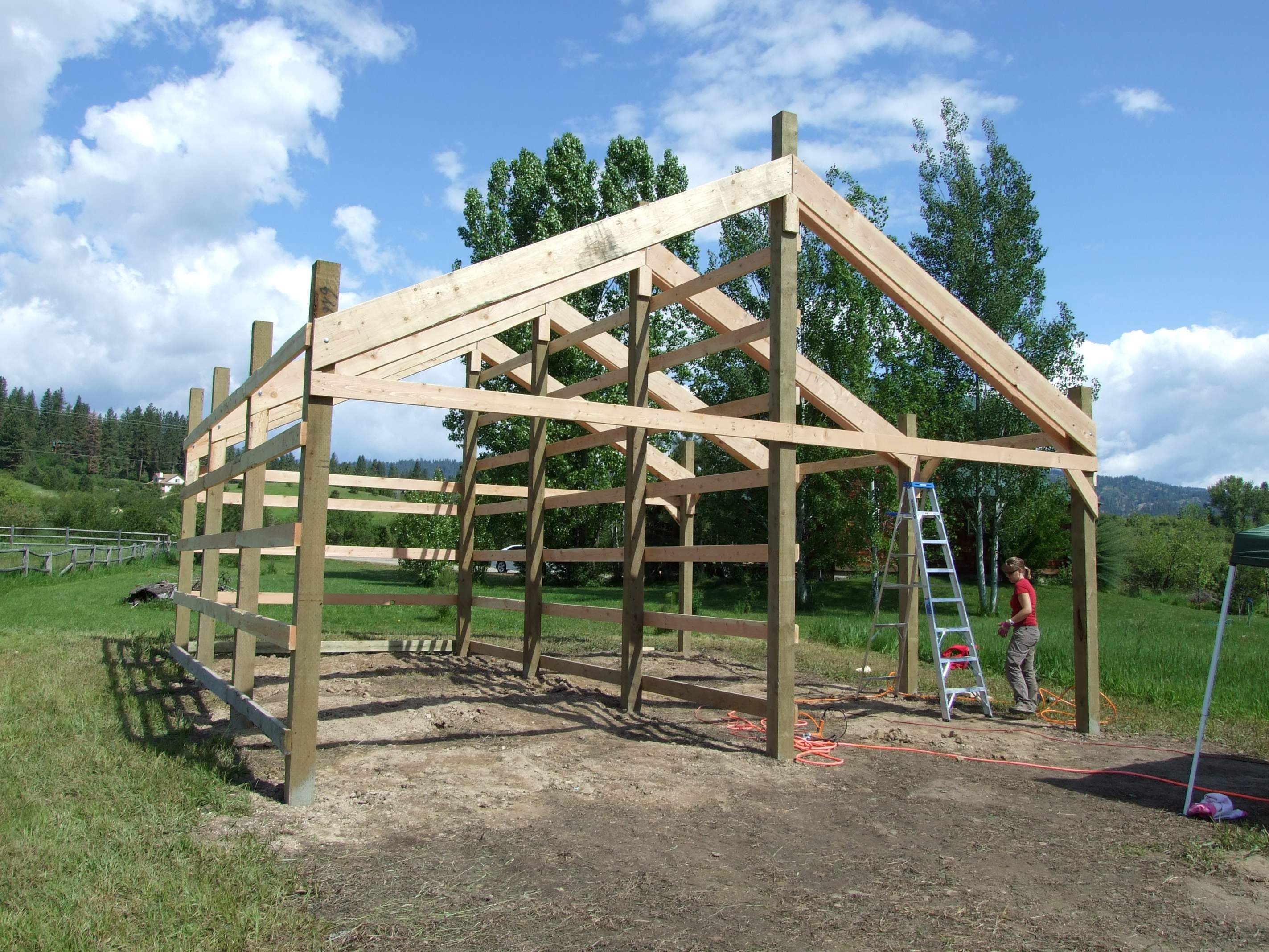

Gable and Window Framing:
The last bit of framing necessary was the gable and window framing. The gable girts required mitering at 63.5 degrees, which was beyond the capacity of our miter saw. So, we marked them and I cut them off with the hand-held circular saw. We had to block behind them to get them nailed flush with the rafters, which was a little challenging due to the small space between rafters. But, a little creativity with temporary blocks got the job done.
I had purchased two used windows that were nominally 18" square. We decided to put them high in the gables to provide a little light without giving anyone visibility to the goodies inside. They turned out to be actually about 17.75" square, so we adjusted the upper girt a little to fit and added some blocking to completely wrap the window with framing. Then we simply nailed the vinyl flange to the outside. It won't seal perfectly this way, but it's pretty close to the roof overhang, we don't get much wind when it rains/snows up there (the valley is rather protected), and heck, it's a shed, so if it leaks a tiny bit around the windows, I'm not going to cry.
This only took until lunchtime on the second day. Here's a few pics.:
Shed Construction 4 006.jpgShed Construction 4 007.jpgShed Construction 4 008.jpg
