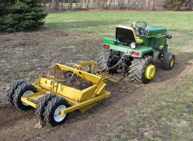

That is doable. Now I need to find a scraper like that! -----------------------------
Also called "Dirt Pan": dirt pan - Image Search
They make really small ones too:
   / Possible New Attachment #45
That's cool X. Didn't know they made them that small.
I know this design as a "Clam Shell" scraper. That's the same as mine.
