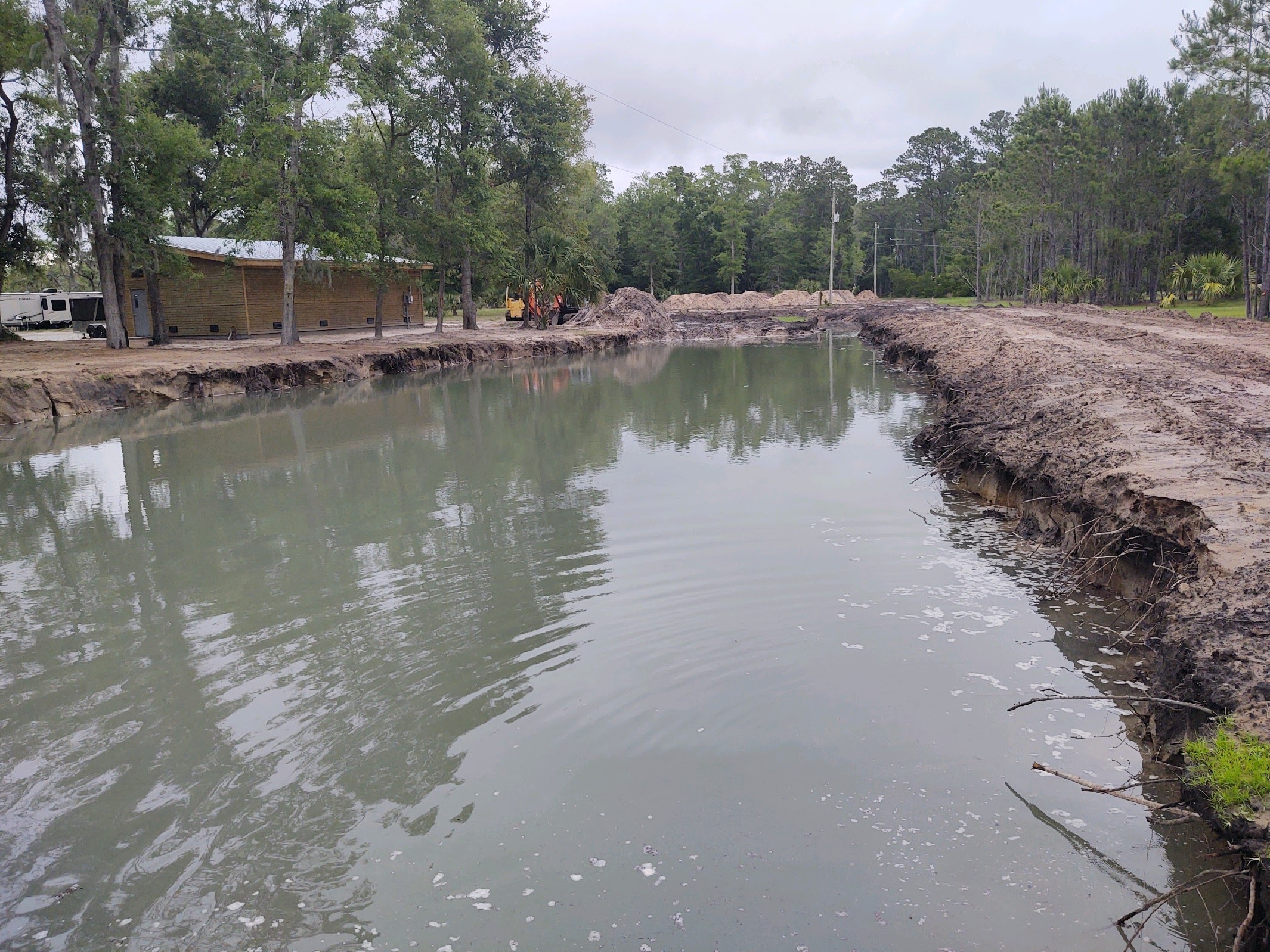

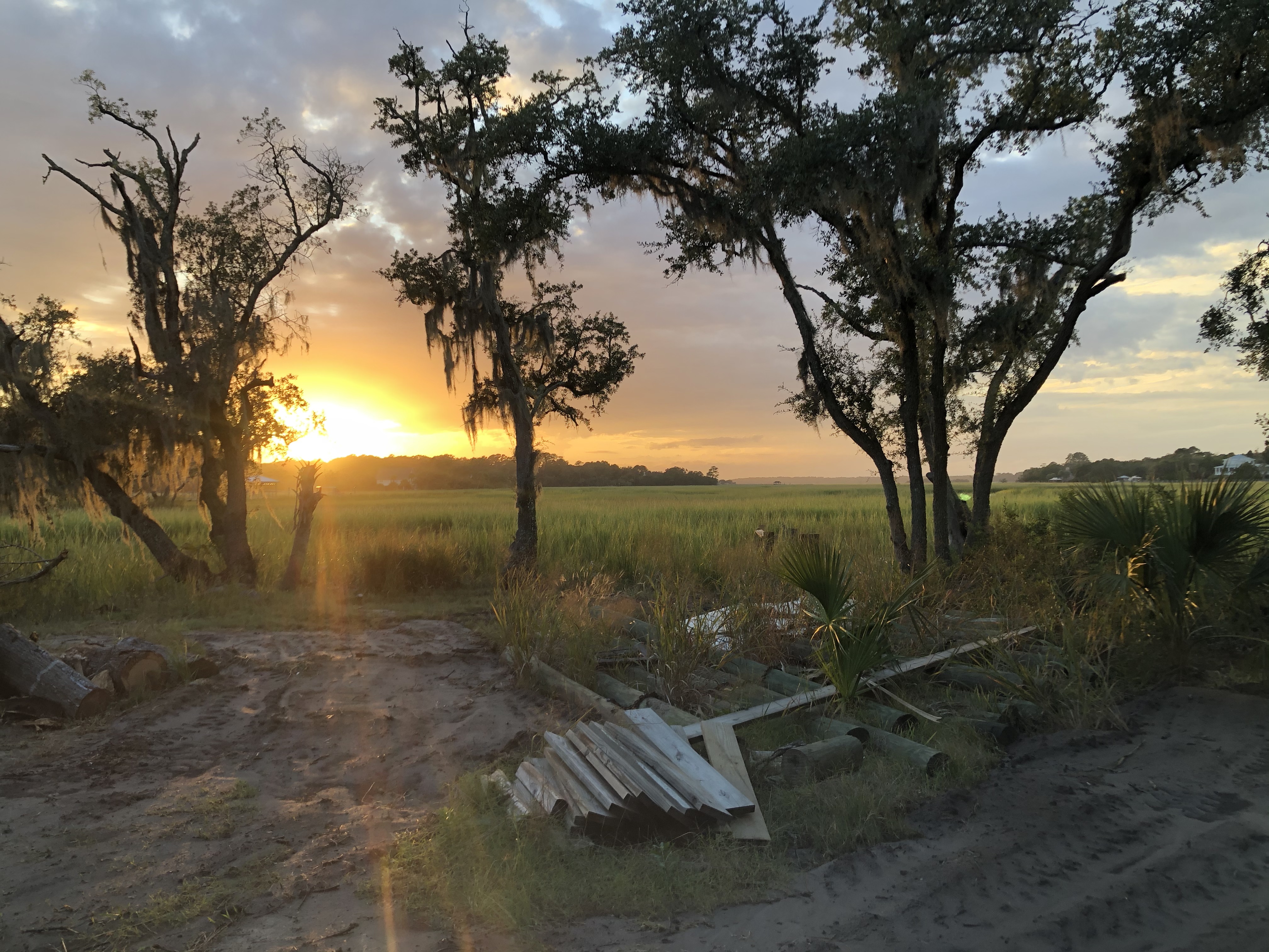

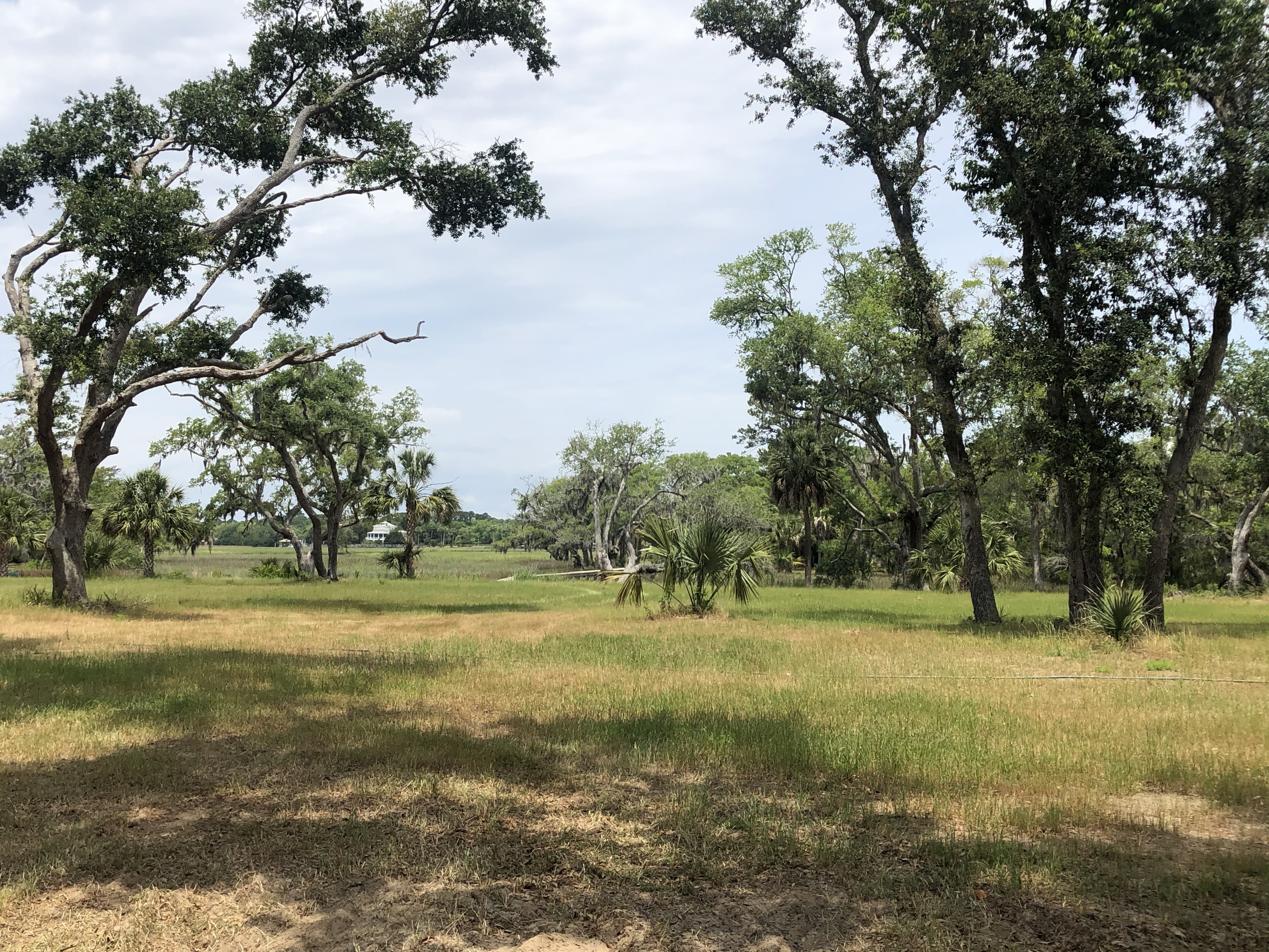

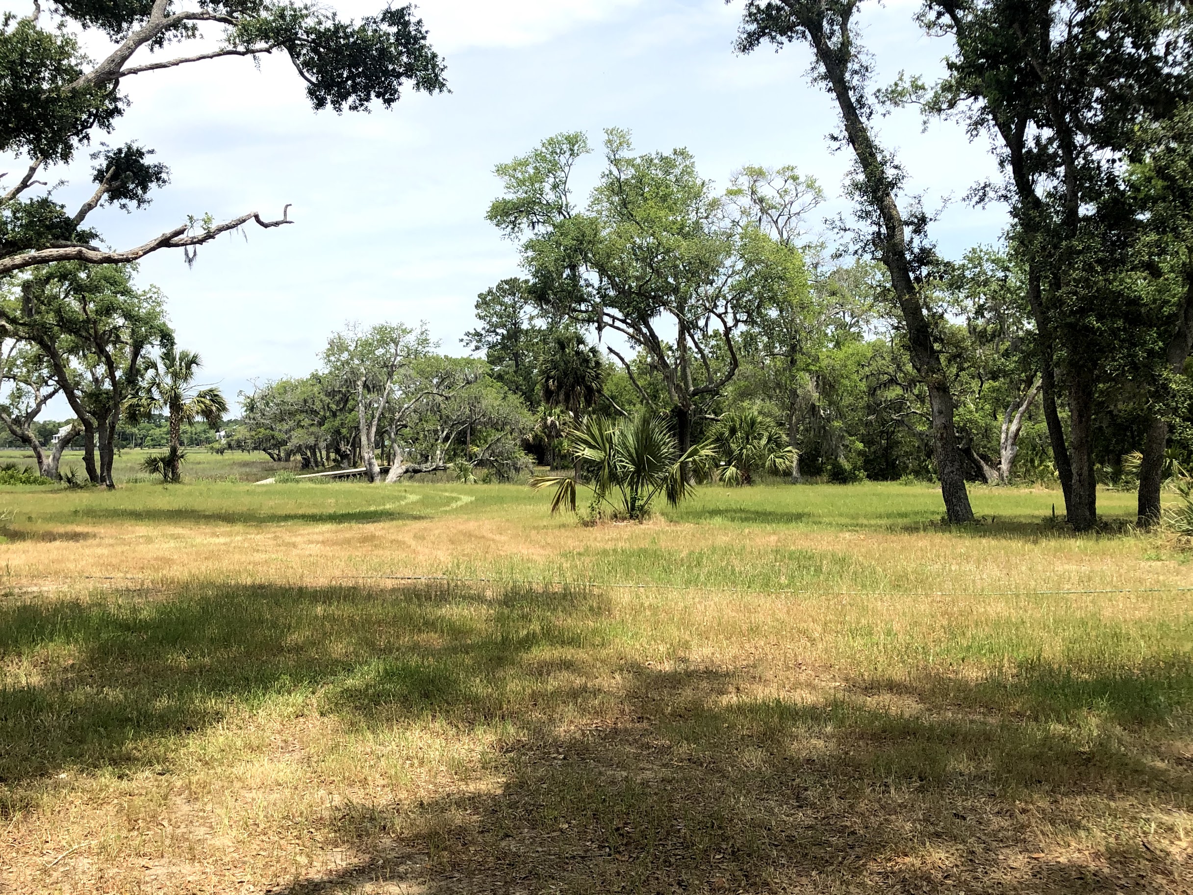

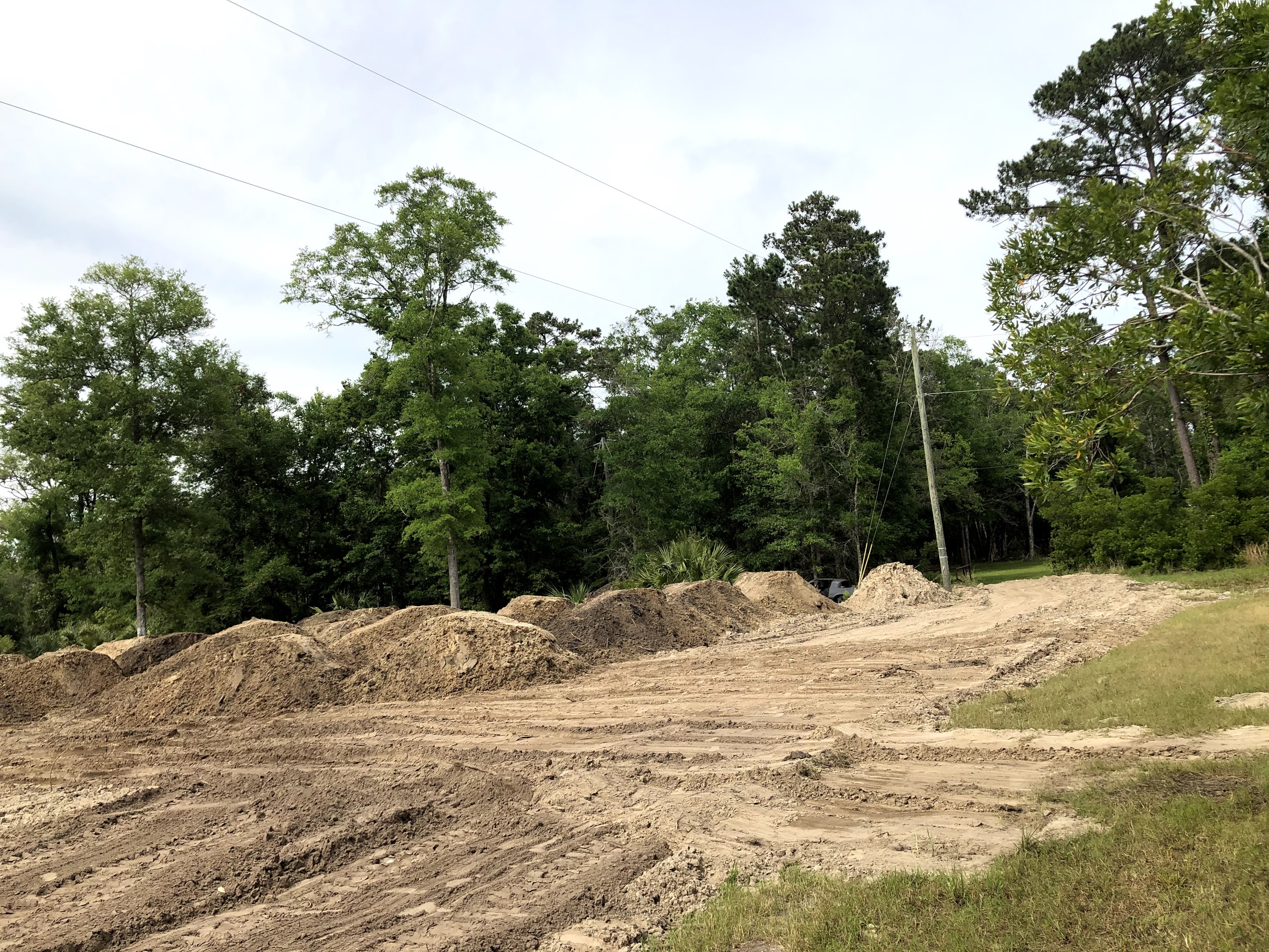

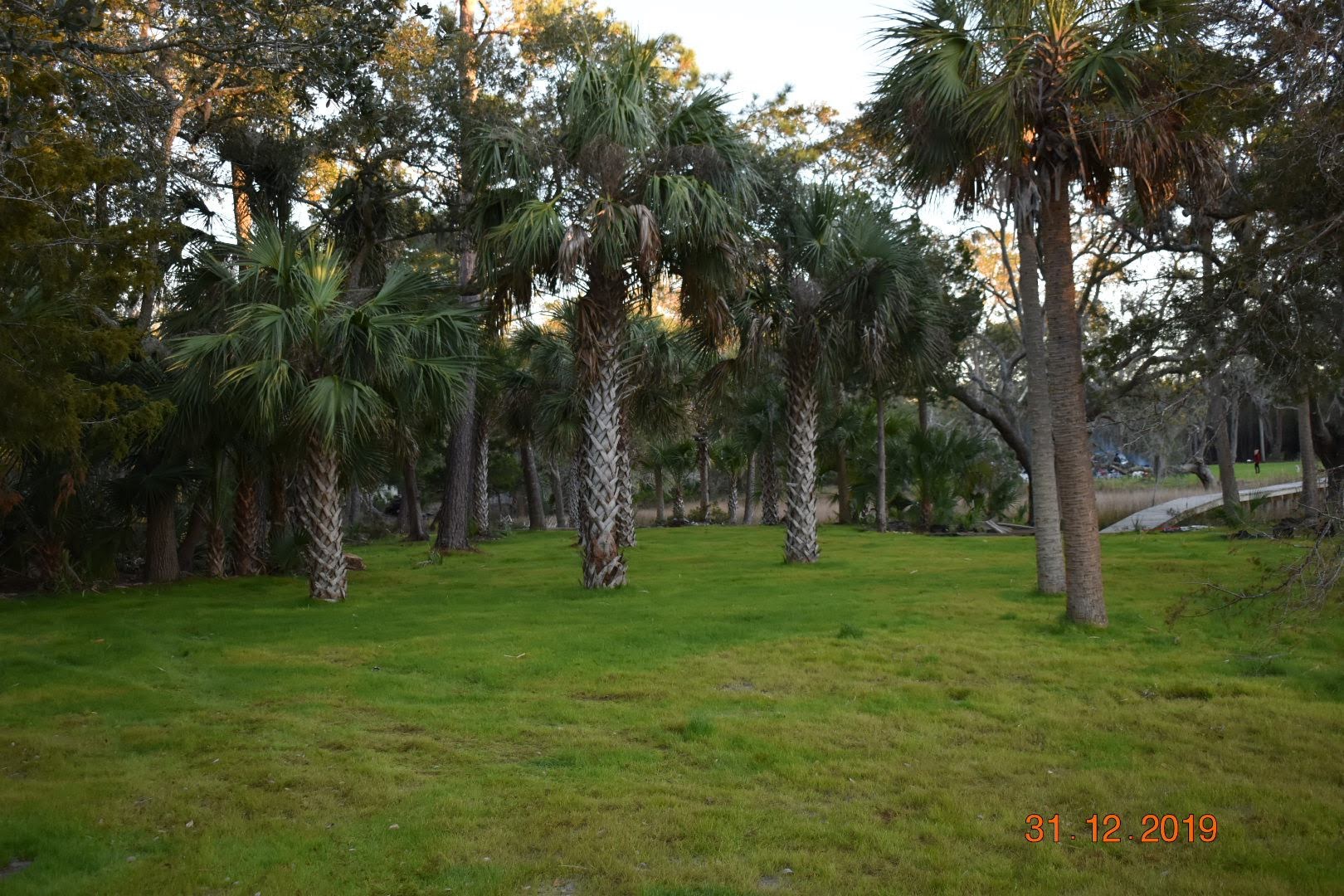

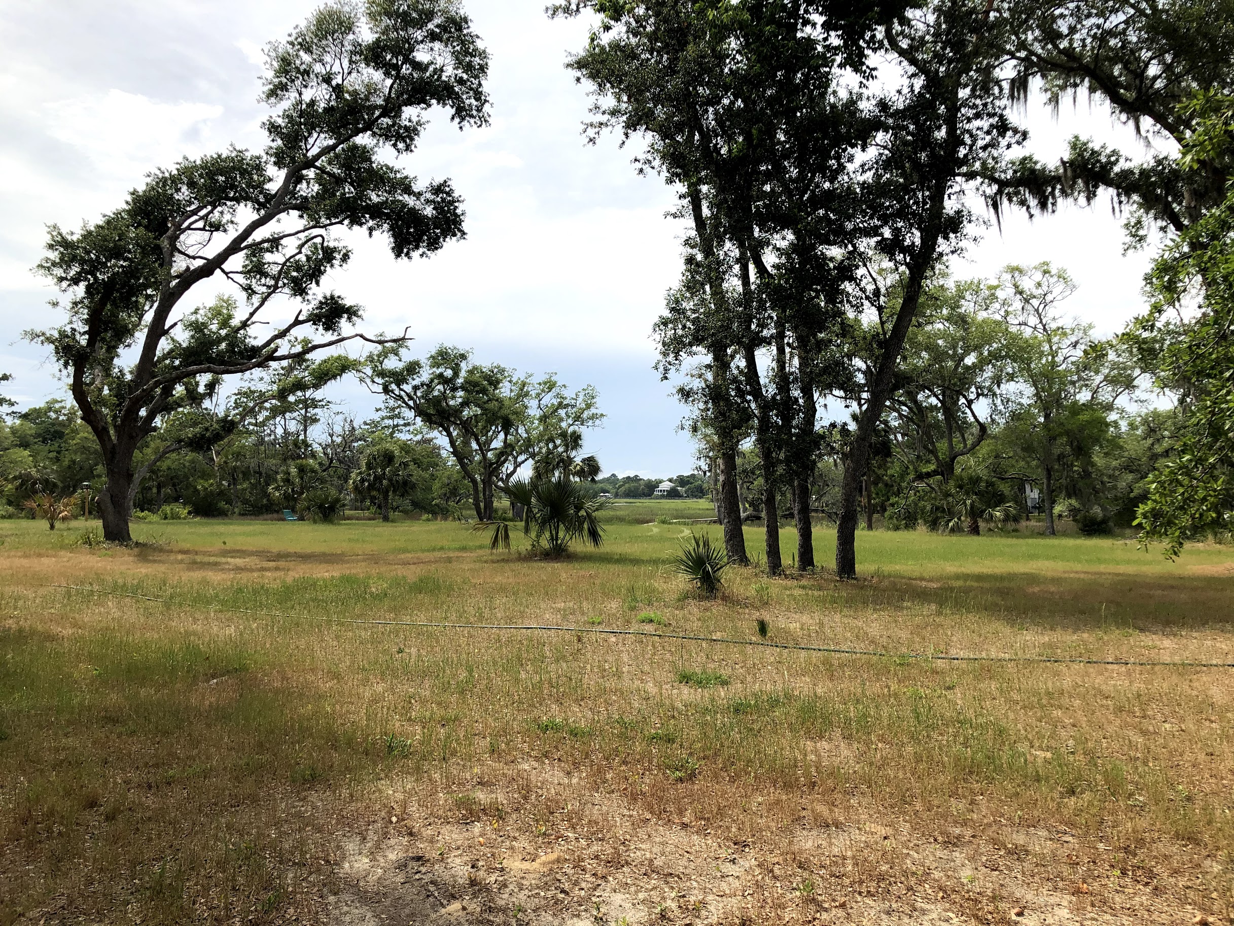

Thanks guys. My tractor is a 2021 Massey Ferguson 1835M. Here is some more information as I know I didn't post enough. I wasn't trying to hijack the thread but I'll quickly lay out the full scenario. I bought some deep water property on the coast. I split off a significant piece to sell to a friend but before doing that, had about 20 triaxles worth of dirt brought in for me to smooth in an areas we had removed trees or that was low, etc. So I did all that and then my friend decided he wanted a pond on the piece I was selling him. SOOOO I ended up with 3/4 acres of dirt about 10 feet high. We moved it from the pond area to the area where I wanted to store it via triaxle dump truck as it was coming out of the pond site.
So fast forward to now and I have one large section of topsoil I want to move over to an island on my property. It has to be accessed by a neighbors gravel driveway. I have a dock walkway built to it for my own access. It sits between the main property and the deep water where the permanent dock is going. The fill dirt can stay on the main property for me to use when we build a house but the topsoil is needed on the island because it had previously had fill dirt put on it and the soil doesn't grow grass well. So that is it in a nutshell. I need to move enough topsoil to cover about 3/4 acre and the other fill dirt can be used however I want on the primary site.

Since we have been given no dimensions of the project, and only have his guesstimate of 50-60 loads, we must assume he needs somewhere around 1,000 yds of dirt. Resulting in 450-500 loads in the trailers he has shown us.
Even using your math of 8 dump truck loads, being 120 cu yds of dirt, he needs 50-60 loads in such trailer.

Excellent information.
So let's assume you want to add 6" of topsoil to 3/4 acre?
43,560 sq ft in an acre. 6" equals 1/2 ft. 43,560 divided by 2 = 21,780 cu ft. 21,780 cu ft divided by 27 = 806 cu yds. 806 cu yds divided by 15 = 54. You need 54 large dump truck loads of dirt moved.
If you had the means to pull a scraper the size of mine it would require 147 trips.
