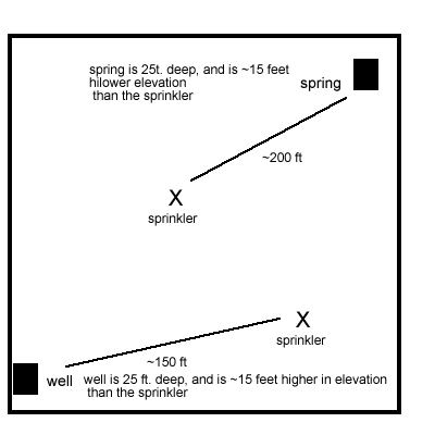

i have a few small fields (~ 2a) that need irrigation. i have water on-site in the form of a dug well and a spring. both sources are clean, silt free and clear of any debris.. the original farmers created an elaborate granite-lined dug well, and setup a nice foundation around the spring.
i'm looking into a gas powered pump that can pull water and distribute (as far as 200 ft) the water to a tower sprinkler unit.
anyone have any advice? i'm looking at a honda portable water pump, they come in a number of sizes based on the water output i need to achieve.

i should clear up my confusion - the 'tower' is nothing more than a raised sprinkler system. it's basically a metal structure that has a sprinkler head on top (i know these things have a name.. shows my ignorance of farming!)
<font color="blue"> For the well, are you saying the water level is 15' above the tower or just the top of the well shaft? If the latter, how far below the top of the tower is the water level?
</font>
the water level in the well is about 15ft higher than the highest point on the sprinker head.
<font color="blue"> For the spring, you're saying you'll need to pump up 15' of elevation, correct?
</font>
yes - the water level in the spring is about 15 ft lower than the height on the sprinker.
<font color="blue">Are you thinking of pumping to the tower then removing all the hose or pipe from the well to the tower or will the hose/pipe remain for the season (or whole year)? </font>
i'll likely leave it in place for the season, removing in winter.
<font color="blue"> How many gallons per day/week or whatever do you need to pump to the tower? </font>
excellent question. not entirely sure.. it's only to supplement rainfall, but i'm guessing that at the minimum it will need to pump 500+ gallons/week.
i'm attaching a somewhat useless map..
thanks again!

OK, I think I have most of it now. I was trying to figure out what kind of head you needed.
That was the easy part /forums/images/graemlins/tongue.gif
You mentioned 2 acres. Based on your original post, it sounds like the tower can spit out and cover that entire area.
On the tower, do you know how many GPM you can push through it?
Here's the issues I'm trying to figure out.
Most pumps are designed to "de-water" an area. It pumps water out as fast as it can.
Your intent is to "water" an area.
If you don't match the output capacity of the pump to all the factors needed to water the area, the pump may get damaged (if you constrain its flow too much and build too much pressure).
I'm no hydro expert but what needs to be figured out is:
How many GPM's can the tower sprinkler push out?
What pressure is needed to reach the 200' distance from the tower?
Both of these need to be matched to the pumps. I did say pumps since you might need a different pump for each water source considering the difference in the head.
Let's use this pump just for an example.
Using the chart on the top right of the page, you can see how the head, pressure and GPM all come into play.
Actually, just below that graph is a link named "Pump Select (Performance Calculator). It's a download so I'll let you do it but it may answer many of the variables.
So, that's about the limit of my knowledge. /forums/images/graemlins/frown.gif Do you have a way you can test what is needed for the tower now by connecting to a house water supply or something? If you have city water with a meter you may be able to test the flow and most plumbers have a gauge that can test pressure.
Brian

i think i found an easy way to determine the pump size, etc.
just spoke with my local dealer and provided all the info (lift, distance, etc.) he said that the easiest way to determine (from his perspective) was to call (in this case) honda directly to speak with their tech staff.
ironically, the honda website provides the info you need.
i need to do some exact measurements tonight to make sure i have all my distances, lift, elevation, etc. correct.
pf

<font color="blue">now that I think about it, won't the path of the pipe/hose be a factor, particularily from the up-hill water source? </font>
funny you should mention this - just got off the phone with my dealer (who spoke directly with honda on the prelim #s i was providing).
based on the #s i provided, honda does not make a pump powerful enough to bring the water up from the dug well with enough pressure to send it 200 ft and into the sprinkler unit.
when the water arrives, it won't have sufficient pressure to water a large enough area.
now looking @ holding tanks, or a professional irrigation system using the spring..
thanks again!
pf
/ portable water pumps.. #13
Since the water level in the well is 15' above the sprinkler it should be simple to start a siphon and gravity feed the water to a soaker arrangement. As long as you don't have to lift the water more than 34', it will work. You won't have enough pressure to drive a sprinkler. But that's not necessarily bad because sprinkling wastes water.
