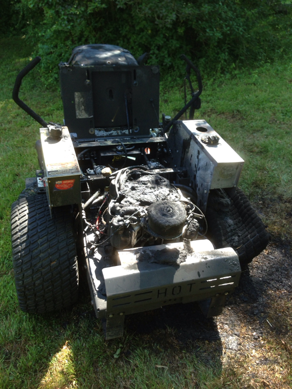

I have all kinds of problems with old gas. I've never had an issue with diesel. Much longer shelf life compared to gasoline even ethanol free gas. And a Diesel engine isn't nearly as likely to burst into flames.
