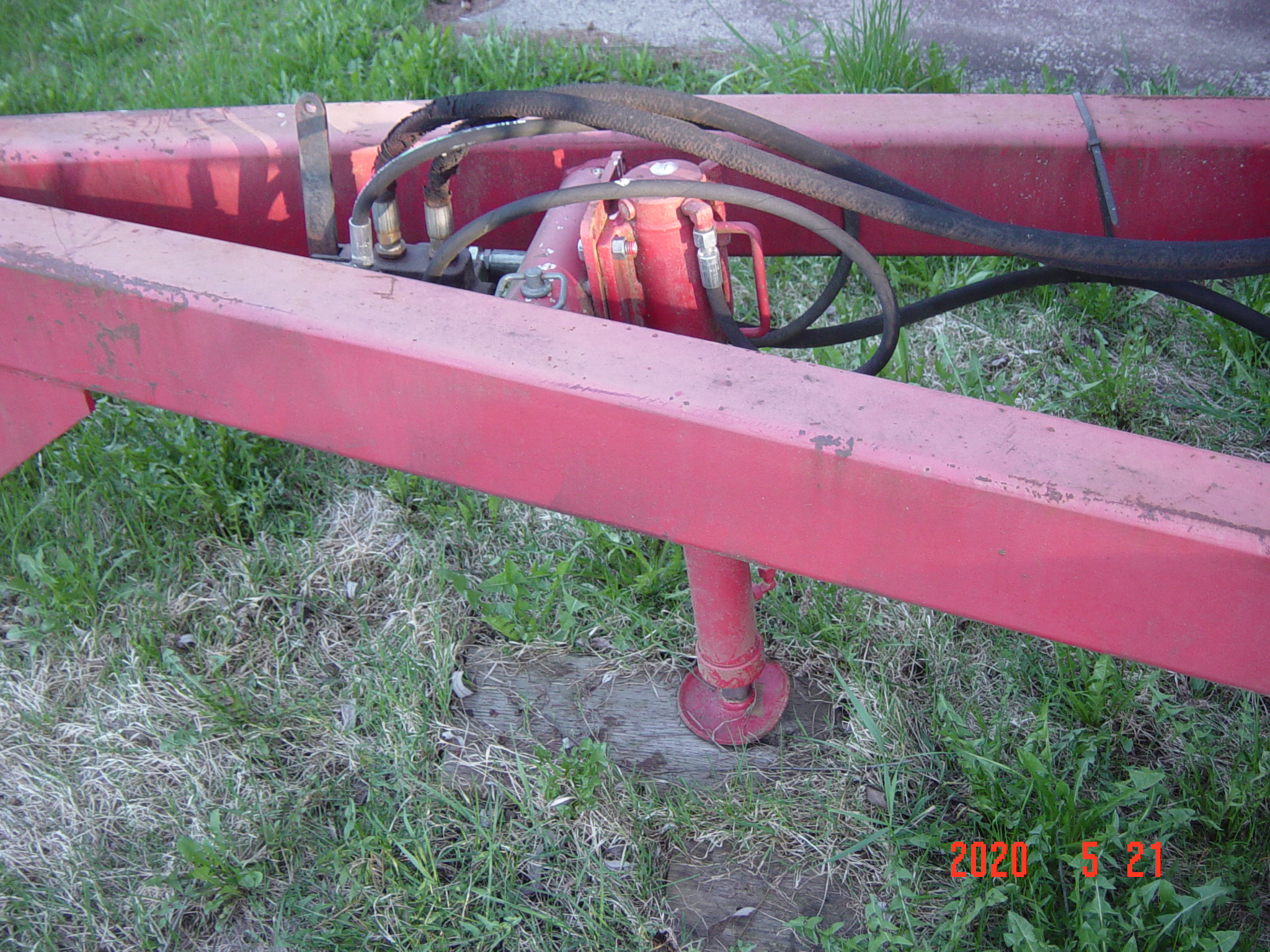

I actually have a hydraulic leg on my BIG off-road dump trailer. Came off a Hyab crane. I put a valve in circuit that switches from the hoist to the tongue jack. Makes hookup much simpler.
DSC00172.JPG Realized I didn't have a picture of this on file and thought it might stir some creative juices.
Tractor has to do double duty pulling this trailer, and pulling a Harley Rake, so it was necessary for me to make the hookup as painless as possible. Being able to raise and lower the jack from the drivers seat is a definite plus.
When connected, a pin is pulled and the jack rotated out of the way and pinned up.
