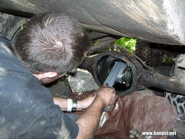

The thing about welding the rear is she's armstrong steering, so I'm very hesitant to do anything that might make it harder then it is... I suppose if I found a 2nd set of spider gears I could always go back.
How about a poor man's locker for the poor man's side by side! :D :thumbsup:

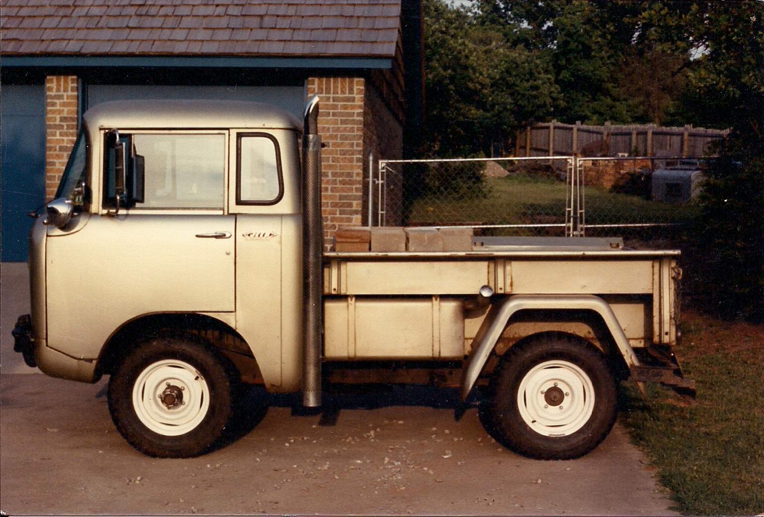

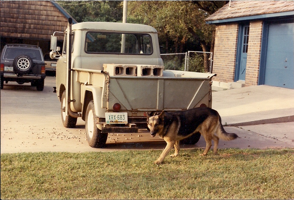

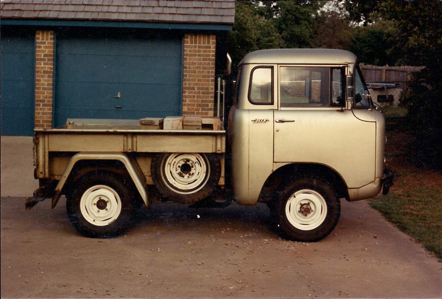

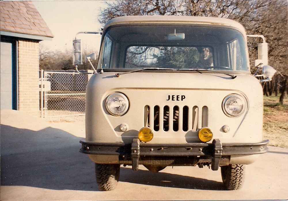

Looks a lot like the welding I did on my "plow tracker" also added a cement block rack in the rear so we could fill the rear all the way up.
