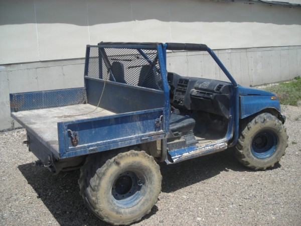

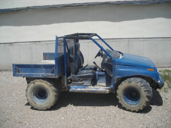

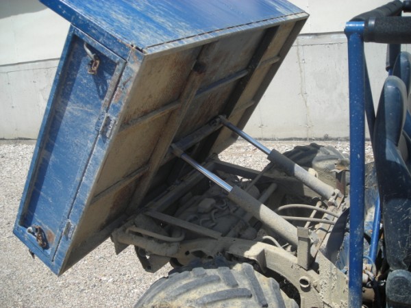

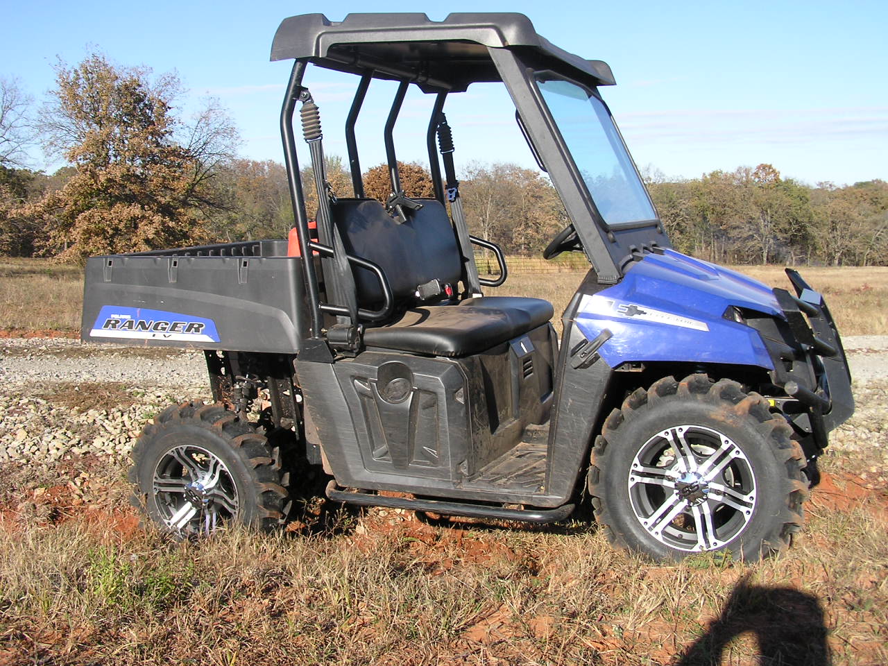

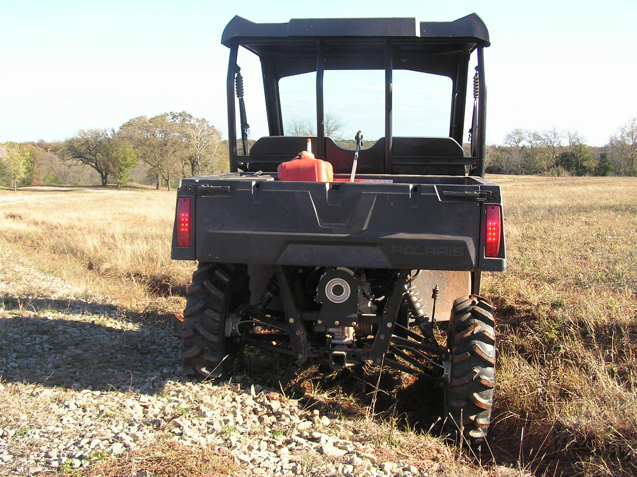

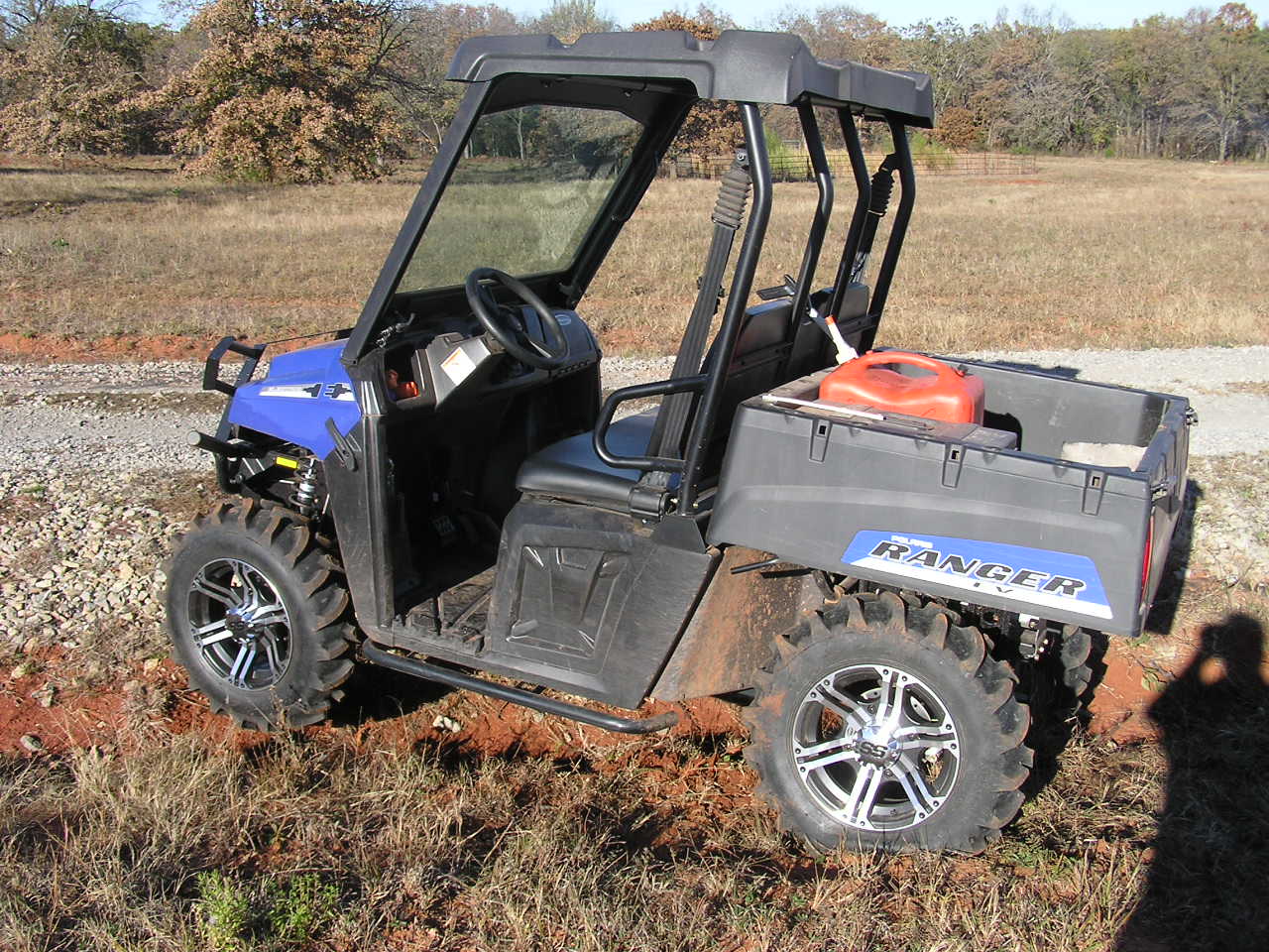

Ya not sure but looks like it probably was damaged, rear ended or?? the thing looks real good tho with the ag tires on it! lol
Mark

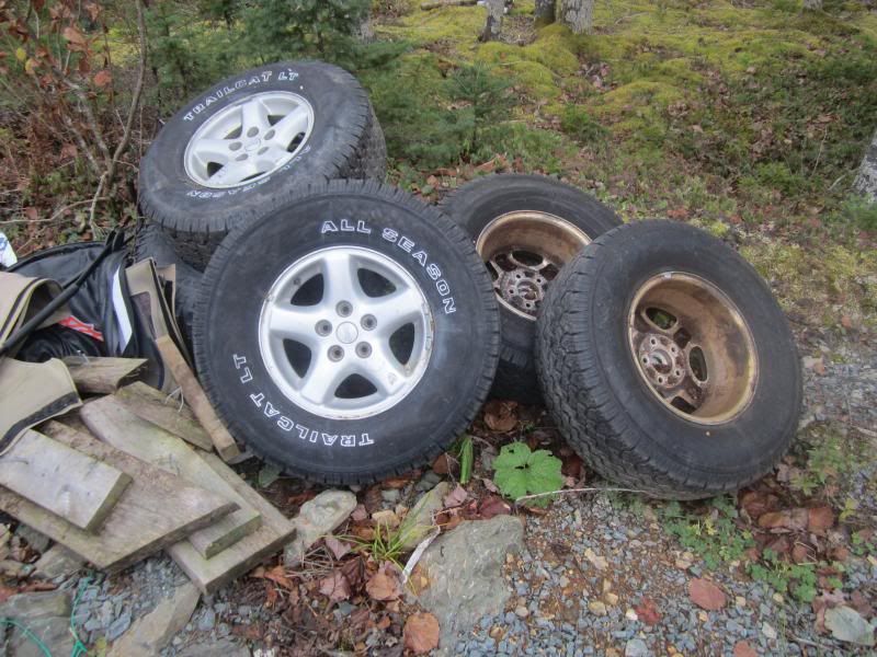

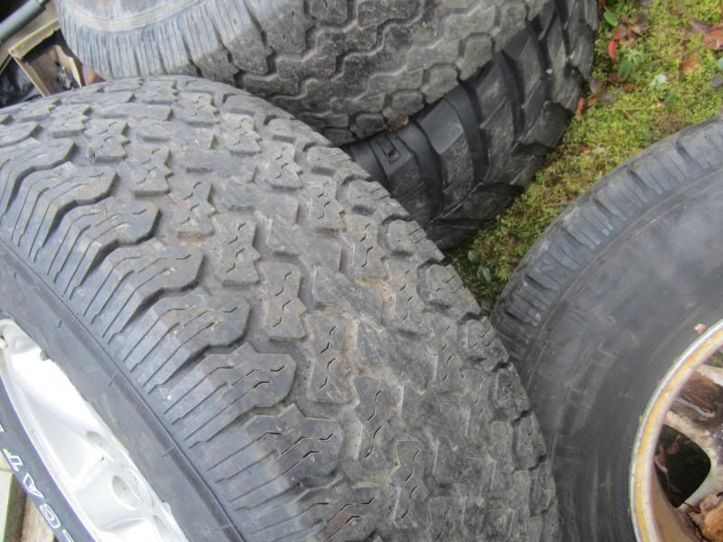

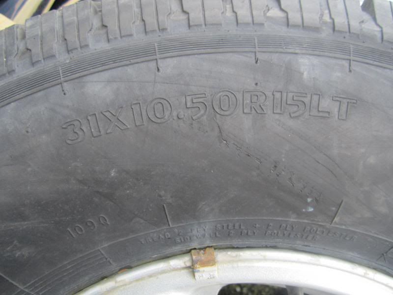

Yep, sure do like the ag tires! :D :thumbsup:
Mine are kinda skinny though. :(
