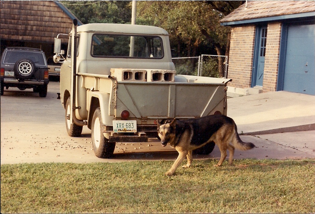

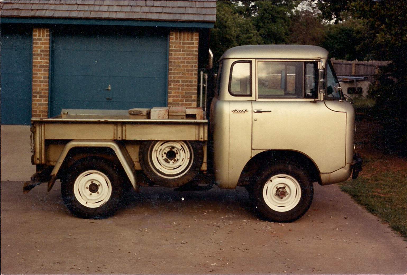

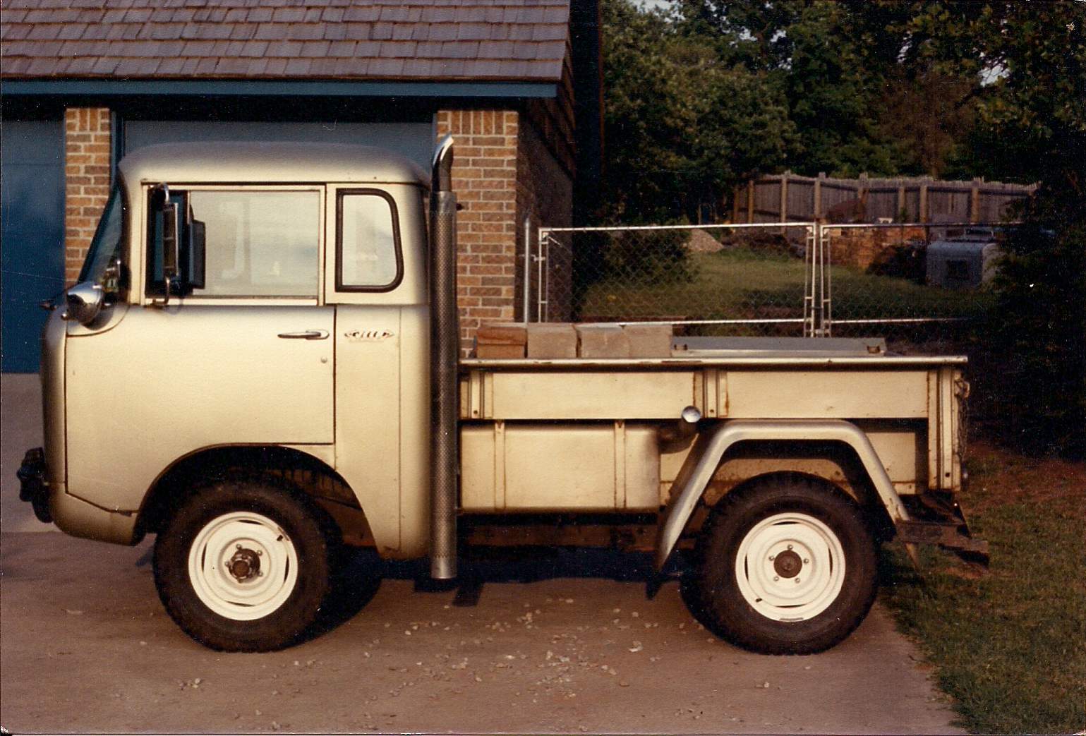

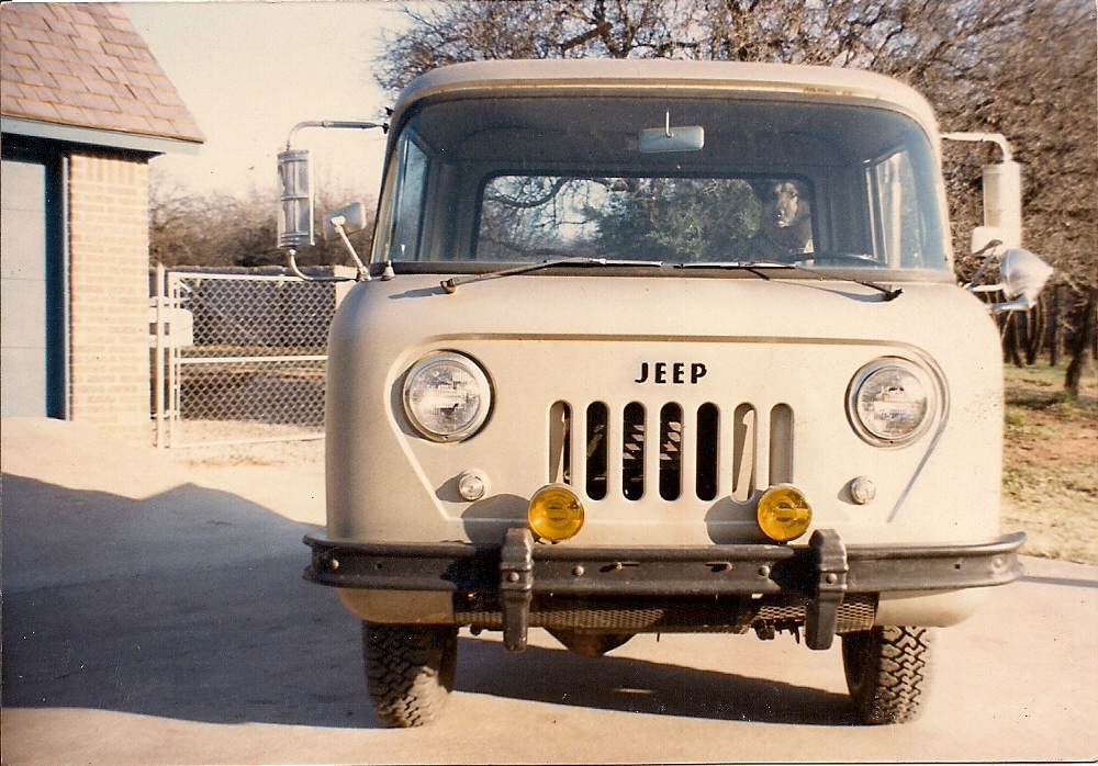

Or you could start with a old Jeep FC150 Forward Control pickup truck, it is already a cabover! :thumbsup:
Same 90" wheelbase as the early Jeep CJ's. This one is a 1962.

I have never seen one of those before, X. Looks cool.
Cabover (or in my case, seatover) is very efficient if you want a small vehicle with a decent sized cargo
bed.

That FC is cool!
Thats awesome :)
Yep, was fun to drive and very useful. With the stock 5:38 axle ratio it would run 55 mph top speed. I installed a Warn Overdrive in the transfer case and it would cruise at 65. Don't have it now, sold it, wasn't running and I didn't have time to work on it or move it here two years ago.
The FC170 with a 9' bed was the other cabover that they made.

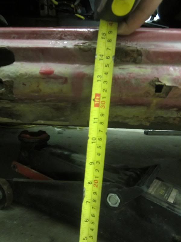

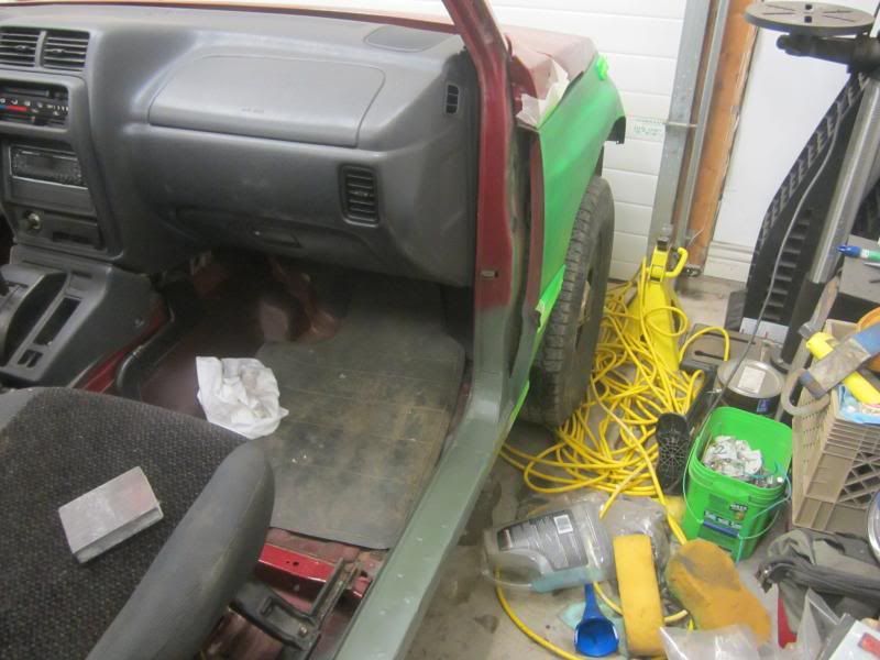

Didn't get much done over the holidays... but started back up on it.
Finished the driver's side sill and floor patches... just seam sealed... paint tonight.
Started on the back... before;
after all the bad stuff cut out;
I found the gas tank leak! Just need to pick up a tube of Goop and patch that up... and I think I have the factory body mounts from the Jeep that I can use to replace the ones I cut out (they weren't touching the body anymore LOL)
Once I recoup from the holiday bills I think I'll pull the trigger on a 2" lift. The front tires bind pretty hard on the inner fenders so I'm limited to about 2/3 steering. I have been having fun whiping doughnuts on the cul-de-sac when it's snow covered (I'll try to get some vid), and driving the garbage to the rd as you can see in the pics. LOL
