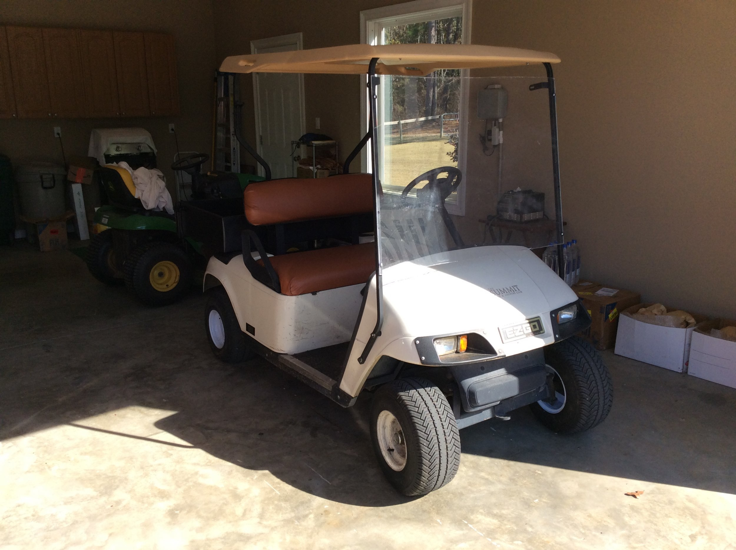

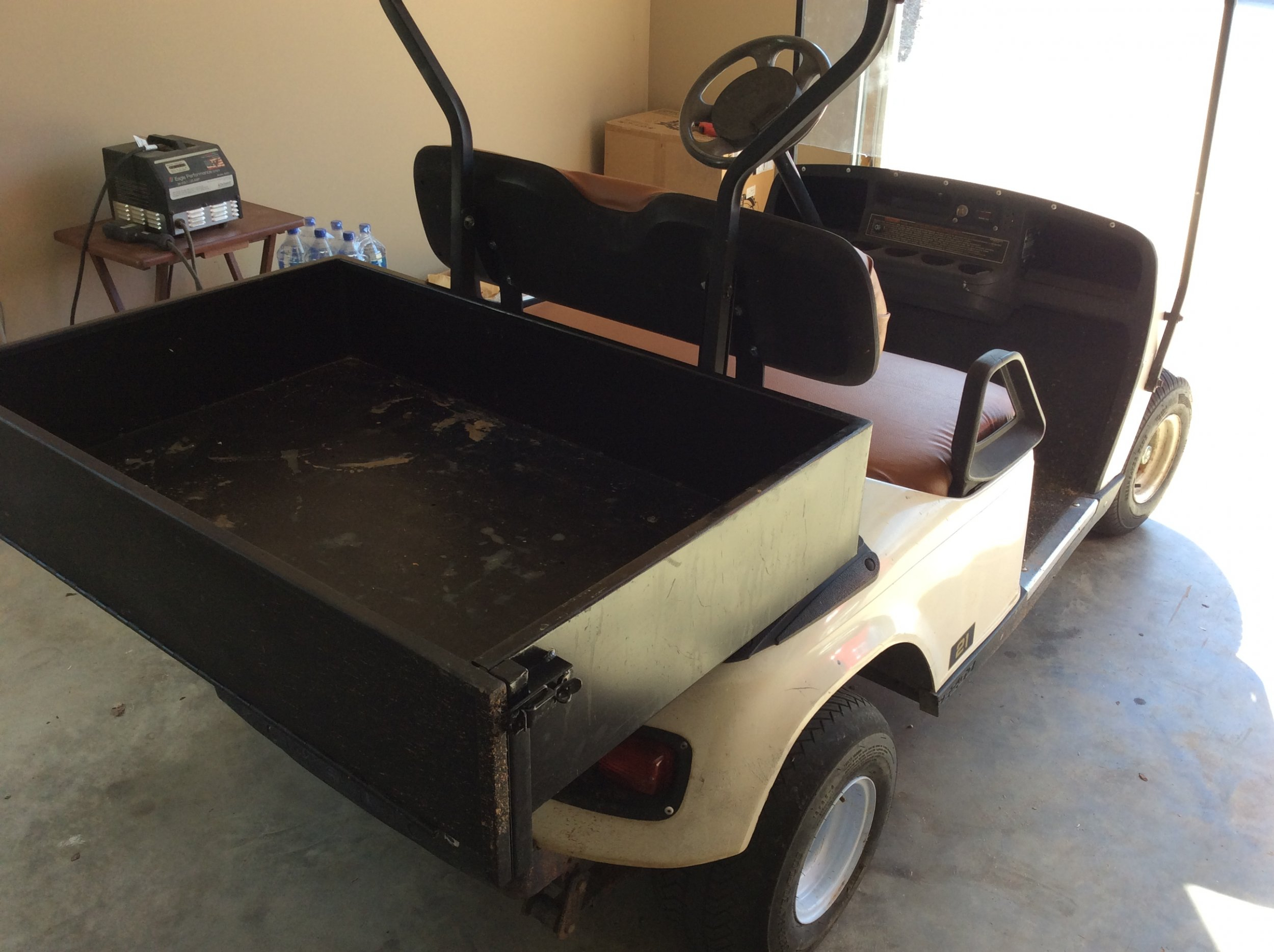

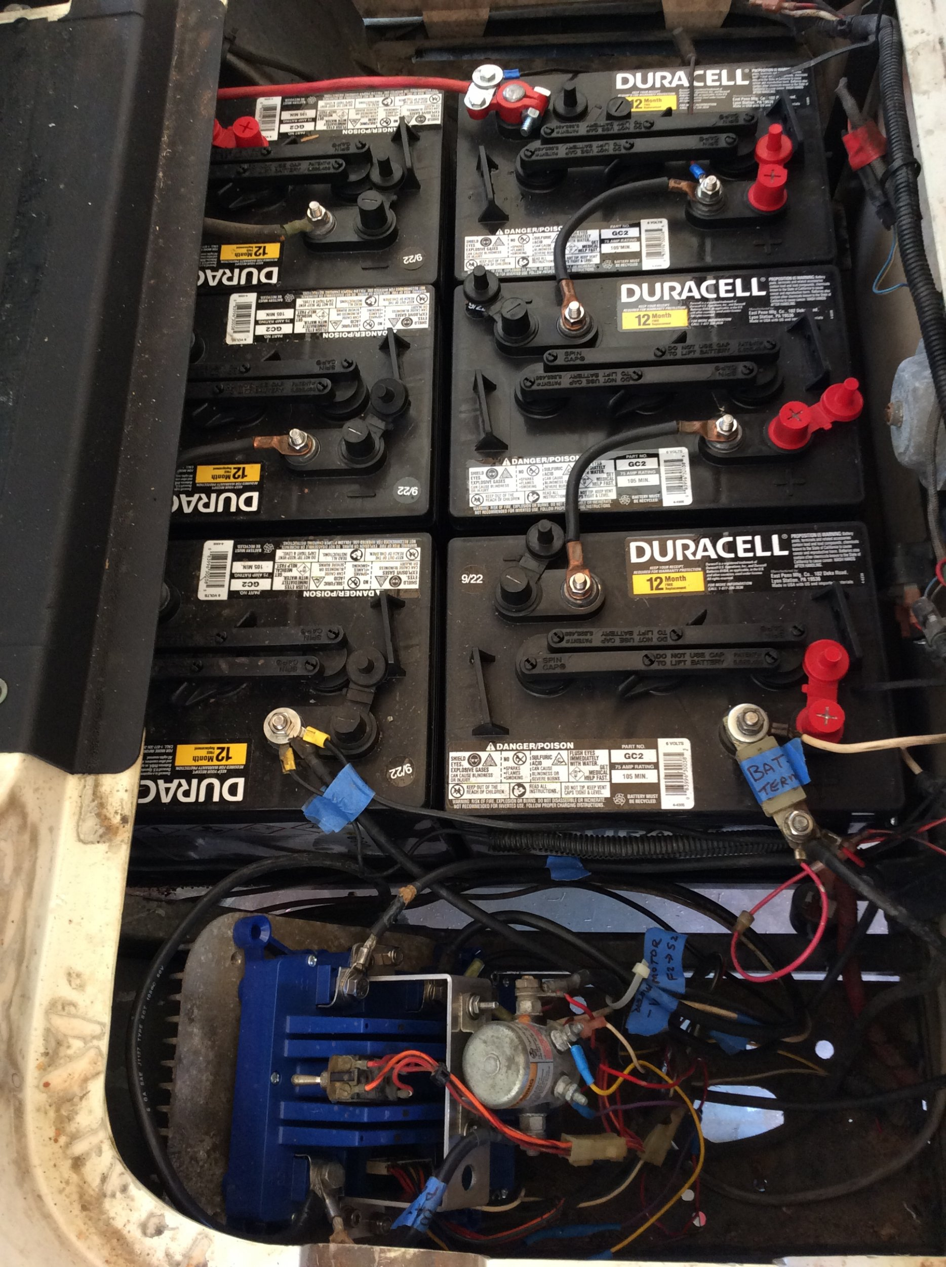

Not really an ATV but friend game me 2 junker maintenance model golf carts that his employer was going to send to the landfill. I was able to clean one up, and bring it back to life with some wrenching, welding, re-upholstery, and a new battery pack, controller and tires.
Had to weld some support structure to the battery pack housing, get a new set of batteries, and a new electronic controller and rewire everything. Re-did the seats, added a windshield, and refurbished the maintenance bed with some undercoating on the inside of the bed and new paint in the bed. Cleaned all the mold and gunk off the entire cart and roof, repainted some of the roof supports, and painted the battery housing after cleaning the rust off of it.
Still need to do a little wrenching on it for front wheel alignment, etc, but overall works great for running around my 5 acres, going over to the neighbors, getting the mail at the bottom of a big hill about 150 yds away, and saves hours and wear & tear on my tractor which used to do these same chores. Really surprised at how fast it is. Almost 20 mph.
Used the 2nd junker to harvest parts like a replacement drive motor, steering rods, wiring harness, and other parts.

Junker my ash! That is a late 90s DCS drive Ezgo TXT. Nice score and with a newer Alltrax XCT controller.
We have been using golf carts for 4 decades on our family ranches for everything from feeding to visiting the neighbors.
Upgrade that solenoid and you should get yrs of service out of it.

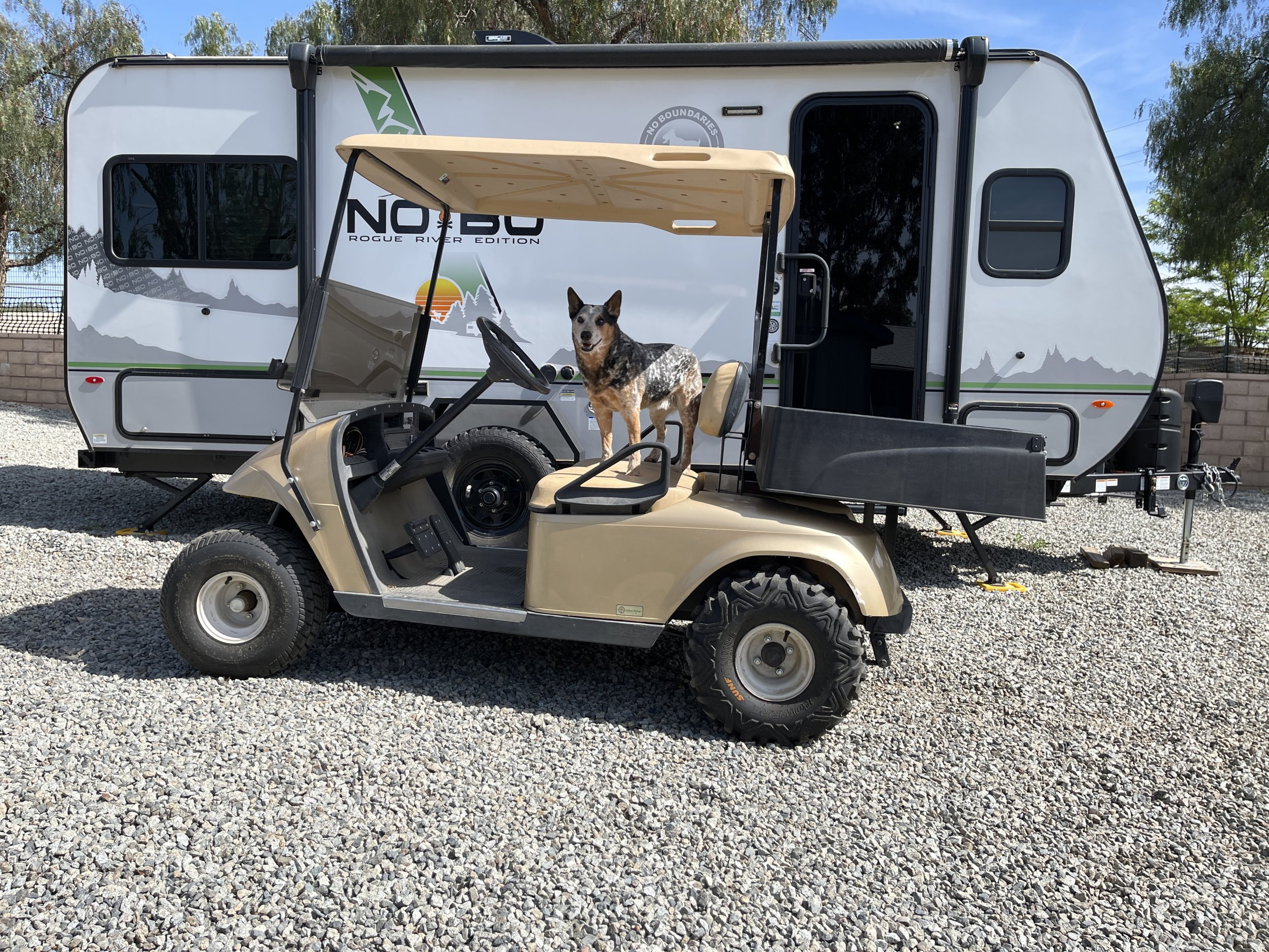

When we bought our house they had a golf cart included. We put a lift on it and added some knobby tires. I put a soft-cab (< 75 on amazon) and chains for the winter. My kids took used it to get themselves on the bus for the last 7 years (1/2 mile drive) and all winter long. V-Chains make it much more user friendly in the winter. Not sure how much it matters in SC. They are useful vehicles and you can add the rear seat with foldable "bed" as well for more cargo. it is like a very poor man's RTV ;)
