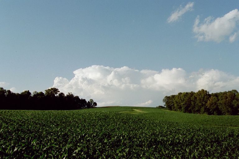

My grass waterways..
Thats all the pictures for today. I will keep em rolling in as fast as I can get them developed.

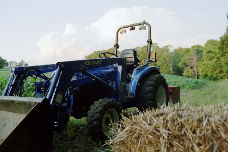

Oops! Almost forgot.. a portrait of my workhorse..

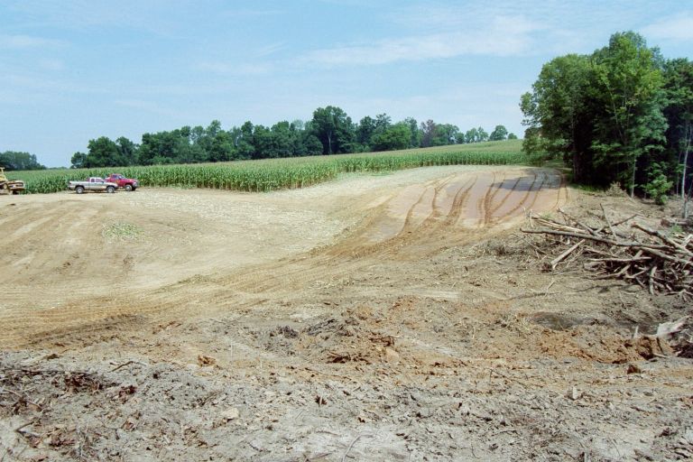

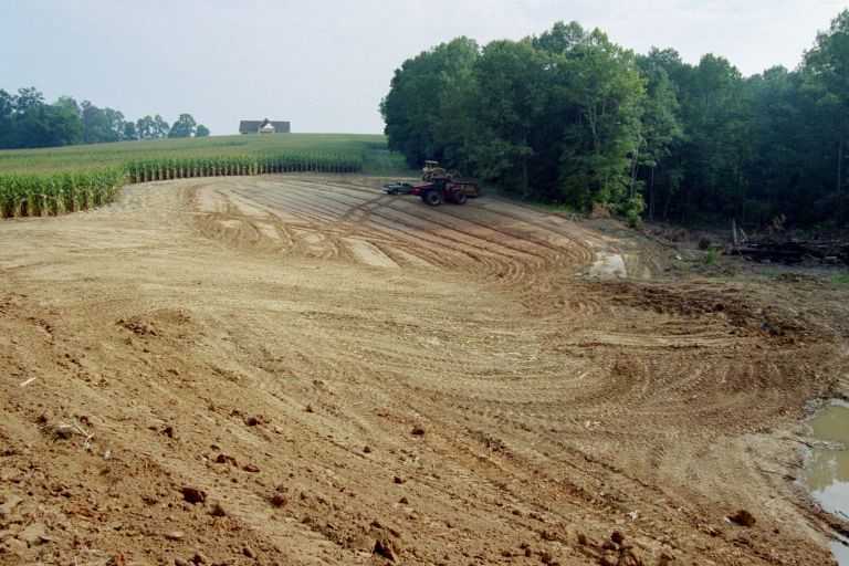

Ok here are some more pics like I promised. And there will be many more to come. Here is the dam about 3/4ths of the way done.

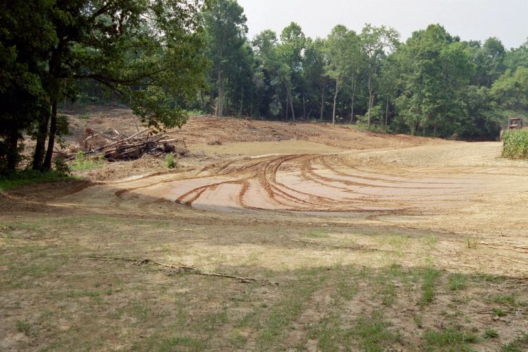

Distand view of the pond about 3/4ths of the way done. I have a lot of brush to burn in the middle as you can see!! Actually as of today, I have over 1/2 of it burned. It was a heck of a job because most of it was green.

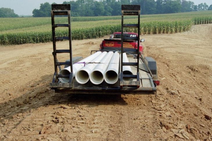

Here we are getting ready to install the spillway pipe. Man WHAT A JOB that was! Probably the hardest 8 hours of work I have ever done in my life. The pipe is 5 20ft sections of 10" schedule 40 PVC. Very heavy. We used the trackhoe to set it in. Installing the 1/2" steel anti-seep baffles on the pipe was the hard part.

Closer pic of the pipe.

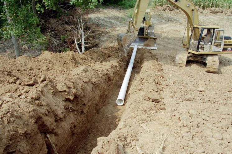

Laying the pipe in.

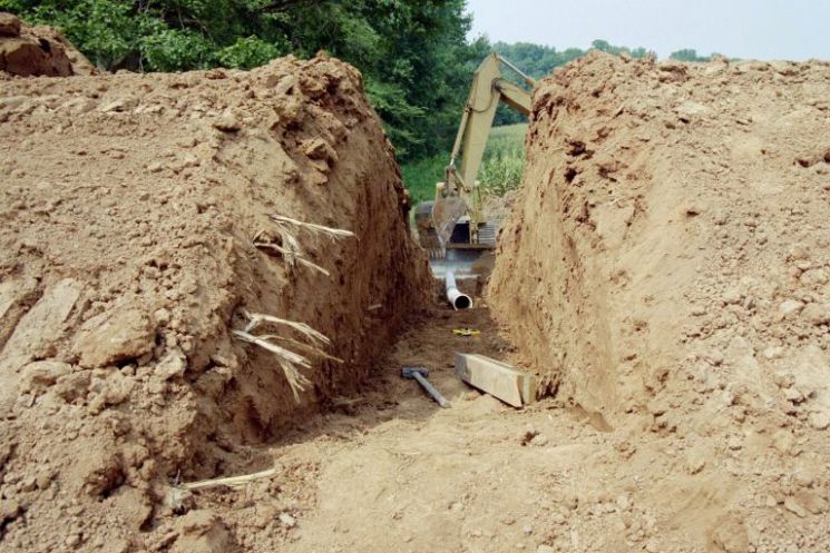

#35
View looking through the trench.

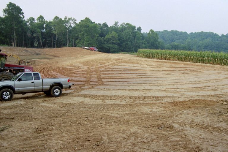

Another view of the pond with my dads new house being built in the background. My wife and I are building a log home on the opposite side of the property, just on the back side of the new pond.
