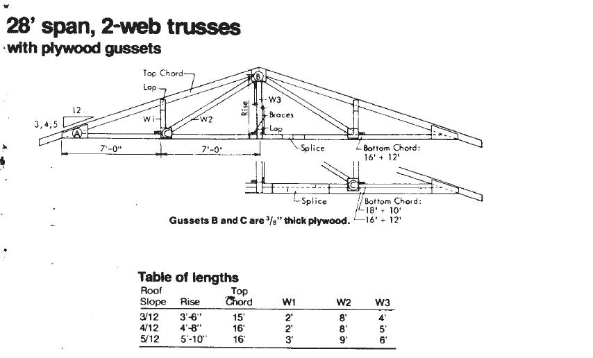

I am sure everyone has seen these truss designs by Midwest. I don't understand why it is saying both 4/12 and 5/12 use a 16' top chord?
Any problems with this design using 2x4x16's? 24" on center?
  • truss_28.pdf

4/12 pitch the top chord is 15'10" or use a 16' 2x8 and BANG your done !!
/ Pole Barn - Why not use center post? #49
I'm sorry ... you will have to calculate the webbing and layout the plywood gussetts ...
/ Pole Barn - Why not use center post? #50
4/12 takes 15'10" and a 5/12 takes 16'3 ... they may be holding the 5/12 in on the bottom web ... on each side, I doubt it ...but they maybe doing it to save from going to 18' lumber

I was wondering about using 2x4 lumber to build the trusses as attached in the drawing above ?
I looked @ a roof rafter calculator and your numbers seem correct - 16' will be a little short for 5/12

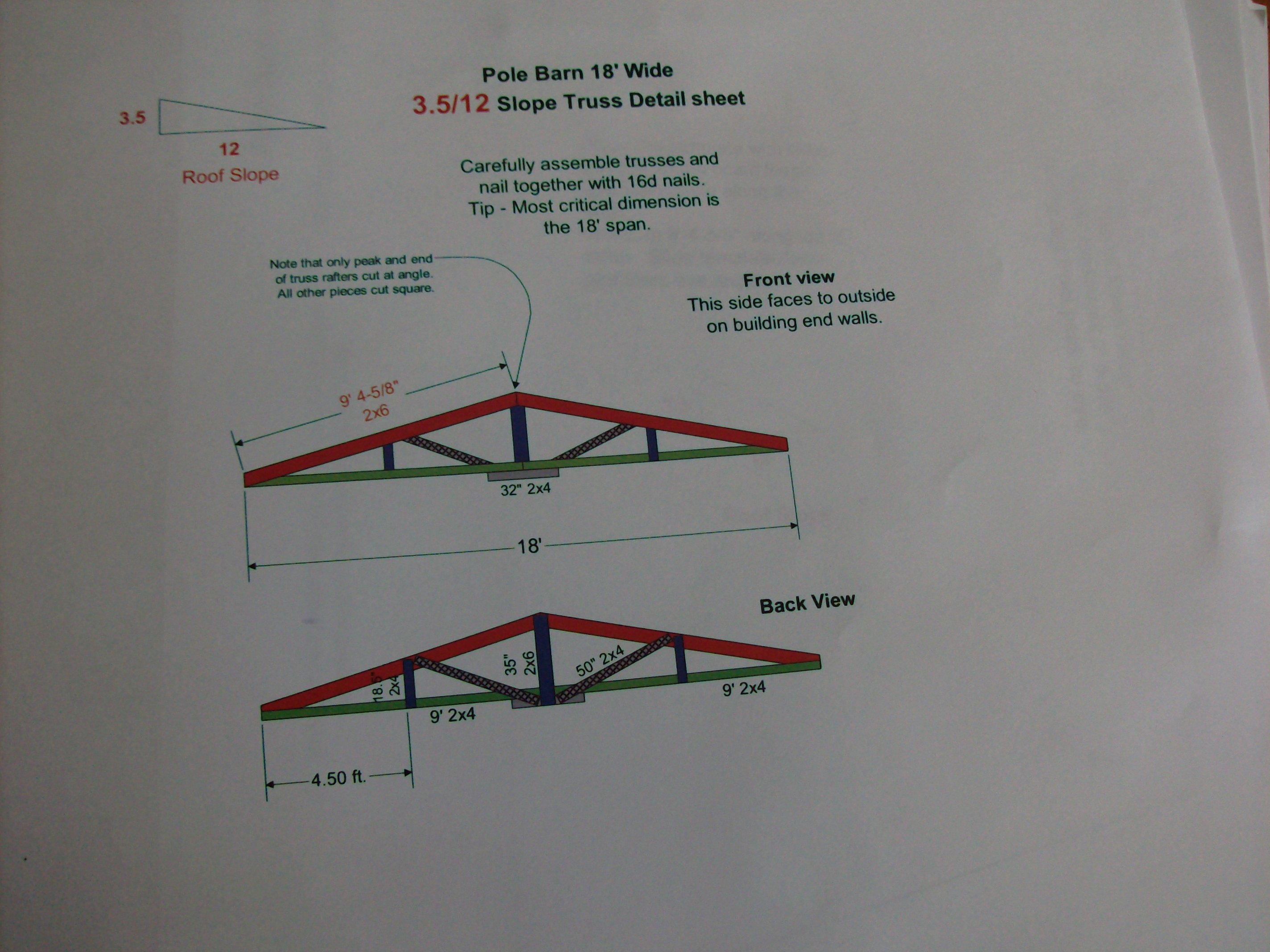

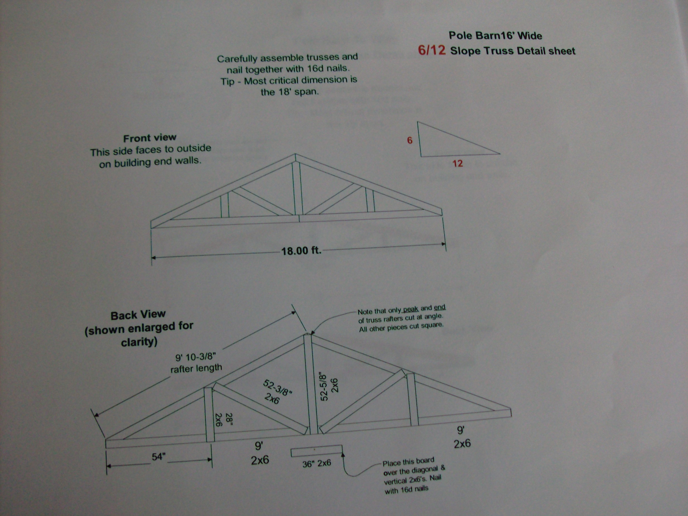

Hopefully the pictures help i could not send them from my i phone.By the way i changed the design a bit.
/ Pole Barn - Why not use center post? #60
There ya go ... I guess the webbing doesn't have to be angle cut and use plywood for a gussett ... just cut them to length and nail them along side the top and bottom chord.
