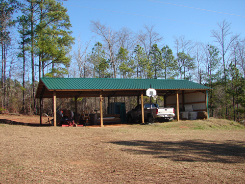

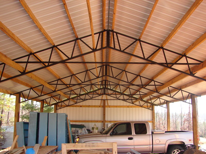

#12
Alchemysa,
That is ectually another option I have been considering. ArmourMetals.com is about an hour from me. They sell these kits using metal trusses. You can purchase the metal trusses for around $230. Options - options..
