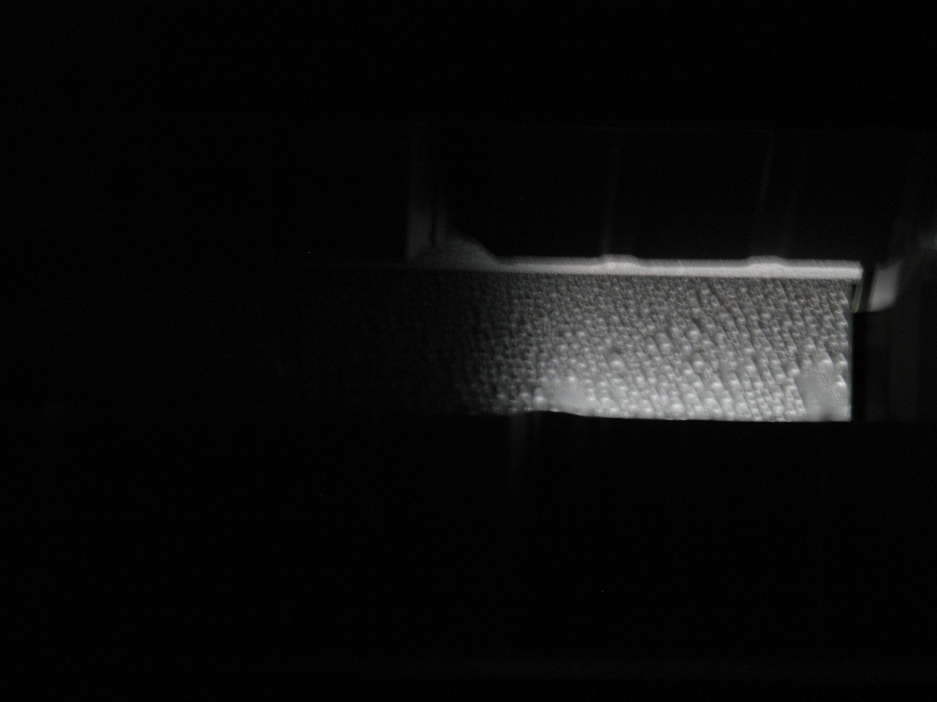

Well, it looks like the builder is going to make it good. They offered to remove the slider, replace the siding and install a roll up door at no cost to me. Still waiting to hear what they plan to do about the condensation issues. Hopefully they will take care of that also.

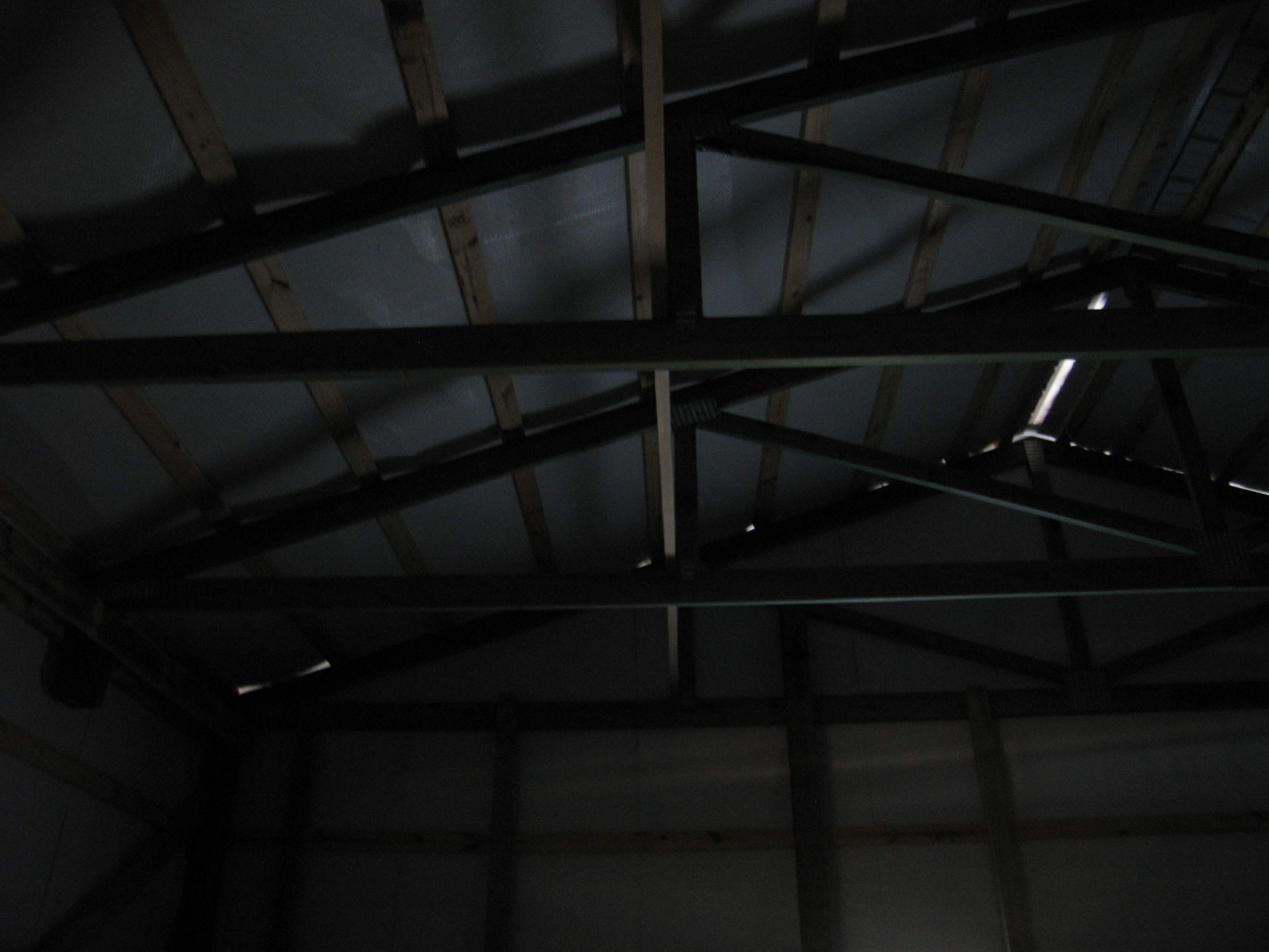

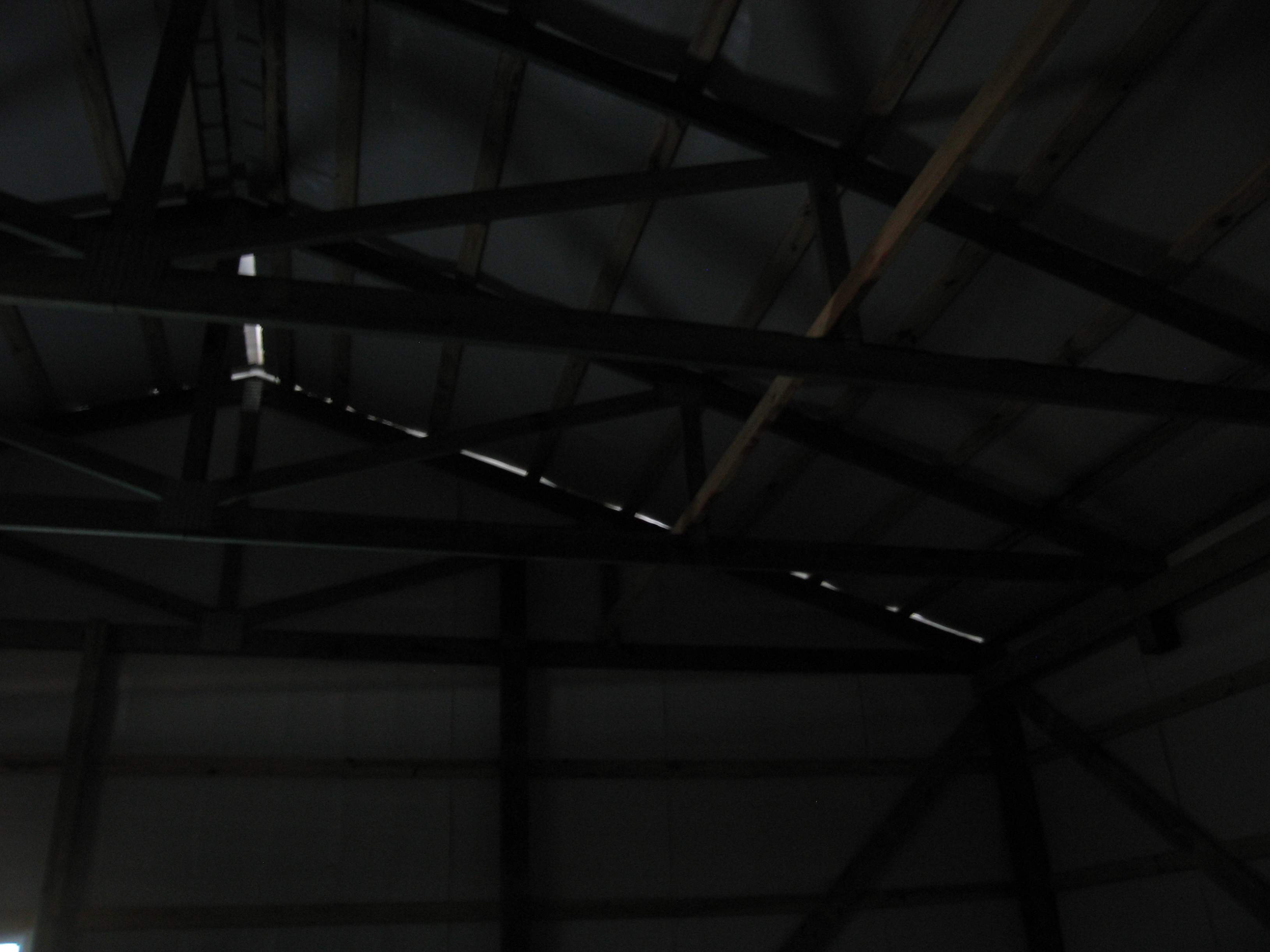

Did they say anything about the gaps (missing vented closures) in the roof. What good would insulation do with it like that.

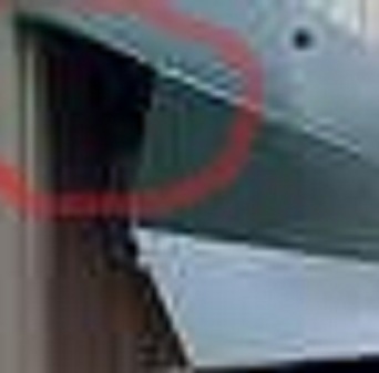

Im pretty sure that top track cover piece should be behind the siding so the water rolls off the trim and not behind it like they have it now... Hanging steel isnt a science but can be tricky at times and you need some knowledge! J channel corners are confusing to some the first time you see it done. Same with the overhead door trim.

Well, they sent out another crew to take care of everything. The pulled the sliding door and the existing metal off and replaced it. They installed the roll up door and installed most of the missing vented closure strips under the ridge cap. Unfortunately that didn't have enough to finish off the ridge. There is about a 2' section at one end that is still missing. These guys did a much better job. Now all I have to do is get the ridge closures completed and I will be good to go.
