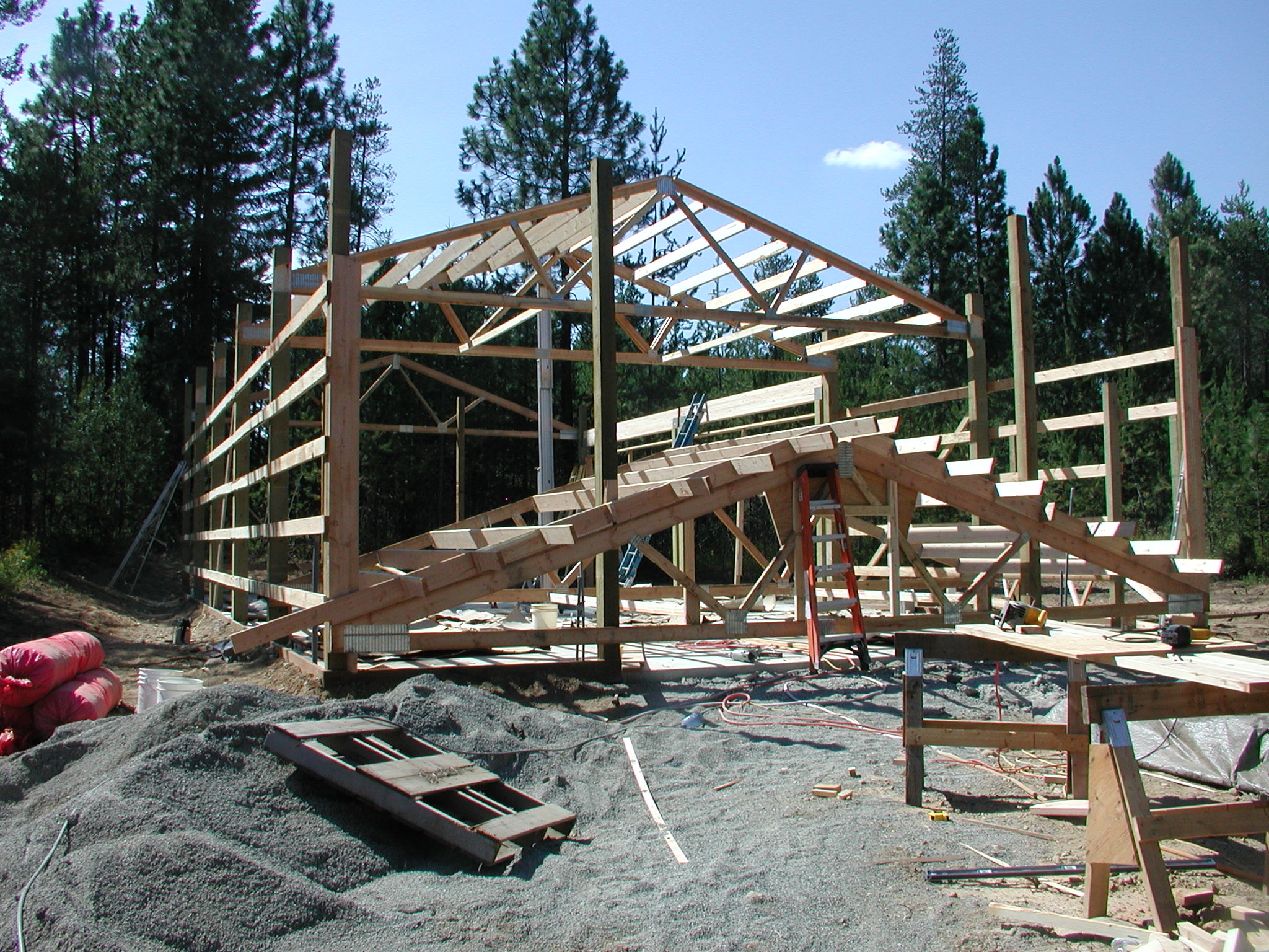

Pole barns in my area are not taxed like a garage with a foundation is.Plus they are alot cheaper to build.I started mine in september and had the roof shingled on october 31.That was all done by myself after work and on weekends.I had a head start when i built the trusses in august they were made from 2x6's.I did 4ft deep holes 6in gravel in bottom tubes with concrete i used 4x6 posts 2x10s one on inside one on outside 2 1/2in bolts through the posts and 2x10s for the trusses to set on and 2x4s for truss ties.After i started putting up the trusses i wished i went with rafters.All in all it was a learning experience and very enjoyable.The siding and floor will go in this spring after i get my hernias repaired.Also received alot of advise from my neighbors on what works here,and their barns are still standing after many years.

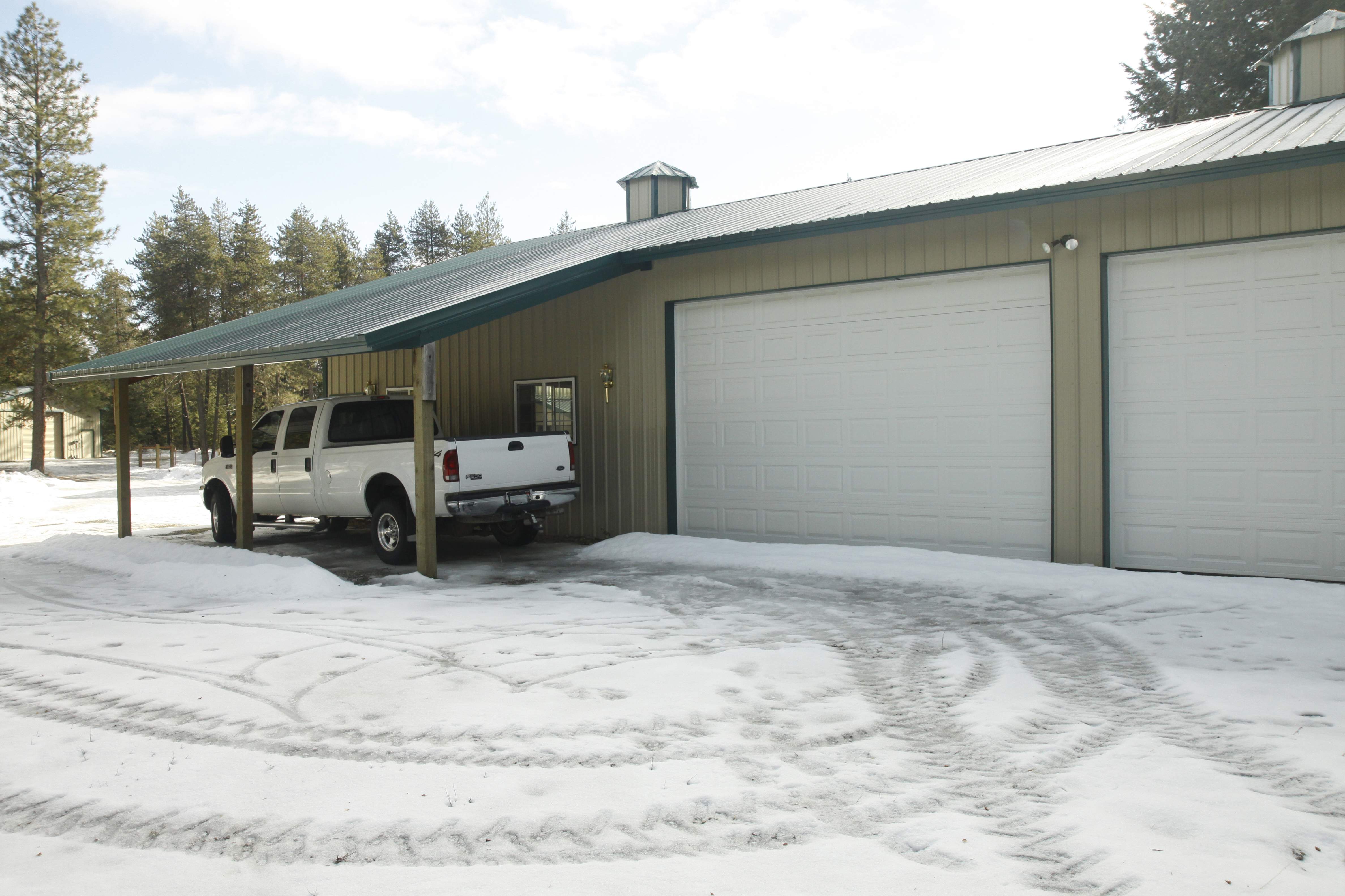

i have 6x6 and 6x8 treated post stuck directly into the ground 4 feet deep. my barn has been up for 12 years...looks new still. not sure about pole protectors...not sure what they are. treated lumber has been shown to withstand rot. our ground here is all decomposed granite, so water doesn't pool. i guess if i had standing water i might think of some other form of protection for the posts. the only thing that does erk me is the movement of the 6x6's do set off some minor floor cracking in some areas. i dont think that a simpson tie would hold up the shear forces of a barn. ive used those on lean toos attached to regular buildings, but never to a free standing building (my 2 cents)

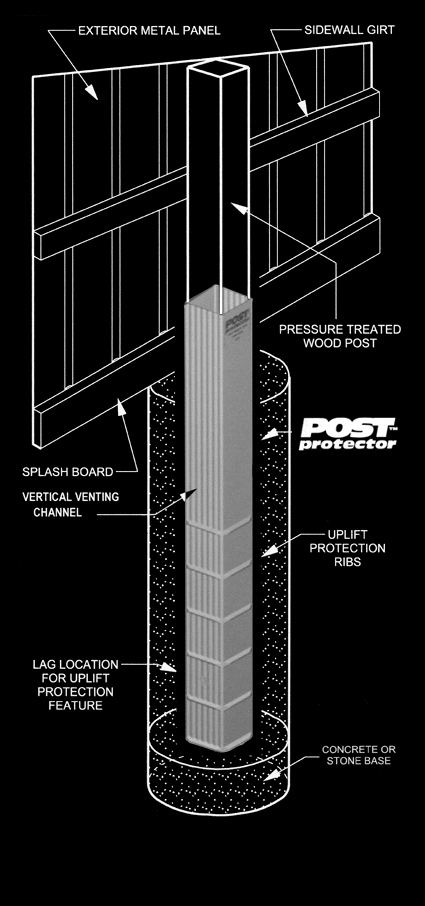

I recently had a 30x40x12 pole barn built in Southern Louisiana. I went with the post protectors for two reasons, termites and water. We have lots of both! Once the building is sided and under roof, there is no way for water to get into the post protectors. Also, since the protectors go about a foot higher than the slab, I can visually see if termites were getting up to the wood. I won't say they are good for everyone, but in our area I think they are a must. Can't speak to the longevity, but I think it will be very good.
/ Pole Barn question #20
Hi Grandpa_e, is this what you used and is the bottom of the post protector closed?
Installation Instructions – Post Frame | Post Protector
