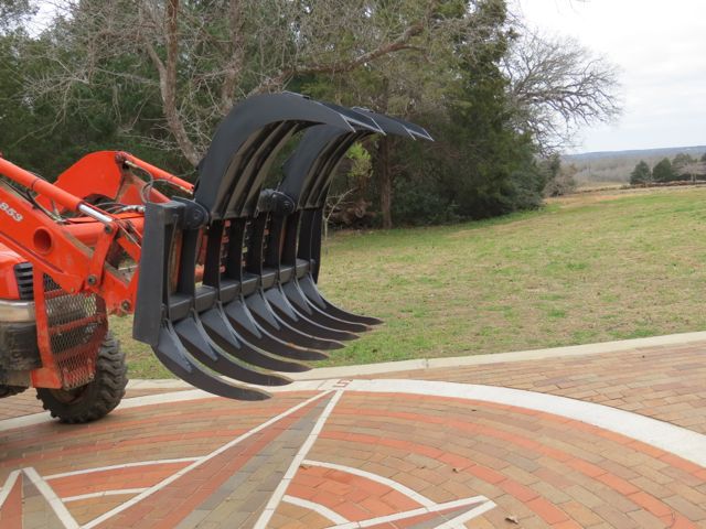

I just bought a root bucket with a grapple and need to plump it in with a control, I have searched through the post and have not found anything about front hydros, Has anybody done this ? .. Thanks for any info
/ Plump in Grapple on 5030 #2
Well either you have to add a 3rd function valve or if you have rear hydraulic remotes you can run it off one of those and run hoses to the front of the tractor and do it that way.
/ Plump in Grapple on 5030 #3
k4330, I just connected two long hoses one of the rear remotes.

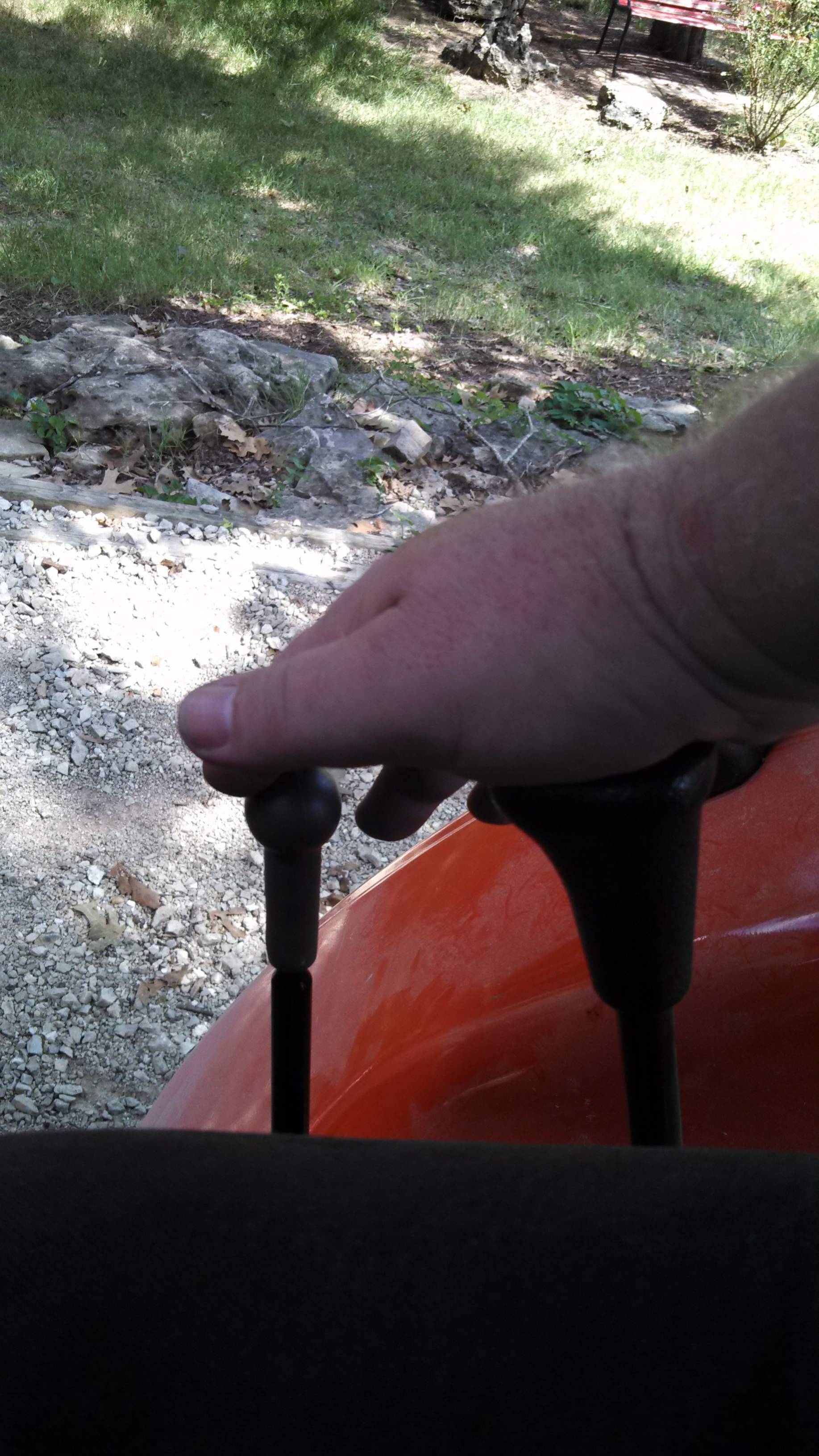

On my particular tractor the rear remote valve control is so convenient to access (especially after I lengthened it) that I lose no time in reaching it from the loader joystick control. If I had to reach several inches to a side lever, I would rethink my choice. I contend I can operate my control nearly as fast as a divertor or 3rd function button setup, or at least fast enough to not make a difference. But each application will be different.
