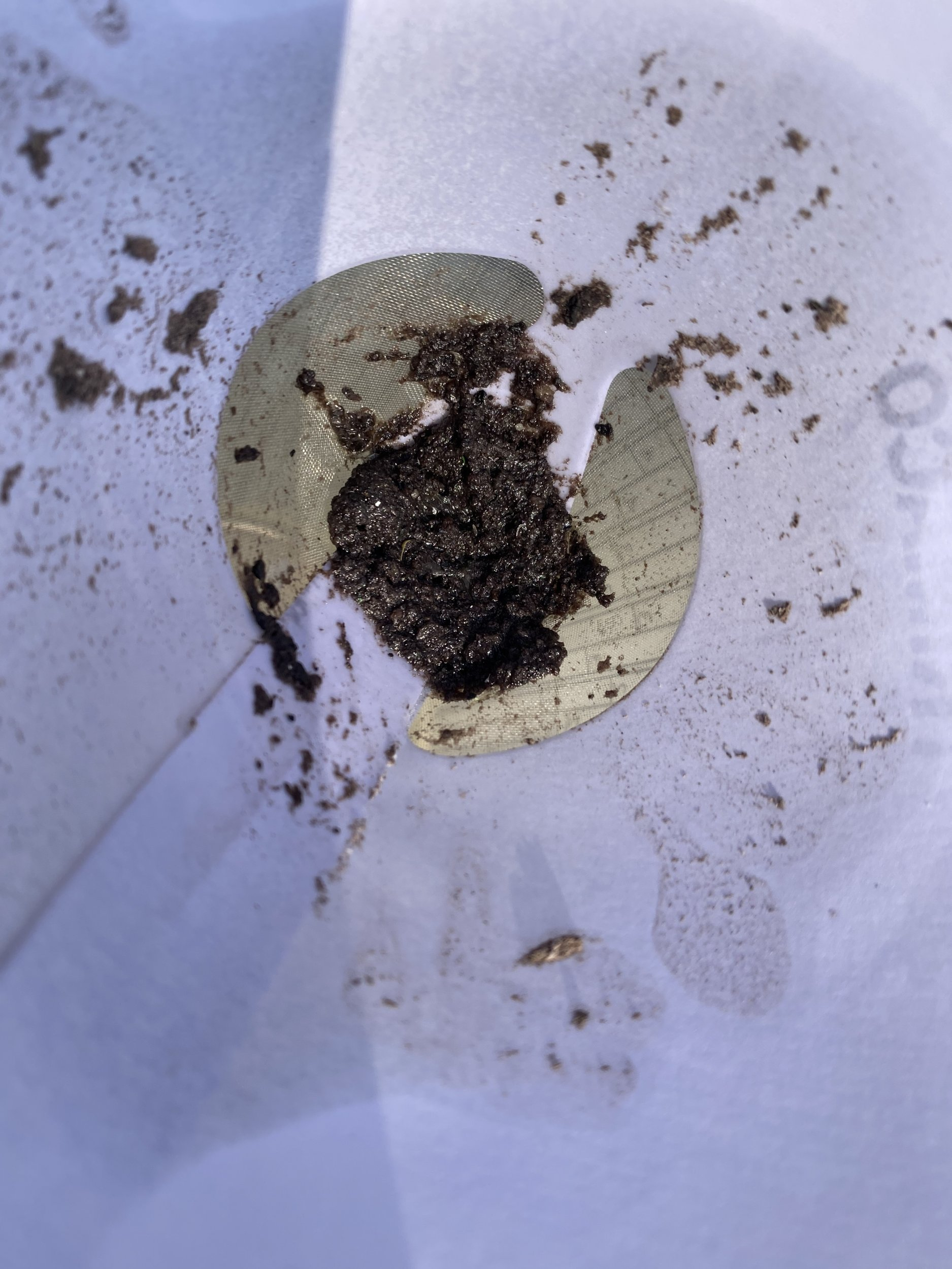

I have a 2014 jd 5055E with 321 hours. I am having a continuous problem with the intake screen plugging up and then starving the pump for oil. This results in jerky loader, power steering and 3 point hitch operation. My dealer said to clean the screen and reinstall the oil. This provides an immediate resolution that lasts for 25-30 hours then it recurs. I have changed the oil and filters as well. The screen seems to be plugged with grey gunk. I’m at wits end as the source of this material. The dealer says that they have never seen it before. I have saved the gunk and will bring it to them to look at but I’m hoping to find out if others have had this issue in case they try to blow smoke up my back side.

When I hear gray gunk my first thought is water contamination.
I'd drain it, dump in some diesel 10-15 gallons, then rock the tractor back and forth to slosh it around drain,
clean all screens replace all filters and if it has it any bottom magnets,refill with cheap hydraulic/transmission fluid,
run for 10-15 minutes just exercising the hydraulics, drain clean screens replace filters, then refill with with quality
fluids and filters.

It’s not gelatinous, it has a firm texture when dry, here is a photo from the strainer that I ran it through.

Could it be from the power reverser clutches?
/ Plugged hydraulic intake screen jd5055e #5
Magnet test, on the debris? May give you some direction?

magnet test is a good idea. looks like a bunch of dirt and dust to me. check your shifter boots and filler opening

I'd be tempted to send a sample off to a lab for analysis....but don't have any idea what lab or even what kind of lab. Maybe someone here knows.
But it sure looks like something is breaking up. A magnet to start, and then a microscope might tell you something.
Have you got a used power reverser clutch plate that you could look at? And some wet brake plates too if yours has that.
They are wet brakes. I’m going to give the sample to Deere to see what they think.

That's good. Everything you've said so far seems to point toward some component in the transmission is breaking up and particles being trapped by the filter.
From your picture and description I would suspect either the shifting clutches or the wet brakes - both of which can't help but shed particles when they work, though we don't know how much is normal.
With wet brakes, driving with the parking brake on is said to cause this to happen. I don't know if I've ever seen that, but it does make sense. On our JD a loud alarm goes off if I even start to engage a gear when the parking brake is on. On the Kubota it is perfectly possible to overpower the parking brake and drive away.
If it were mine, I'd want a second opinion from a formal automotive lab in addition to the dealer.

#20
Update. I took the sample to my Deere dealership and they agree that it looks like either brake of clutch material. They are giving it to a service rep from Deere for analysis. The service manager agrees that it is unusual for this to occur in a machine with only 310 hours. Im hoping that Deere will cover the repair even if the tractor is 7 years old. There is a history of trouble with the hydraulic system going back to the first two years when it was under warrantee. We will see what they say.
