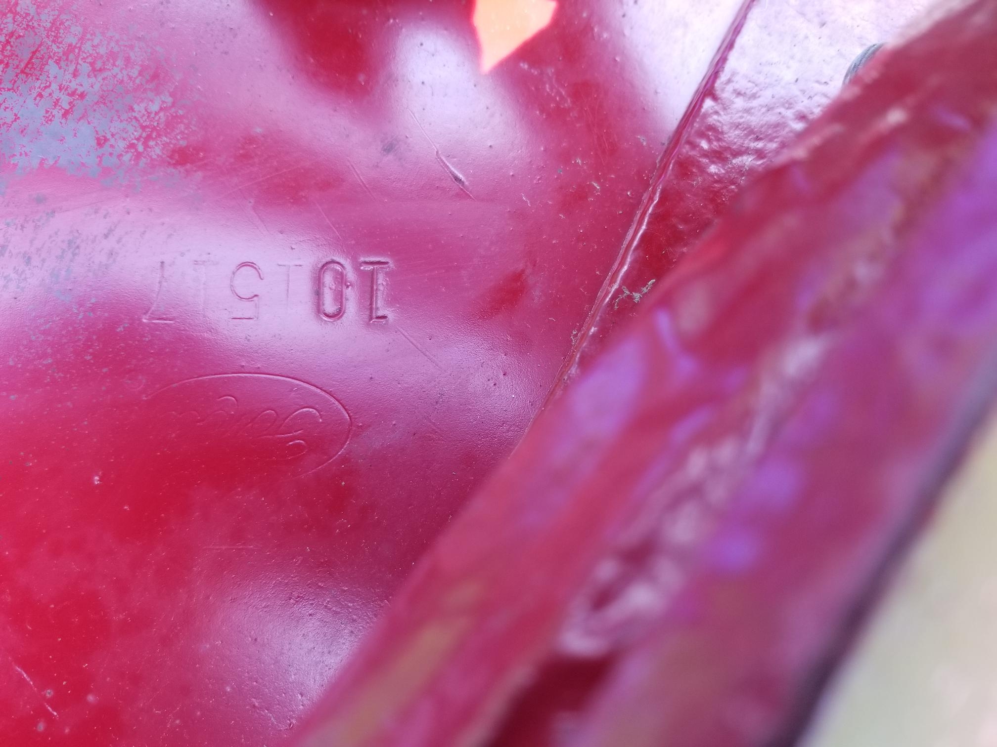

I have a 2-12" bottom plow. 14" tires. MF451, 52HP, 2WD. Attached are pics. Inside of right tire to center of tractor is close to 23".

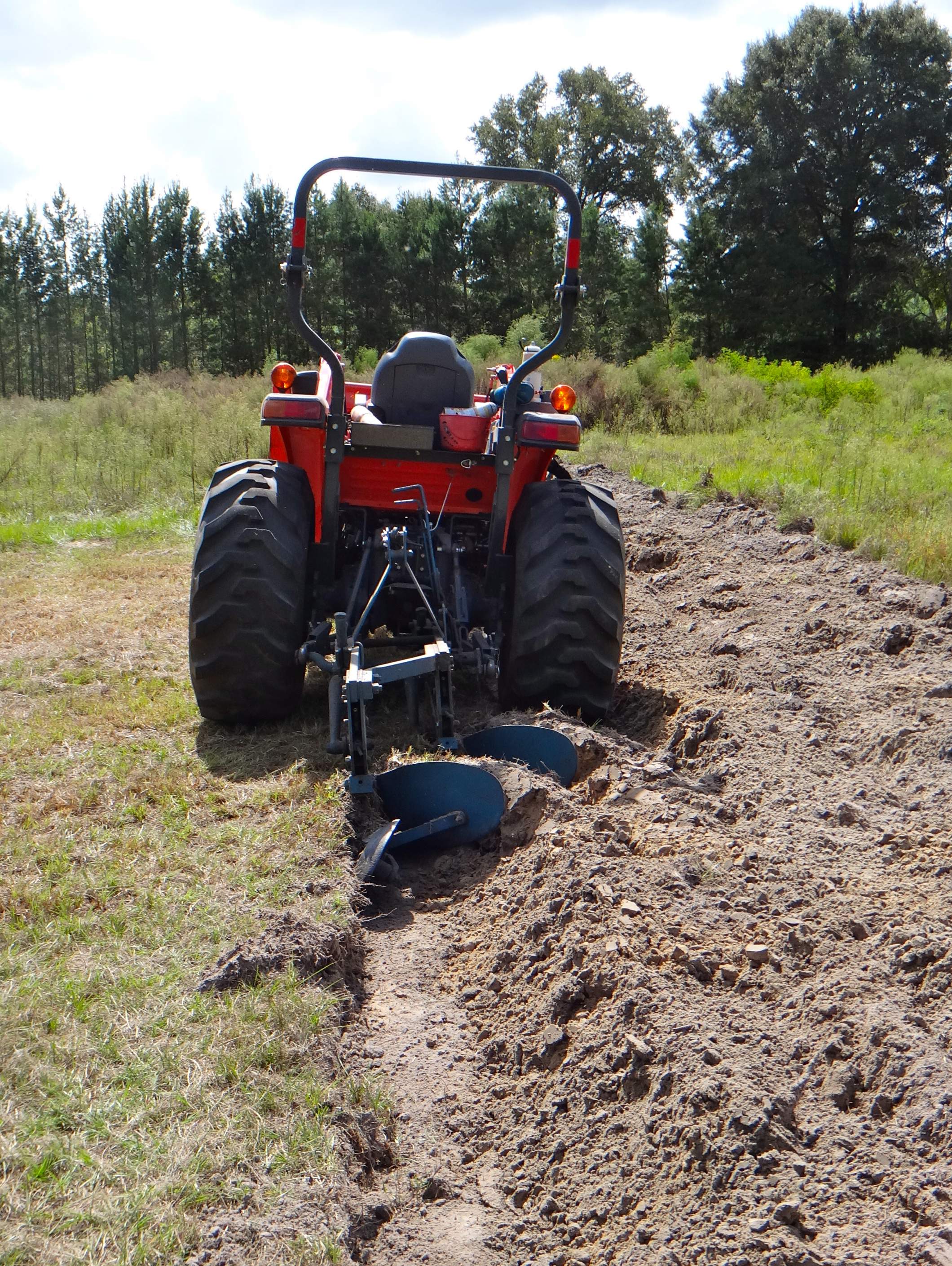

Your right side tires, front and back, have to move freely through the last plow furrow created. If your plow is 12" wide, producing a 12" wide furrow, but your rear tires are 15"+ wide, forget a consistent result.
(I speculate this is your problem.)
If your plow is 14" wide, producing a 14" wide furrow, but your rear tires are 15" wide, the weight of the ballasted right rear tire usually will pack moist furrow soil sufficiently so the plow can operate as designed.
A 16" wide plow will allow the rear tires of any COMPACT tractor, including your MF 451, to move freely through the last furrow created.
INFORM US OF THE WIDTH OF YOUR PLOW AND THE WIDTH OF RIGHT REAR TIRE.

I have 14" tires and 12" plows (2-bottom). Inside right tire is close to 23" to center of tractor. Is there anyway to make this work. The furrows are never really defined when I plow.
A two bottom 12" plow is covering 24 inchs of width when plowing.
The flat side of your dead furrow should be inline with the center of your tractor.
She will be pulling to the right a bit while plowing.
The plow furrows are more defined the slower you plow.
I grew up plowing miserable stony soil, we always plowed in first or second gear with trip plows.
You could see every furrow as you looked down a field and every error showed up like a sore thumb.
That was pulling 4-14's with the Farmall 400, then 4-16's with the IH 560 and then 5-18's with a Ford 8000, that had spring auto resets very nice.
Slower travel speeds resulted in much more work being done easier then trying to go faster and breaking things,
the old slower is faster.
