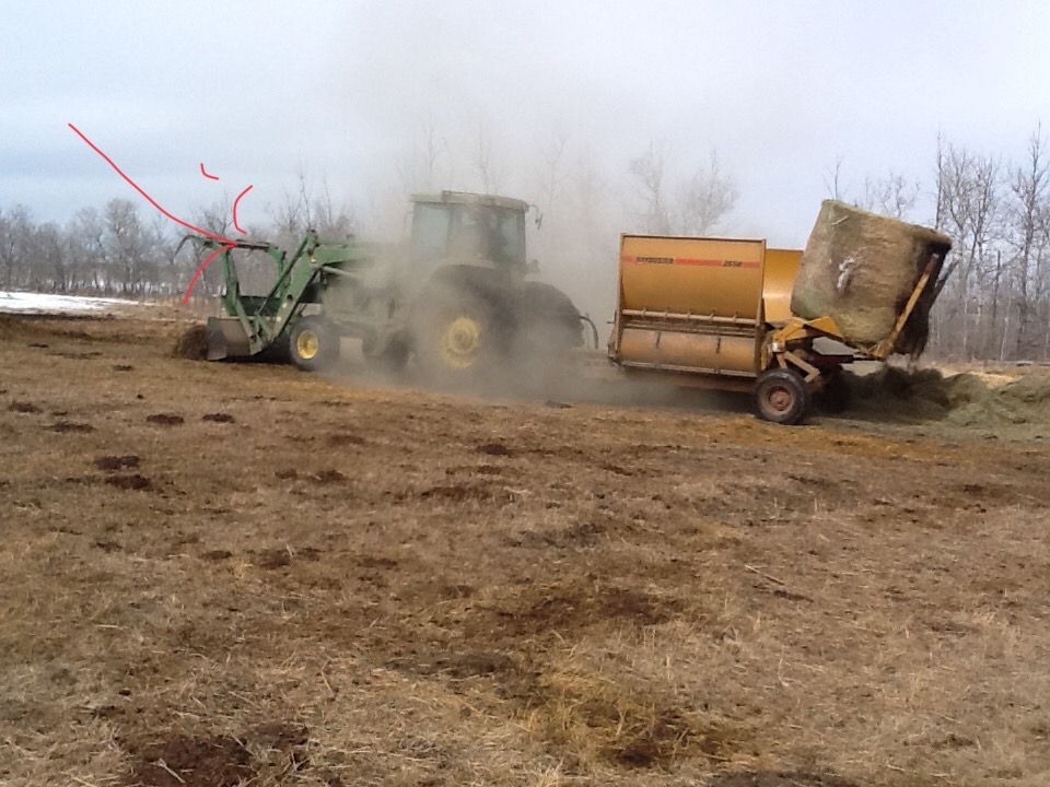

Back in the 70's the tractor for me was an IH 100hp 2wh
with front end loader. To get feed fot the milk cows a chopper
and a hay feeder chopper filled the hay feeder when full towed
back to the barn yard this was down twice a day the feeder was approx 30 or 40 ft long. As for plowing 4 bottom plow bigger tractor worked
18 hours non stop then his regular driver came back
